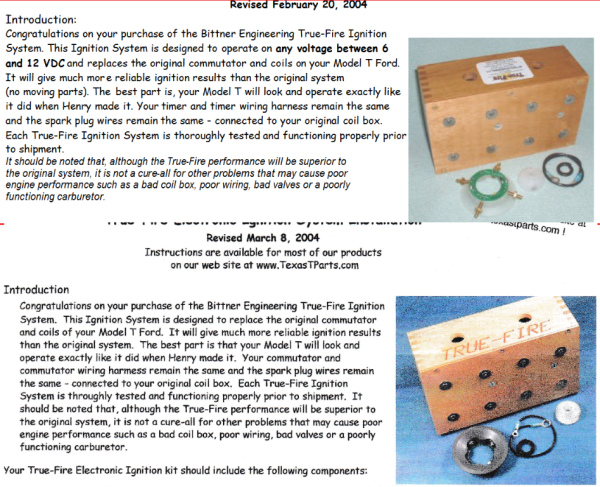

We are dealing with an estate T that has a Sure Fire ignition. The literature I have says 12 volt only, but owner says NO, 6 VOLT!!
Did they ever come for 6 volt??
Thanks for any information one way or another.

Thought about it long ago & so I copied the instructions
Congratulations on your purchase of the Bittner Engineering True-Fire Ignition
System. This Ignition System is designed to operate on any voltage between 6
and 12 VDC and replaces the original commutator and coils on your Model T Ford

True-Fire March 2004.pdf
(3.49 MiB) Downloaded 76 times
Yes TRUE-FIRE, my error!!
I have a version of the instructions (that maybe from a later manufactuerd dated "Revised March, 2004." indication 12 volt only. (See attached) The extra unit has a"IGBT 60-12 V" on the bootom, I'll have to go to actual T and see what's there (if anything) fingers crossed.
Thanks for all the imput.

The revision dates on the two instructions are just 1 Month apart and the commutator parts are different. It is possible that the electronic components initially used were no longer available - hence the changes. Regardless of what model? you will need the small puck like piece (clear or white) for the commutator. A member made a few last year I believe
