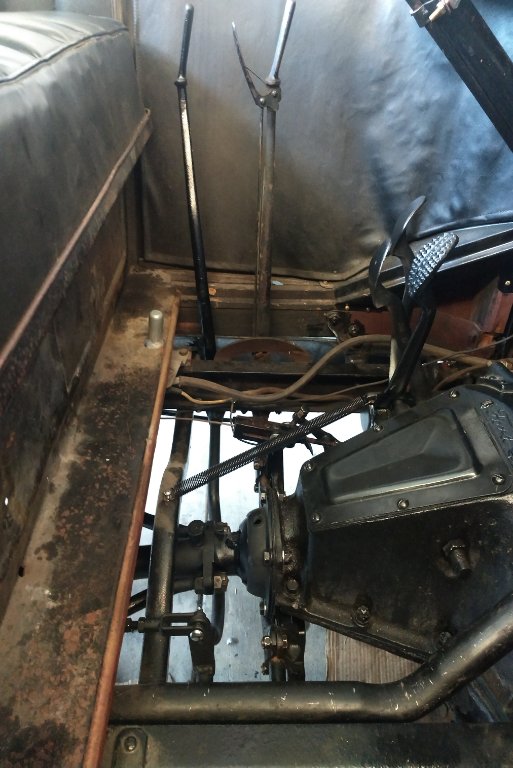

I agree, a stick in the middle of the floorboards wouldnt be my bag. I went with a rux & left shifter.
Does the left shifter fit in the same slot as the hand brake lever, or does it require adapting the floorboard and mat?
- Posts: 5268
Re: Adding a Warford vs Ruckstell to a 1914 Touring
My normal setup adds another parking brake lever unit behind the existing one. Does require extending the opening back an inch or so.Steve Jelf wrote: ↑Thu May 18, 2023 11:51 amI agree, a stick in the middle of the floorboards wouldnt be my bag. I went with a rux & left shifter.
On my 14, I didnt want to drill extra frame holes, so I built a U channel adapter to pick up the existing parking brake mount. This put the shift lever directly to the left of the original parking brake lever. The floor slot was widened. Up side : no extra holes. Down side: narrowing of drivers foot room.
