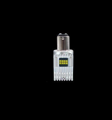

and now lately this one, that is selfcontained with optics and all:
I've tried it in two different vehicles. In both the high bean worked flawlessly, but the dim did not work or worked "spooky". The latter that I'm trying now the one of the two bulbs light up very dim. when I take the bulb the light out, the other one starts lighting up still dim.

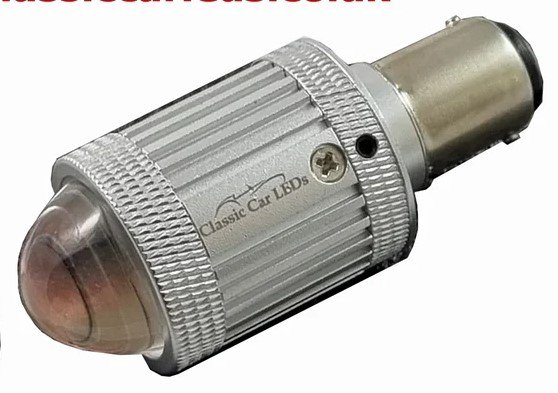

I use the bottom style, which I purchased from Snyders. Great lights! I have not experienced dimness in one bulb over the other, but I do get flickering intermittently from the passenger side bulb. My car has new wiring and new headlight reflectors. No flickering with the old style bulbs. I'm starting to think that the reflector is vibrating or the headlight is letting the bulb wiggle and thus causing flickering due to changing reflection focus. The light never truly cuts out completely. I suppose I should swap the bulbs around in the headlights and see if the issue follows the bulb.

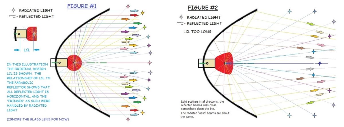

The issue with led bulbs is that do not disperse the light from the reflectors focal point hence the lens looks brighter when you look at but the light projected from the headlight lens isn't as good as it can be & is less focused. But still looks better than traditional if a high temperature bulb is used 6000k
This diagram shows how the light gets dispersed to the lens. It is the lens (the fluted style lens of the Model T) that focuses that light ahead onto the road. Again t just not as efficient as it can be

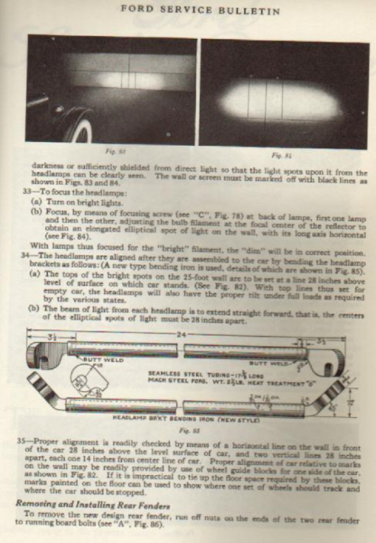

The expected light pattern from traditional style bulbs
