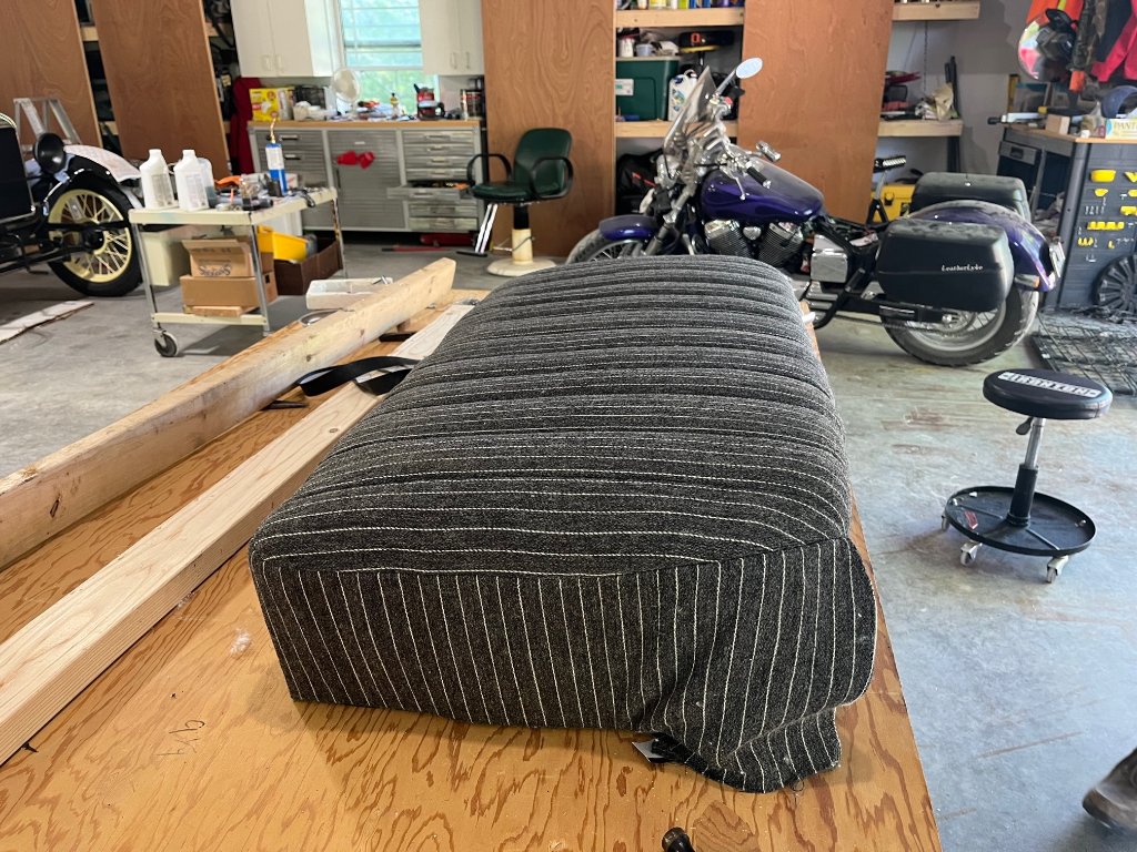

Re: Seat spring crimping, pliers, not hog ring pliers
Today, we worked on installing the cushion onto the seat spring for my 1927 coupe. We used a compression table. Here are photos. We still have to finish the corners.
