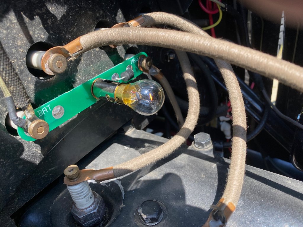

The magneto battery charger does not interfere with operating the coils from the magneto. For non-generator cars John Regan makes a neat little circuit board that spans the mag and battery posts. Otherwise everything functions normally.

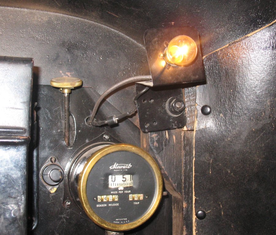

I forget what bulb John Regan uses but at idle it is so dim you have to look hard to see if the filament is glowing. It never seems to reach full brightness when I play with the throttle. I have checked my magneto output with a "St. Louis Electrical Works" Mag checker and it's output is normal. In the unlikely event the diode should fail closed, the light bulb will quickly burn out, protecting the magneto.
Note: You want to be very careful to route the spark plug wires such that there is no chance of a spark jumping to the charger circuit. John is very careful to warn people about that. The photo shows how I routed my wires. It also shows how dim the filament is at idle.

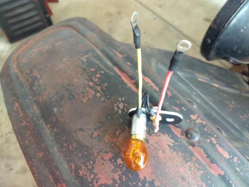

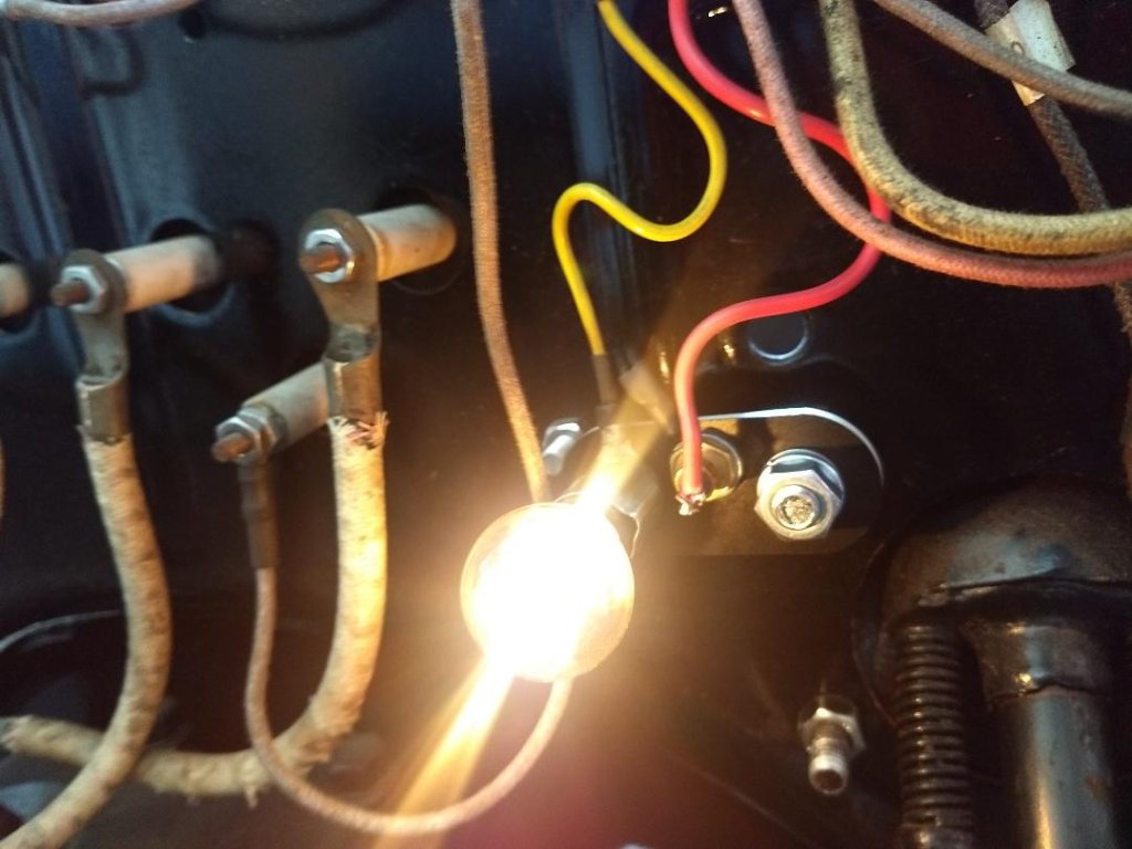

I'm looking for some advice here. I had to pull my engine/trans. to replace the clutch. I didn't know it at the time, but the clutch I put in the car when I built it a few years ago was a bad one. Anyway, I got that done and finally got the car started today. It won't run on the mag. I have a Regan mag/battery charger as is pictured above. Its bulb burns out immediately. Tim Juhl mentioned above that if the diode is bad it could cause that. How do I check it?
