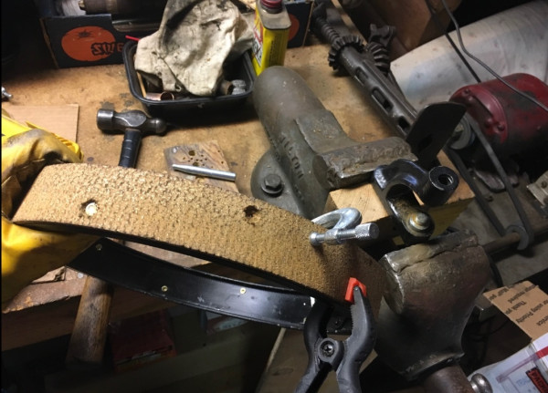

I used the tool set that Langs sells. It includes a countersink bit.
https://www.modeltford.com/item/2566RVTL.aspx
The product description includes advice about clamping and chamfering the ends of the lining that I followed.
I relined the brakes a couple of years ago and found this photo showing the countersunk hole I had made with the bit from the kit.
