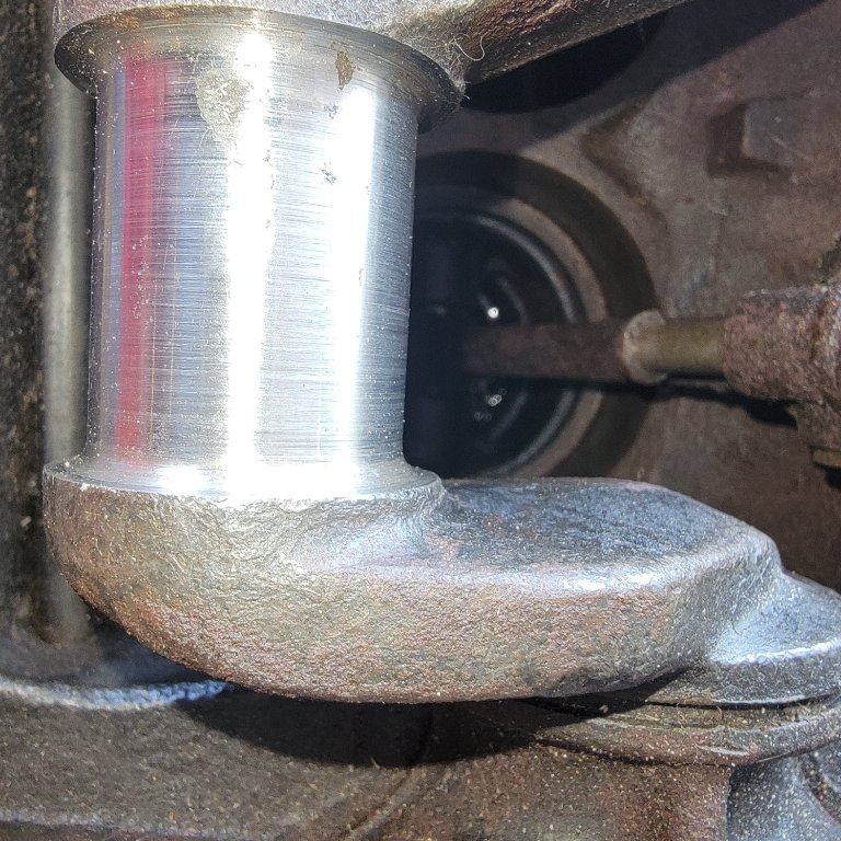

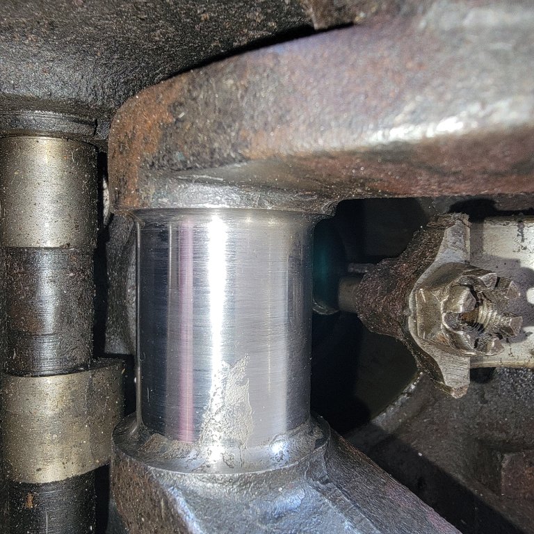

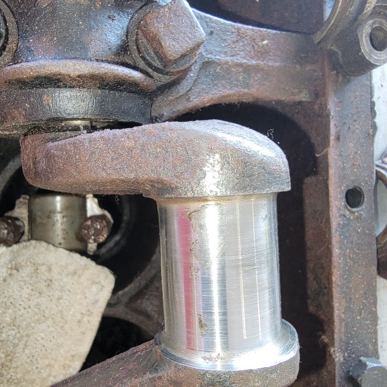

Checking a 17 engine and I found wear in the piston arm babbitts at the edges. Enough that I think I should replace them. The three pictures are the crank under those arms. You will see some wear.
My question is: I want to buy piston arms that are already babbited from a shop and install those and new pistons/rings and go on my merry way.
because of the crank in the pictures should I take the whole thing apart and get the crank machined and then all new babbitts for the block and piston arm? Trying to save some money, but would it be an issue down the road?
Scott
Scott

I see a rusty, dirty engine which has been left open for some time. There are a million bits of advice to offer, but no good place to start, sitting at a computer, so I won't offer any other than this:
1. Team up with a competent Model T mechanic or knowledgeable hobbyist (there is at least 1 other in Cheyenne) and discuss exactly WHAT you want to accomplish. There are not many differences between saving an as-is engine and all but destroying it.
2. Purchase a Model T manual (T-1) at any of the hobby's suppliers and acquaint yourself with procedures and correct nomenclature so that you and a future mechanic will be on the same page.
Good Luck.

That is a tough one. Several marginal characteristics. The crank journal is a bit rough, and appears "acid etched". However, I have seen worse clean up really nice!
The important thing is how round is the journal, and is it straight (not tapered).
Model T crankshafts are too small to begin with. Age hasn't helped them. And turning the journals smaller makes them weaker fast!
Myself? If the crankshaft is reasonably decent? I prefer to clean up the journals with good emery tape (fairly fine to very fine). Doing so requires constant measuring and monitoring to keep it very round and very straight! But it removes the least material and extends the lifetime of a part getting difficult to find good ones. Then I hand fit the Babbitt bearings using bearing scrapers and bluing compound.
The crankshaft should be checked for cracks. I have "issues" with most people magnafluxing crankshafts as they tend to trash too many based upon faulty readings (electromagnetic fields are tricky on odd shapes like crankshafts). It takes someone that really knows how to read them to get it right.
It is also very important to make certain the connection rod is straight and runs up the center of the bore properly.
All things considered, you really should think about taking the engine apart and doing it properly.
Measuring the journals and cleaning them up with emery tape, then carefully fitting the new or replacement connecting rods to them can be done "in the car". Doing so could give you many years and many miles of enjoyment! Or not?

That crankpin looks "flat" to me. The crankshaft appears to be heavily rusted, or else to have been welded on.
I would want to check everything about that engine using a micrometer. The crankshaft, if it isn't worn or abused beyond use, ought to be magnafluxed.
Your engine may be repairable on a budget, but if you neglect major issues to save money, you can expect to waste any time and money you do spend, and perhaps put a repairable engine beyond any practical repair.
The rest of the car's mechanical parts need to be checked over, too.
Mechanical things have certain requirements that must be met for them to perform dependabley.
If those requirements are neglected, for any reason, trouble is sure to follow.

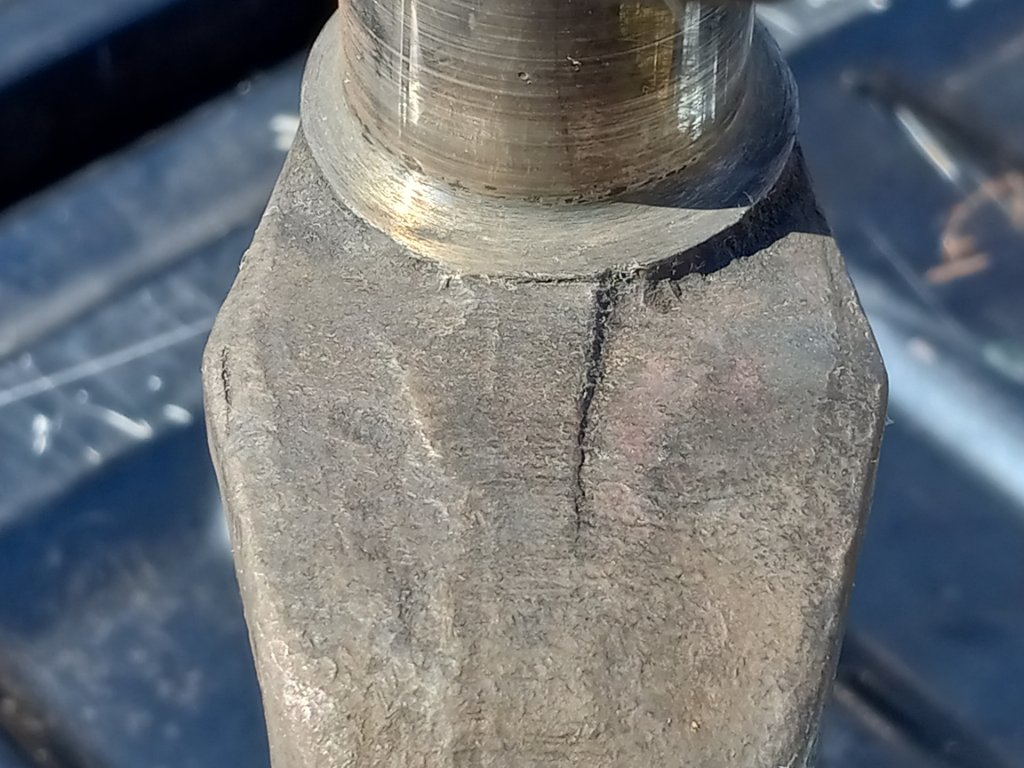

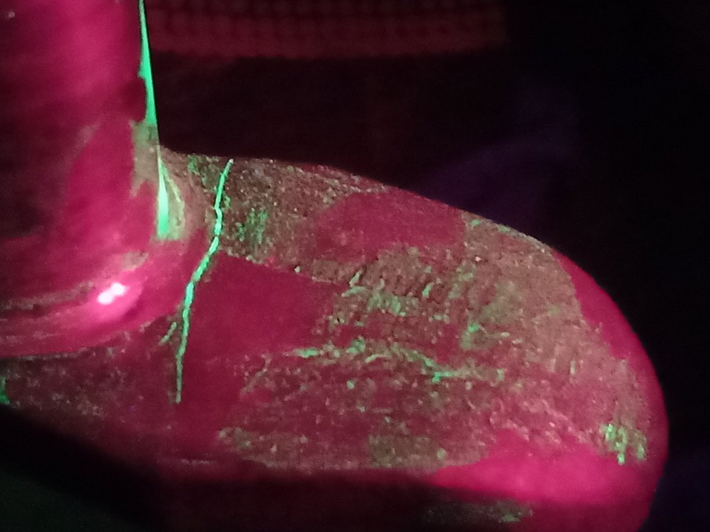

Magnafluxing T cranks is a must and the cost is insignificant as compared to the cost of an engine rebuild. Also, crank ringing method is not a good test of whether or not a crank is broken. Here some pics to consider:
In Pic # can you spot the issue?
Here's a Pic of the same crank after magnafluxing, can you see the issue now?

That’s an excellent example of a hard to find crack, Mark. If available, wet magnaflux is definitely the way to go. Cheap insurance.
