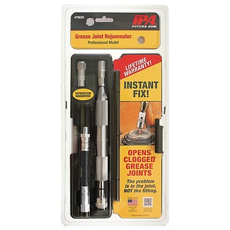

I have used this tool with great success on stubborn blocked fittings refusing to take grease.
It forces light oil or a solvent into the grease fitting, unblocking it.
