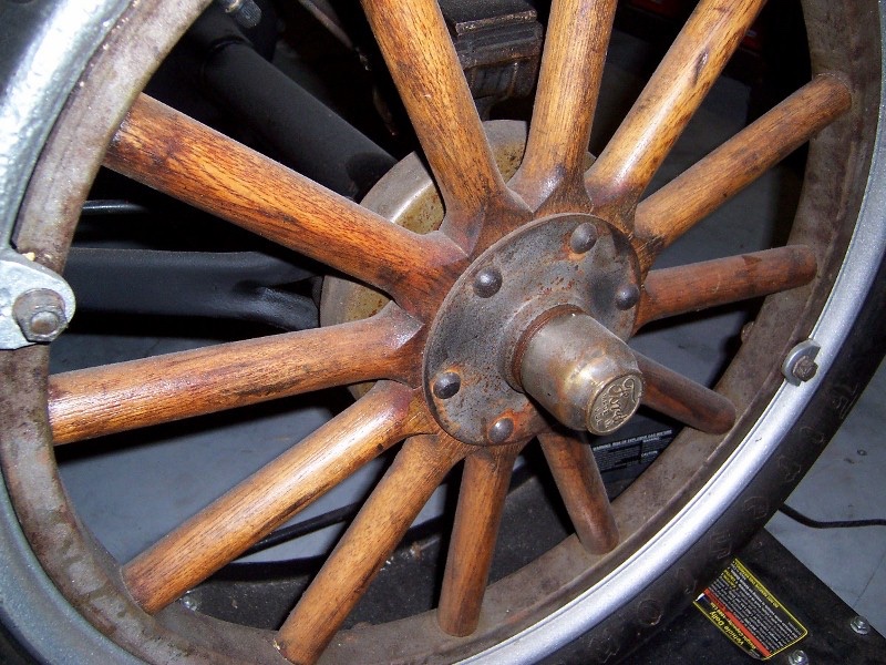

3 of the 4 bolts protrude past the need of the nuts about an 1/8 of an inch. Is this ok or should they be flush?
- Posts: 5158
Re: 25 Model T Rear wheel hub
So 1 demountable bolt is shorter than the others.
Easy enough to measure to confirm.
As long as the nut is full, there is no strength issue.
Check the head side & insure the square shank is set in the square hole.

As long as they do not interfere with the brakes, you are fine. Just grind them down a touch, run thru a die, and peen them in place.
- Posts: 4048
Demountable rim bolts may vary in length a tad.
But be sure the odd one is a correct bolt, two sides of that carriage head rim bolt are flat to prevent turning.
