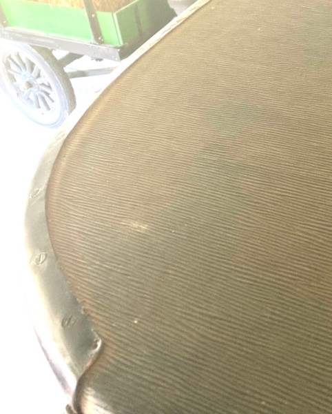

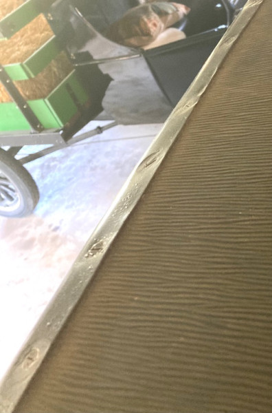

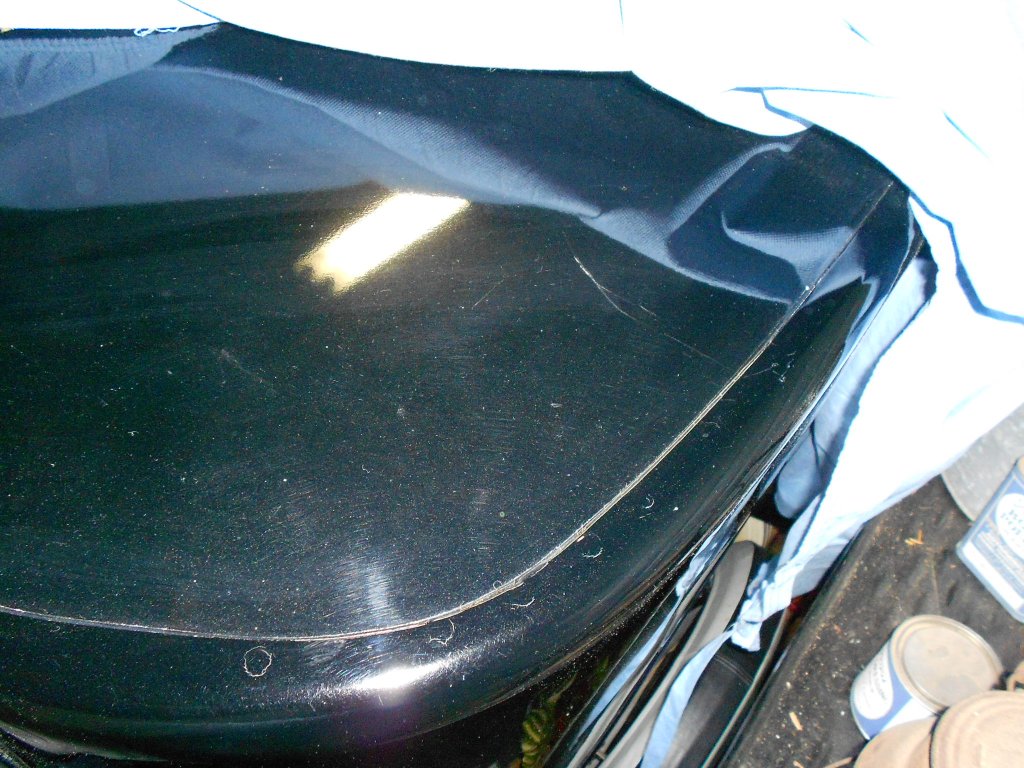

B above…..The curved rear panel covers the vinyl roof material then is nailed to the wood frame. Here are pictures of my ‘19 centerdoor. As I’m a Doctor of Breast Augmentation, I brought home a tube of silicone to apply under the curved panel before nailing….

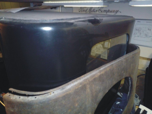

However, I found the photo I was referring to (on the computer, not my phone). It shows half-round on the centerdoor back panel (bottom panel in the image) and a comparison to a regular sedan. and how its metal is attached to the roof.
Did Centerdoors have half round to keep the elements at bay where the roof seams met or were they like George posted above in his post and all roof material just shoved under the metal lip and given a "Best of Luck to ya?"

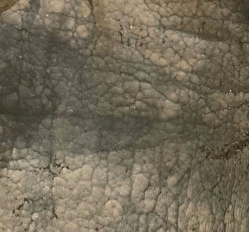

Les ?… really ?…im positive I’m the second owner of my centerdoor. And I’m positive I restored it and I’m positive I removed remains of ‘long grain vinyl’ in the enclosed picture and replaced it with new as in previous pics this thread. However, I didn’t use the ‘sealer’ you mentioned. I used silicone under the curved sheet metal instead.
