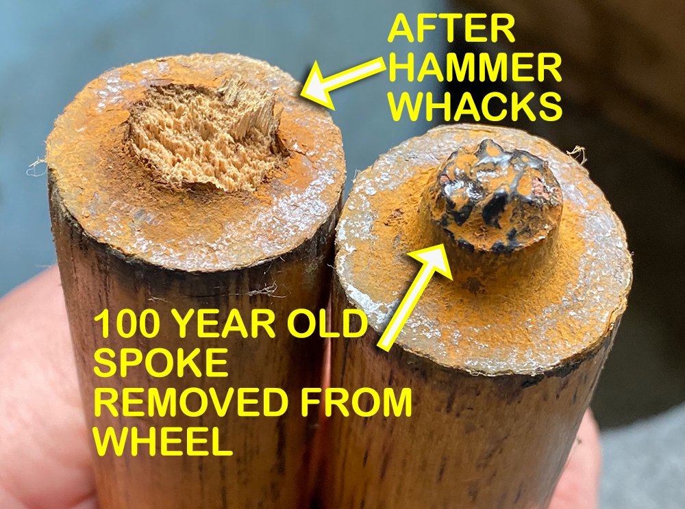

Time to re-spoke. If you have demountables you should remove the rim and look at the felloes. Your tenons need to fill the hole and be tight. Often the end of the tenon is eroded by years of moisture and stress. You don't want the wheel to come apart at the least opportune time.....
I had some spokes loose like you described. I gave one a couple of solid whacks with a rubber mallet and the tenon sheared right off. It didn't take much as there was only a nub remaining. This is what the tenons should look like. I brush spar varnish on mine to seal the wood against moisture.

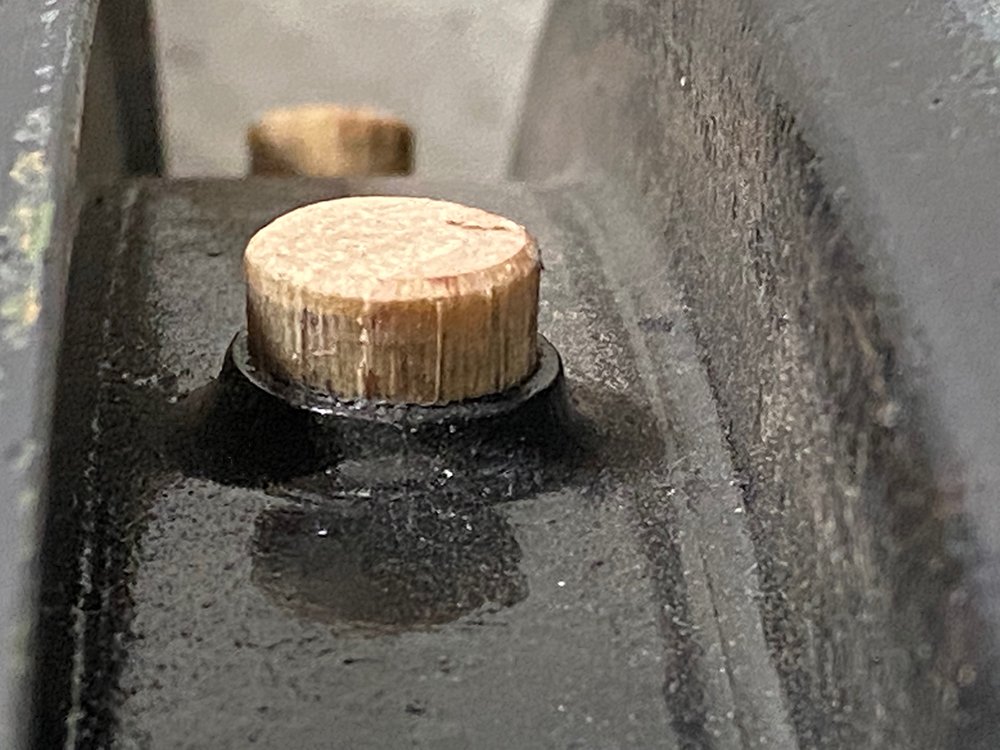

How many bad tenons you talking about ? My wife's old '25 Coupe had a couple punky ones on a couple wheels - I drilled out the soft wood down about an inch & a half & drove ribbed joinery pegs down in tight with wood glue - she drove it that way for near 20 years. I wouldn't recommend doing that on ever tenon but a couple, your call.
