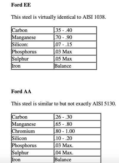

According to Bruce's research (C-D Encyl) the material was changed away for the famous Vanadium steels, to chrome steels, and then the high carbon steel.

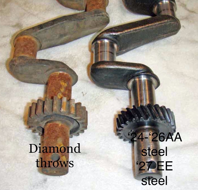

CRANKSHAFT
The evolution of the crankshaft is still an open question but the common belief is that from 1909 until about 1924 the crankshafts were made of Vanadium steel. These seemed to have the diamond-shaped throws between the connecting rod bearings.
About 1924 the material was changed to a heat- treated type and the throws became more rectangular in shape. These were imprinted with “AA” on one of the throws.
In 1927 the material was again changed and was identified by an “EE” on the throws. This final type is believed to the best of the cranks.
Chart was in an earlier forum post on cranks.

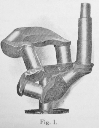

Famous picture from early Ford adv. showing Vanadium shaft bend around and not breaking! Marketing at its best!
