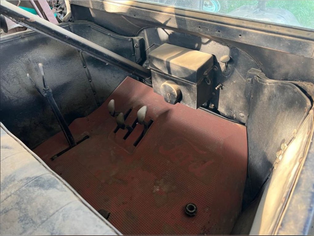

I was surfing the internet and came across a 1916 Ford for sale. It has a red front floor mat. I have never seen one of these before. I have only heard of black ones or white ones. If this is not an original Ford issued mat I might wonder if it is an old reproduction, or a white one that turned red like the white tires that turned brown.

I see it has Ford script. Never saw one like it 🤔

The wood around the pedals is the same red color and the red mat has bleached to near tan in places. I have my doubts that it was made red and am more inclined to believe that someone mopped on a dye of some sort.

Not original.
Dimensions are incorrect just like a reproduction - original mats aren't that wide and don't go "wall to wall"
No notch below the steering column for bulb horn tube/electric horn wire
No notch on right hand side for speedo cable

Long ago there was a guy who sold T floor mats in black, red and green. I think his name was M H Martin, he advertised in the early issues of the Vintage Ford.

A genuine Ford mat will say Made in USA down in the corner of the script.

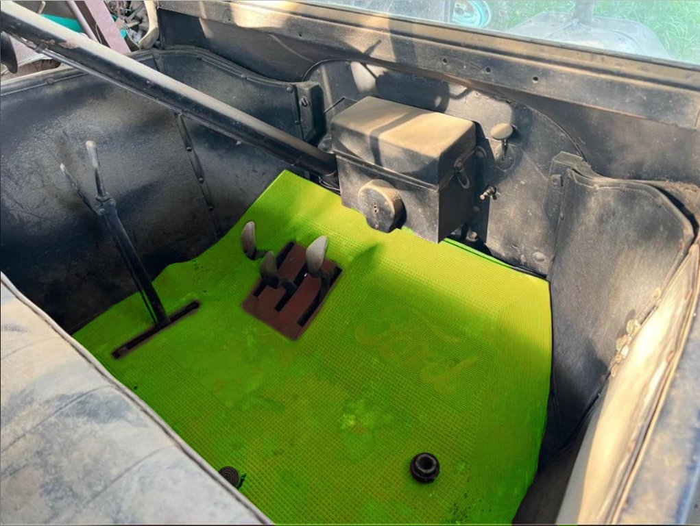

I hadn't seen that before. How about a nice chartreuse?

I notice that both the red mat and green mat have a round metal object on the right side of the flat area. What is it?

The round thing looks like a wheel bearing.

…or a roll of electrical tape ?

Kim is right Martin also made Model N, R, & S floor mats in the same color choices. My N has one of his black mats.

I looked at the pictures again and the shadows are the same on both pictures. I think it is the same car with some trick adjustment to change the color of the floormat.
