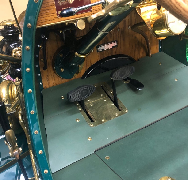

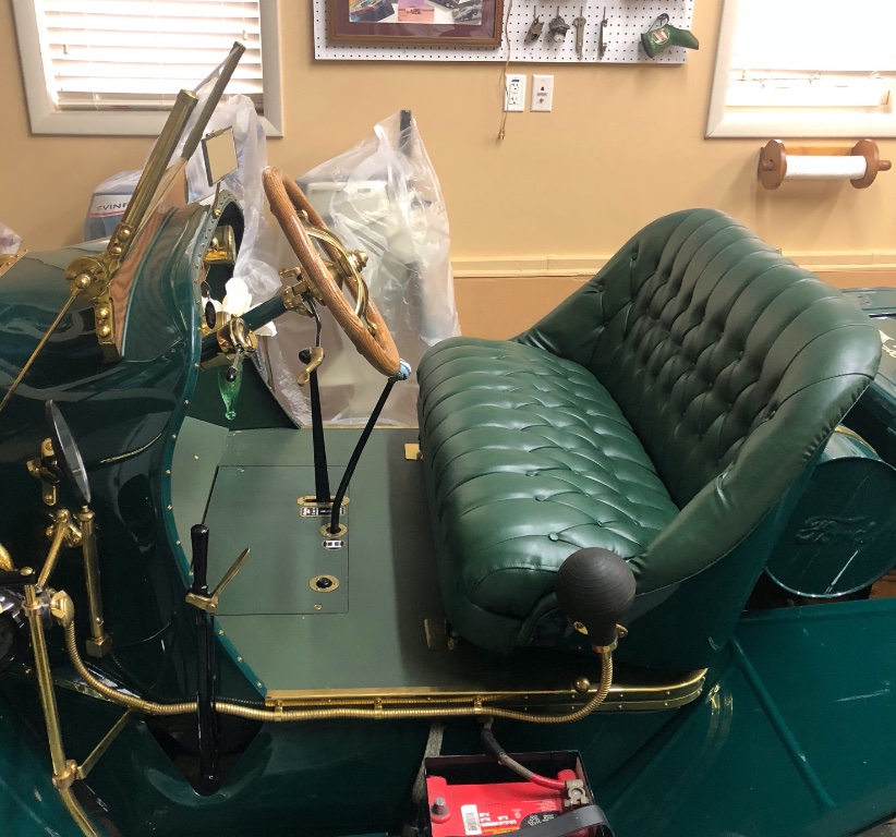

My BIL has Warford & Ruckstell with a 10 tooth pinion never uses low peddle starts in Ruckstell/Warford low using the clutch. Look @ Hank Lee's
Gentalmans speedster ad that has a chevy trans with only a clutch & brake in the T trans. Two peddles ( no need for revearse drum )I have a
Model A trans adaptor with a Model T drive shaft adaptor that I will use the same way. ( the T brake will work like a trans brake like in a big rig )

!937-39 Chevy transmission with reverse works awesome! Built a few over the years but retired from it now.

Hank
your skills are visible from across the room
your craftsmanship is only visible up close
folks, if you want to know how much care goes into his creations, just look and see that every screw is oriented with slots vertical
there are a lot of excellent welders...and Hank is one of them
there are a lot of folks who are stylistically creative...and Hank is one of them
but there's damn few that go to the point of aligning screw heads...this is Duesenberg-level care.
Every time I see a photo of that car, I'm amazed with new things...KUDOS Hank!
