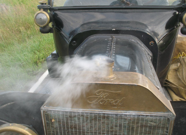

I took the 23 touring out to check it out before next week's Manhattan, Ks tour. After 15 miles and a long uphill pull it started to smell a little warm so I slowed down. I'd put a straight radiator cap on instead of my usual moto meter. After a few miles it was smelling hot so I pulled into our church to check and perhaps fill with water. The rear freeze plug was missing! I cooled the engine down over several minutes with a hose and plugged the hole with a rag to limp a bit over a mile home. The engine had stopped well but was somewhat hard to restart. The tightly rolled up piece of rag was gone. I quickly plugged the hole with a cork, filled it with water, and started it again, still somewhat slow to catch. The cork blew out. I checked compression and got 65lbs in #1 and #4 and 50 lbs in #2 and #3. Previous checks last year with a Z head had been near 75 in all 4. Why would a freeze plug blow out? Hopefully I didn't wreck anything else. I'll put a buffalo nickel plug in tonight and am contemplating pulling the head unless there are other suggestions for this shade tree mechanic.

the freeze plug may have fallen out but it didn't blow out...T cooling systems do not build pressure
what exactly do you expect to find by pulling the head?
