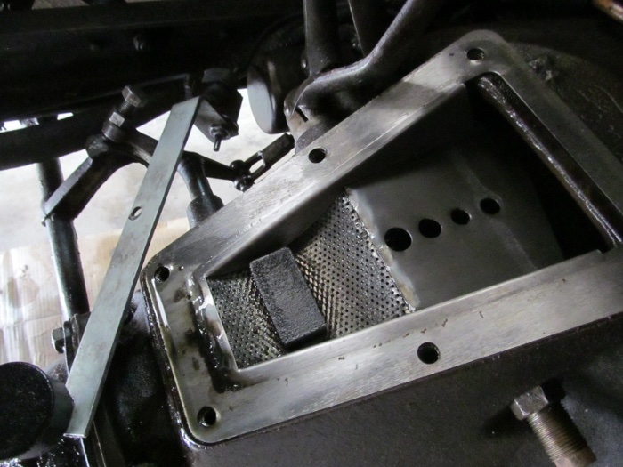

Many use the vendor supplied oil screen accessory that is sandwiched under the inspection cover. Collects stuff you can clean out each oil change. These screens typically come with a magnet too. Recent info gives some precautions to wire or secure that magnet so it can't get into the trans.
Or there is vendor supplied magnet oil plug for the crankcase too. Likely good idea for magnet esp. on a new engine with metal wear from rings setting and stuff. The oil screen is a nice thing to add.
Oil screen accessory and magnet.

The screen is also good for catching band lint and other large objects! ;) They are not a new thing. Even back in the day the Surefeed oiler had a screen and there were others that fit under the cover.

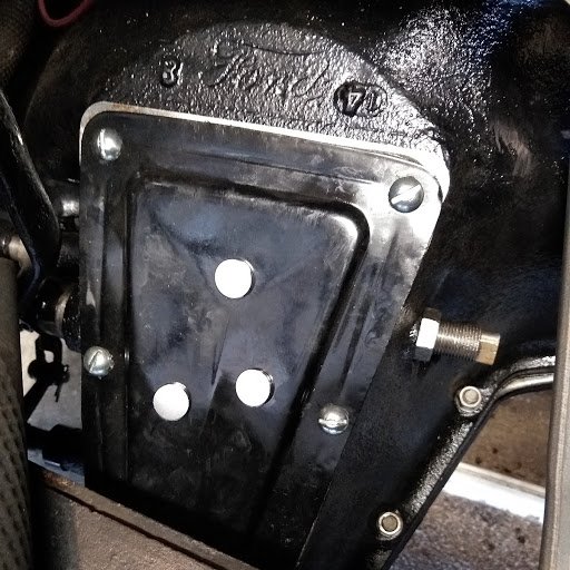

Tim's suggestion makes a lot of sense. Some people have had problems with the magnet sitting on the screen. You can go on ebay or amazon to purchase strong magnets that are small enough that they should fit on the newer cover that is not flat. I will have to try this next time I send an order to Amazon. The magnetism should go right through the cover. Thank you Bob for the suggestion.
Posts: 2967
Last Name: Hjortnaes
Location: Men Falls, WI
Re: Magnet for metal residue capture
Post by DHort » Mon May 20, 2019 5:00 pm
The first picture is a set of magnets I purchased at Home Depot. $3.98
The second picture shows how that are placed on the transmission cover.
In a few months I will take them off to see if they work as well as the magnet
already stuck to the filter. If these work, I will remove the magnet inside so I
do not have to worry about it getting pulled into the transmission. These three
magnets were very strong, and I had to pry them apart.
thanks again to bob for the suggestion.

If you take a magnet and put it on the top of a removed transmission inspection plate and then put a small nail on the other side I think you will find that the magnets field is dissipated through the cover and will not attract the nail. I have not had any luck using a magnet on the outside.
