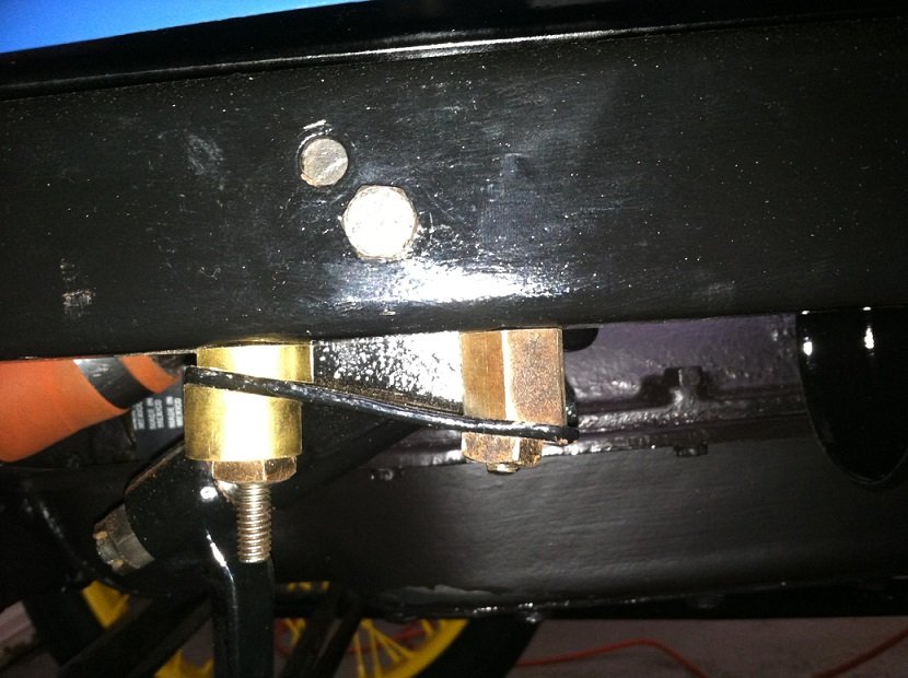

Thanks for the responses guys. Craig is correct; the original column bracket does interfere with the reverse pedal. My grandfather inverted the column to get the rake he wanted, also flipping the column bracket that attaches to the firewall. He fabricated an angle-iron bracket to secure the column that attaches to the firewall and the 2x6 side rails that mount to the top of the frame. For the lower column to frame bracket, he fitted metal wedge spacers to get the angle correct. He also cut the end of the reverse pedal off so that just the stem remained, which enable it to clear the bracket (see photos below). As far as converting the car to 12 volt; I could but didn't want to mess with something that works fine as is. I thought I'd simply add the 12v battery, switch, and starter as a separate circuit, if I can. The plan would be to use the starter on cold starts, then use the crank when it's warm through the rest of the day on a tour. Also, it's not that it won't start with the crank as it has since 1927. Just that I'm getting a little older and looking to the future, and figured I'd pull the trigger sooner rather than later.
This is the inverted column and the angle-iron bracket. Note the cut-off reverse pedal stem in the middle.
This shows the wedge spacers in the bracket that mounts to the frame.
