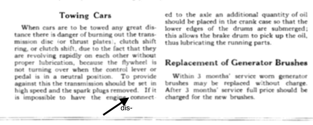

If you must resort to flat-towing a Model T, remove the sparkplugs and put the transmission in high gear.

Ford Service Bulletin.

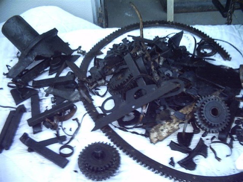

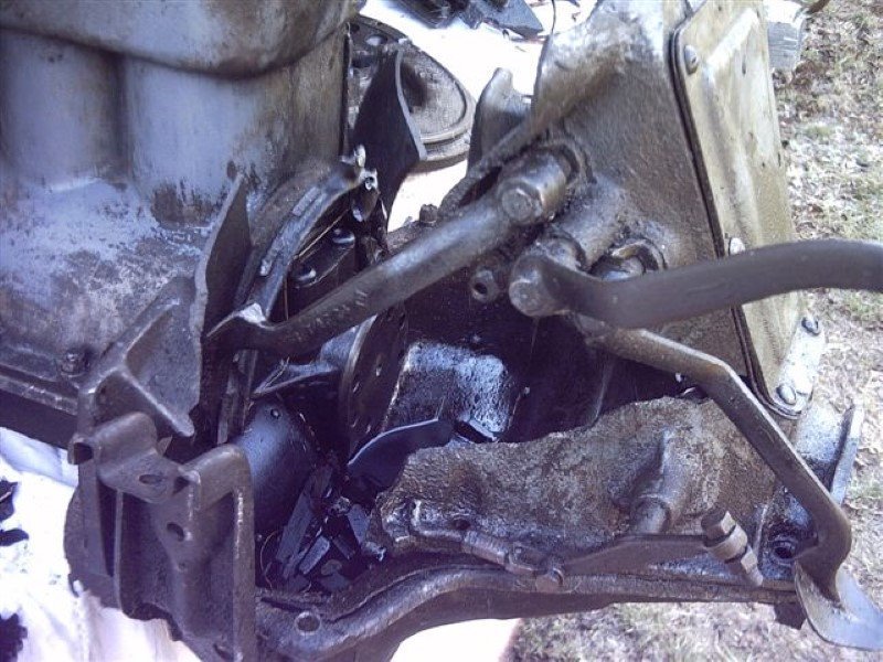

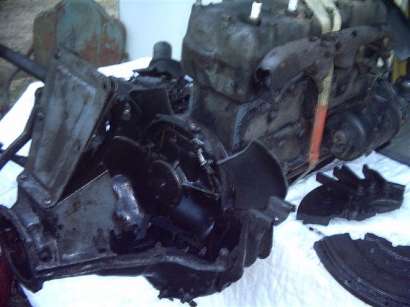

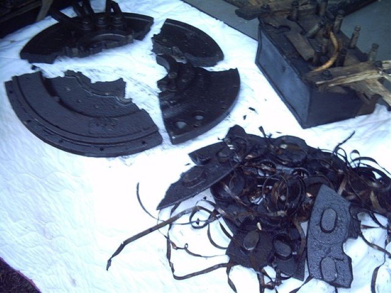

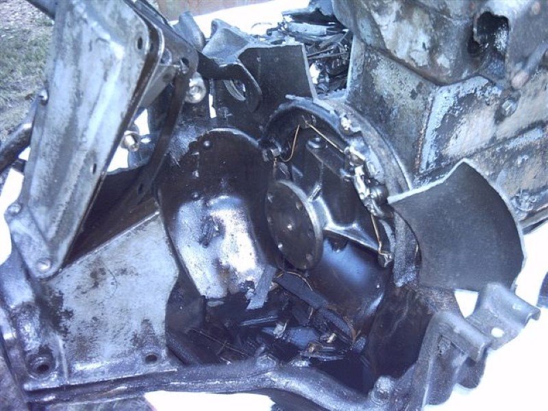

Here are some photos from a forum post about what happened when someone towed a model T. Unfortunately I didn't save a link to the post.
The old forums are a gold mine of information.

The recurring advice, that works safely, is put the car in high gear and pull it slowly. that way the transmission is working and keeping the oil flowing.
On a flat tow with someone in the driver's seat, the car can be let in and out of high gear at intervals to keep the transmission lubricated.
