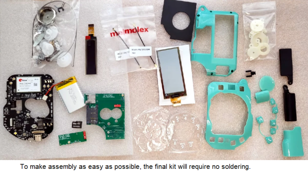

I don't know much about electronics but can muddle my way through with a bunch of hand holding.
The turn signal and running light are for safety the other stuff is just for fun. What I would like is to be able to read on my Iphone, O2 sensor, temp, RPM and GPS. The O2 sensor is so I know what is correct for lean, rich, read lots of good advice on how to set this by feel and sound but I want to see it until I know for sure, same for temp and RPM, I just thought it would be cool. An Iphone APP to show all this is the easy part, just ask my friend to write me an APP.
A project I'm working on now is a 1920's rotary candlestick "cell" phone for the Model T, have a working model just need to figure out how to get it into a vintage candlestick phone.

Yes , not only is there a device you can buy its a complete kit & requires no soldering - Available in several colorsTXGOAT2 wrote: ↑Wed Aug 09, 2023 11:04 pmIs there an interface device that will allow a rotary dial phone to work on modern phone networks?
Maybe some genius will come up with a really good AI robotic telephone operator. Just dial "0", and she'll connect you with anyone from satan to Jesus Christ anywhere on Earth ... if you have enough nickles.
describes it https://hackaday.com/2022/09/10/the-ope ... ars-later/
shows assembly https://youtu.be/uV1C-41tq64
