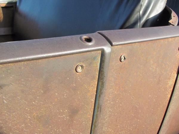

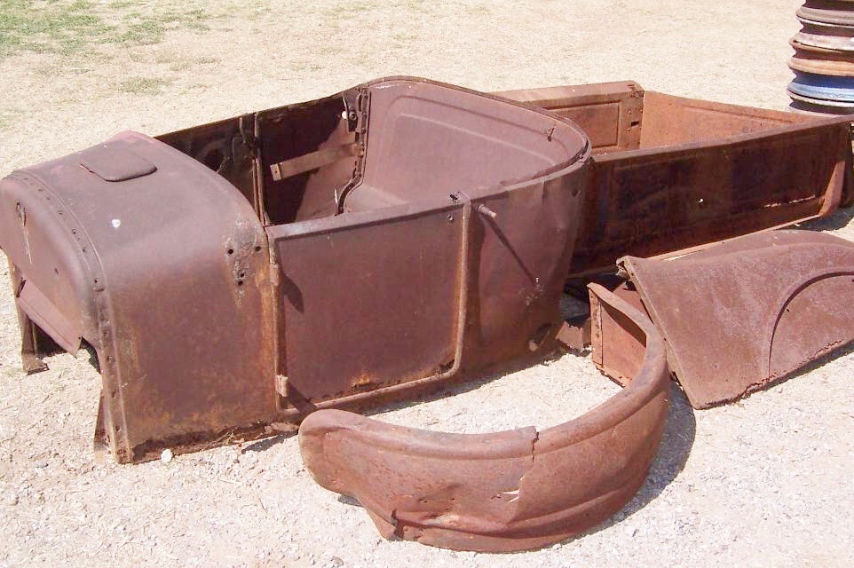

Photos of some '26-'27 runabout body details
'26 with 3 holes for stanchion, and note the tiny hole in upper left of cowl, there are 4 of these rivet holes, spaced pair ea. to rivet the gas tank webbing anti-squeak inside the cowl. The '27 does not have tiny holes in the cowl, as a cardboard piece molded to fit inside the cowl is used on the later car.
1926.
1927 Four holes at the stanchion, the metal stanchion covers all the holes.
1927 with smooth junction of the door to the jam at the top of the cowl, no bump out.
1927 style door with formed metal around the curtain rod hole, earlier door was just a hole, needing the zinc trim piece.

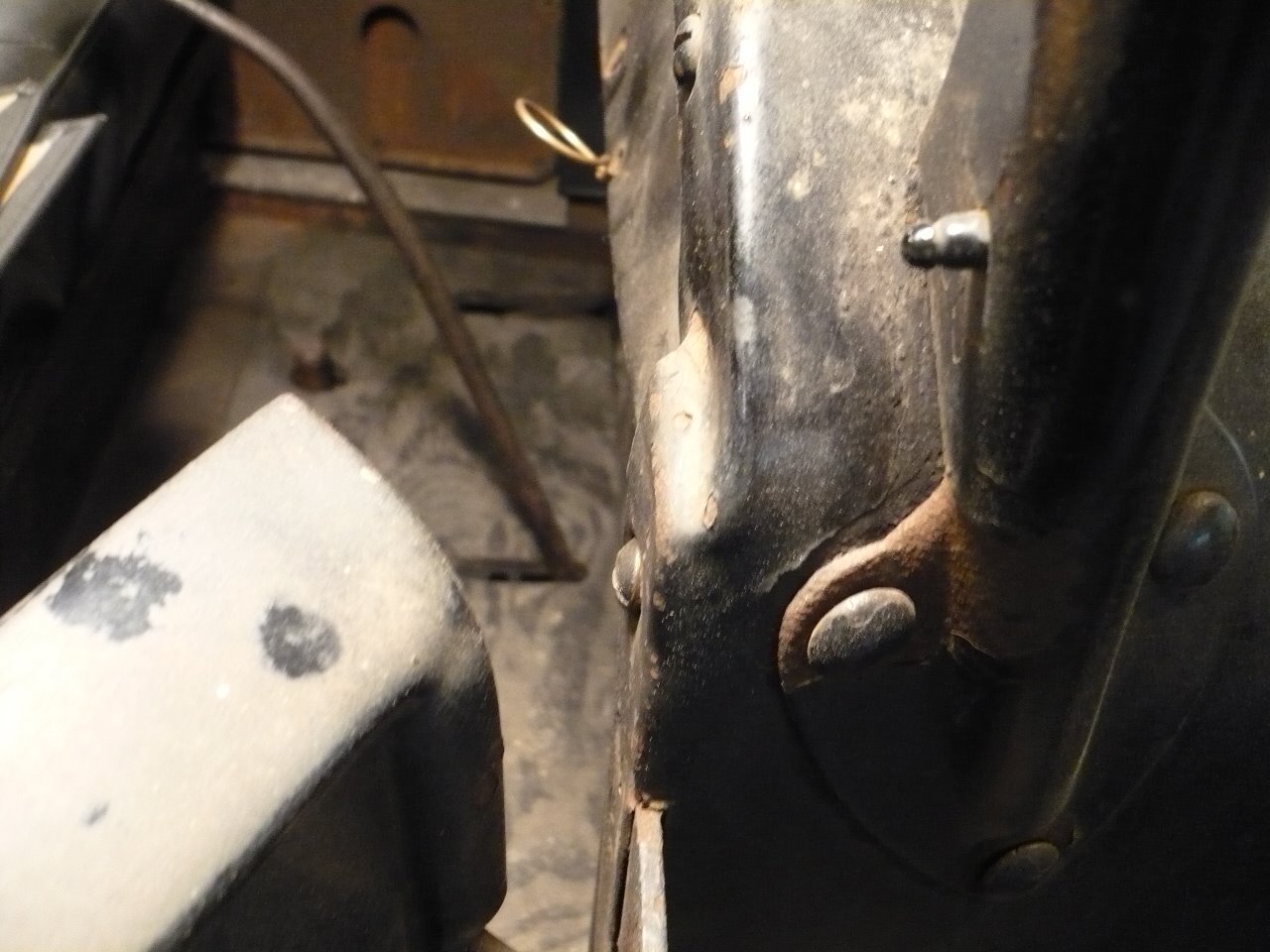

Hi Scott, The bump out on the early '26 Roadsters was on the cowl. If you have Bruce McCalley's book, "Model T Ford, The Car that Changed the World", there are very good close up pictures side by side on page 393 that show cowls both with and without the bump out, with an explanation given by Bruce.

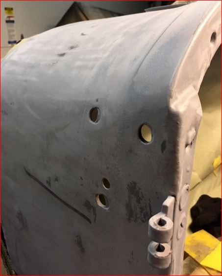

That bump out is rather subtle, best to go look at different runabouts and pick the owner's brain over these features. Looking at the parts first hand is the best way to identify.
If you look (click on photo to enlarge) at that cowl feature at the top of the door hinge post, just above the screw hole that secures the dash panel, you can spy the bump out. Also this body used the earlier windshield stanchion too, that has small inside flange.

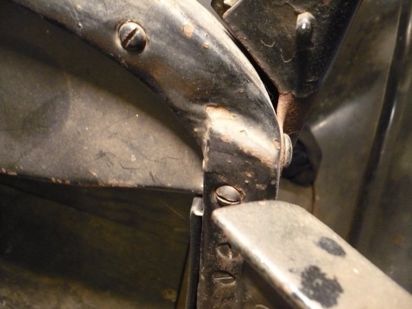

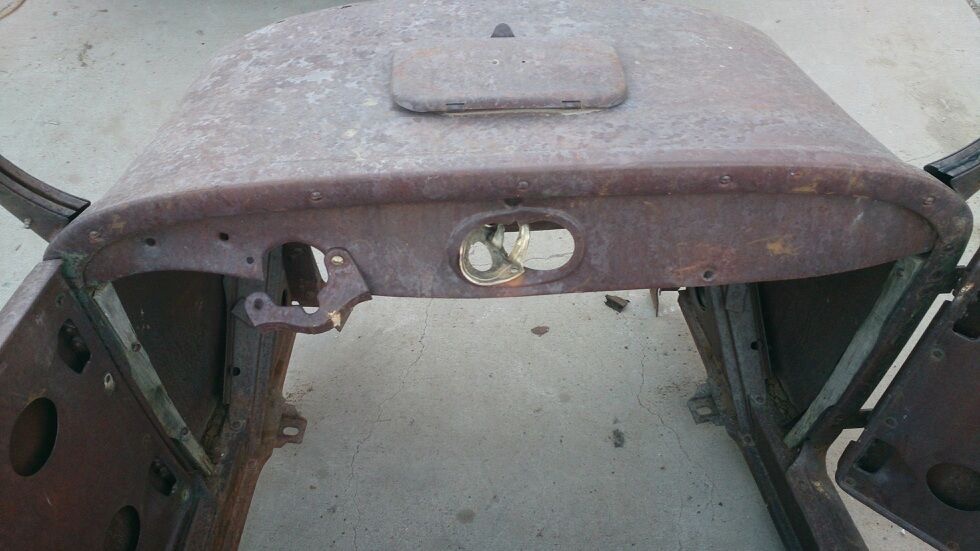

Early roadster cowl
The old forums are a gold mine of information.

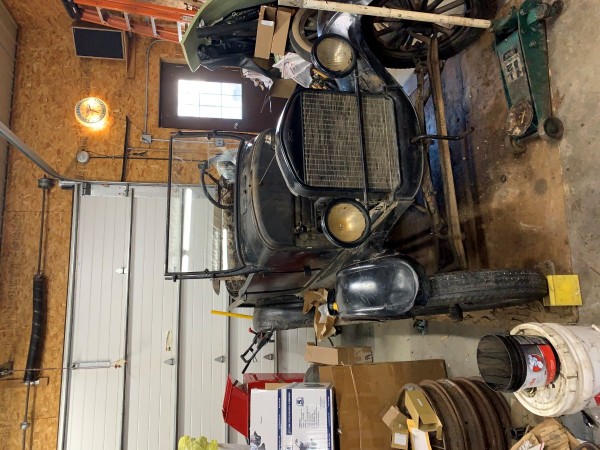

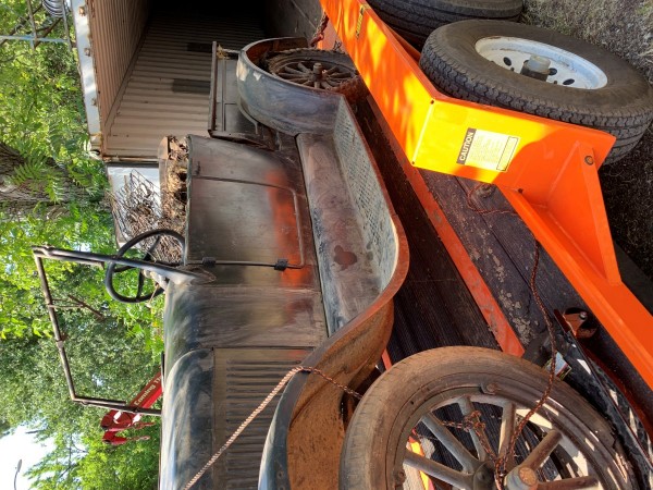

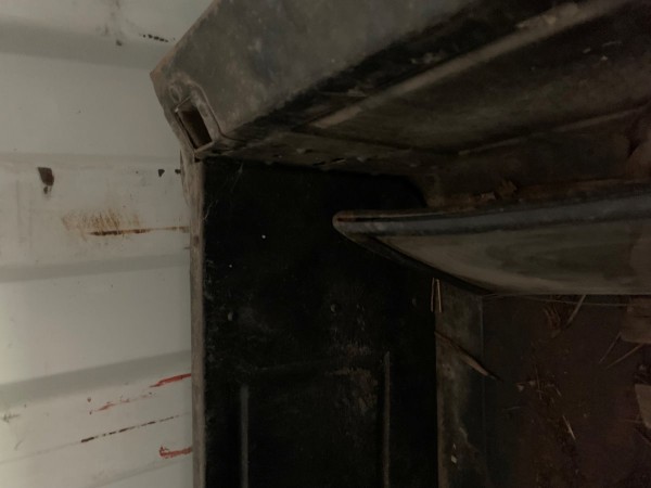

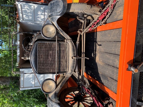

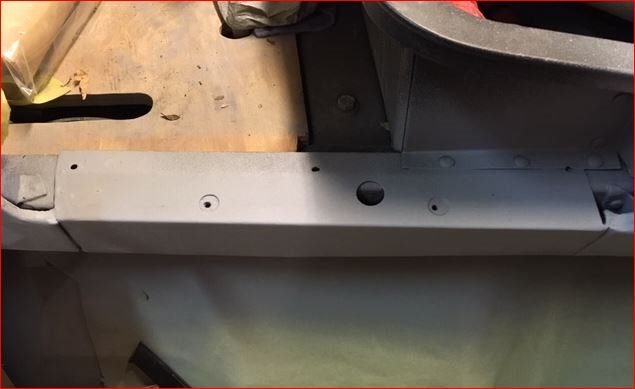

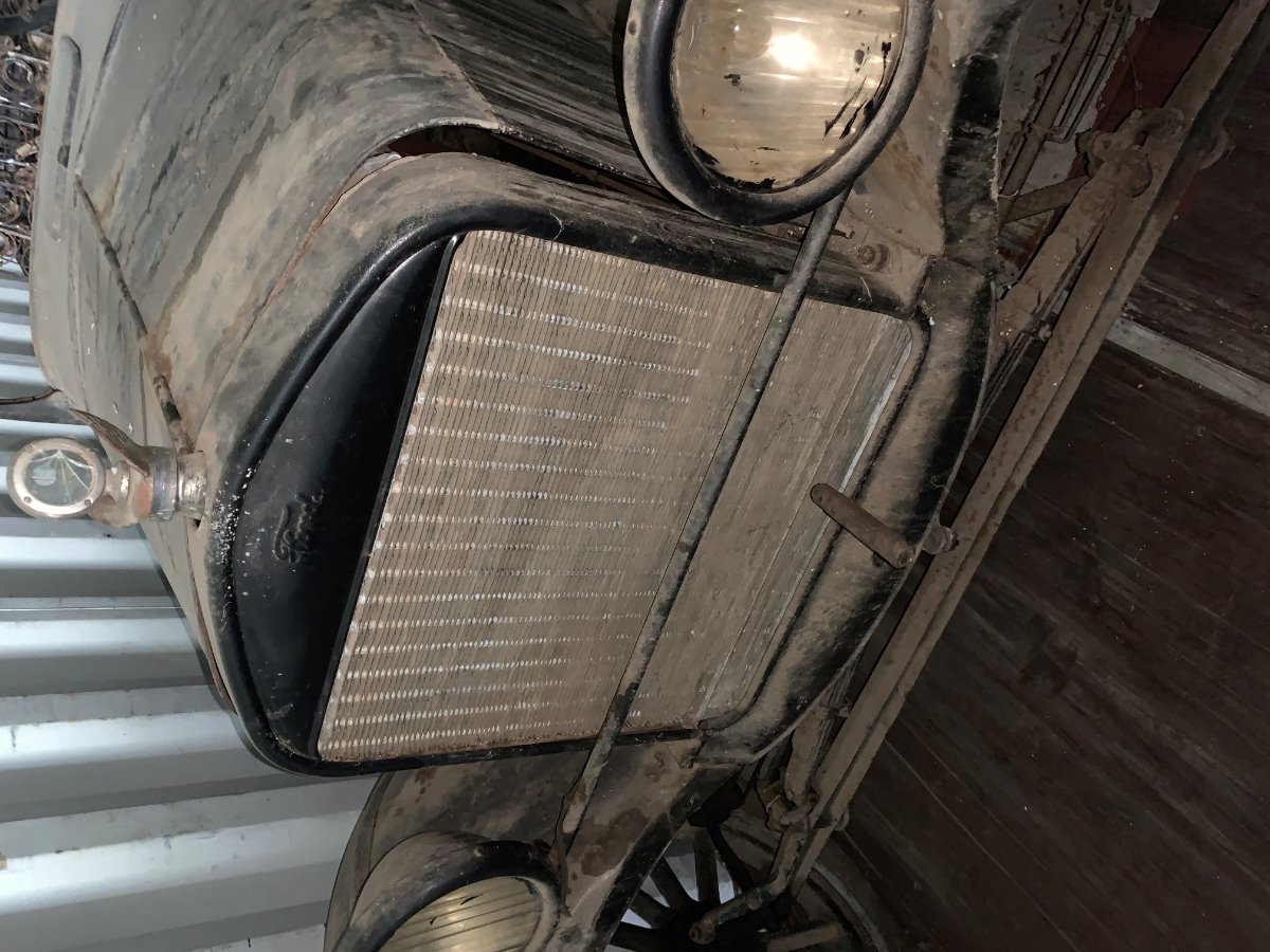

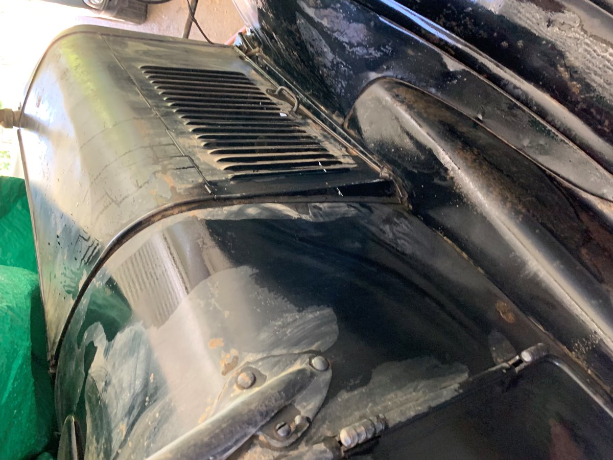

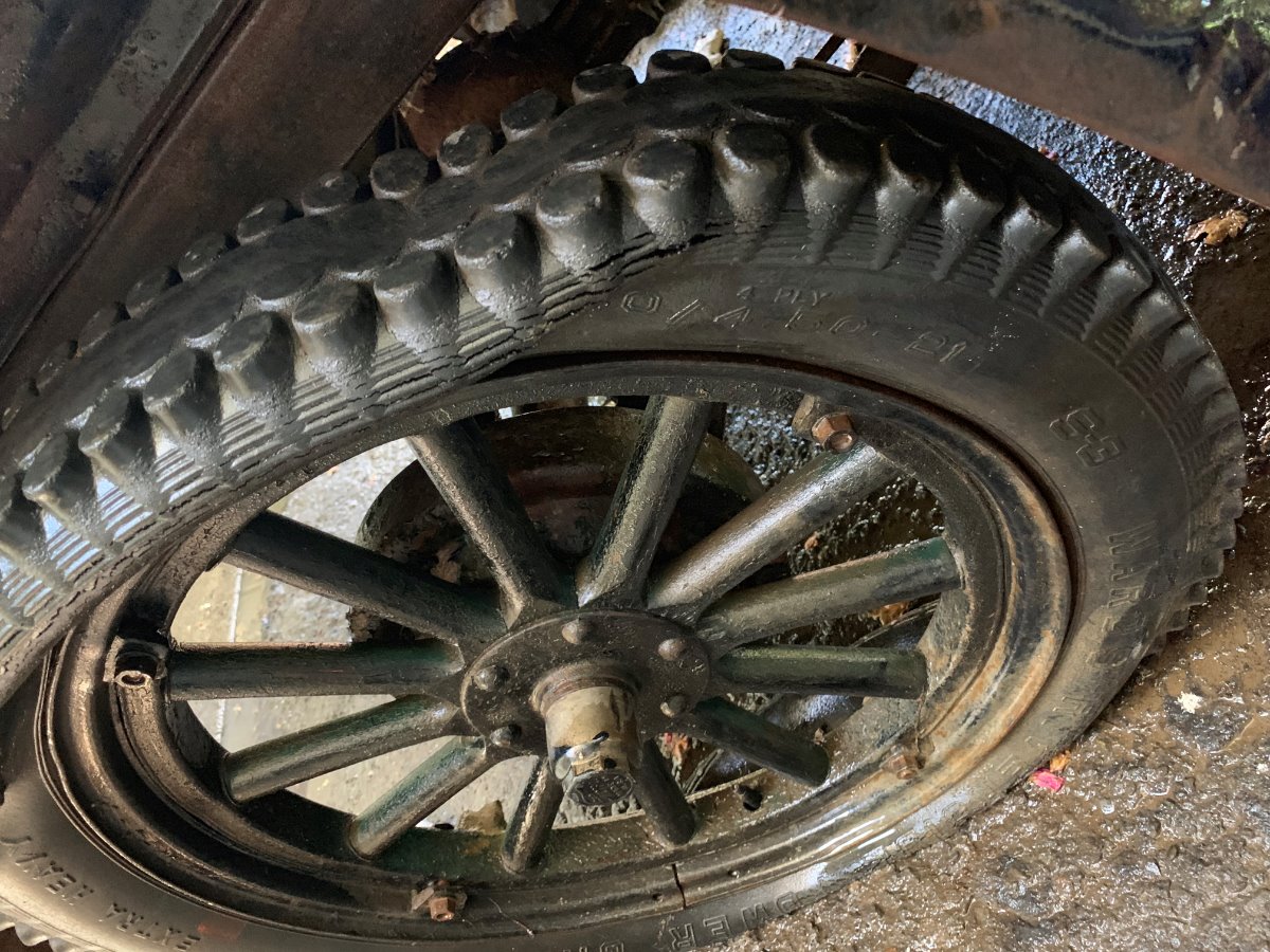

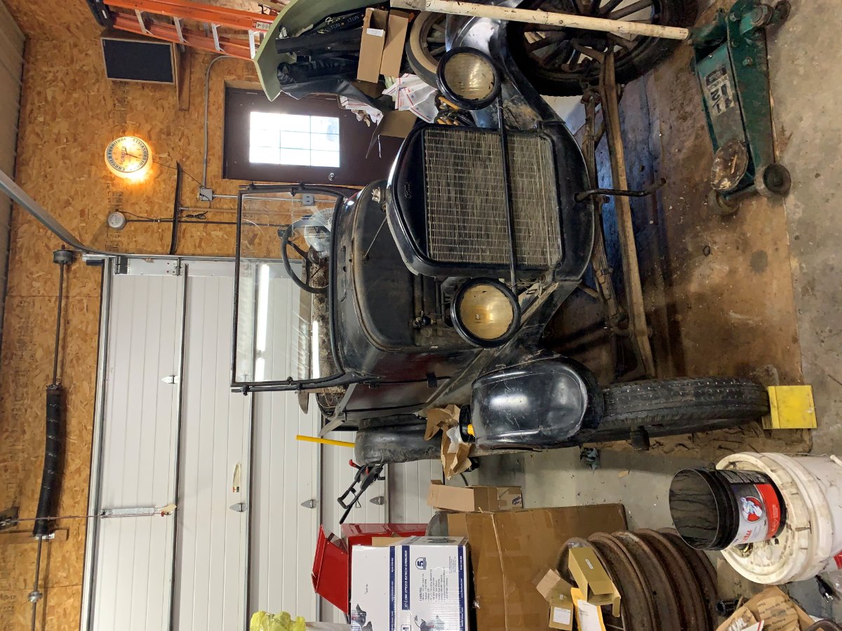

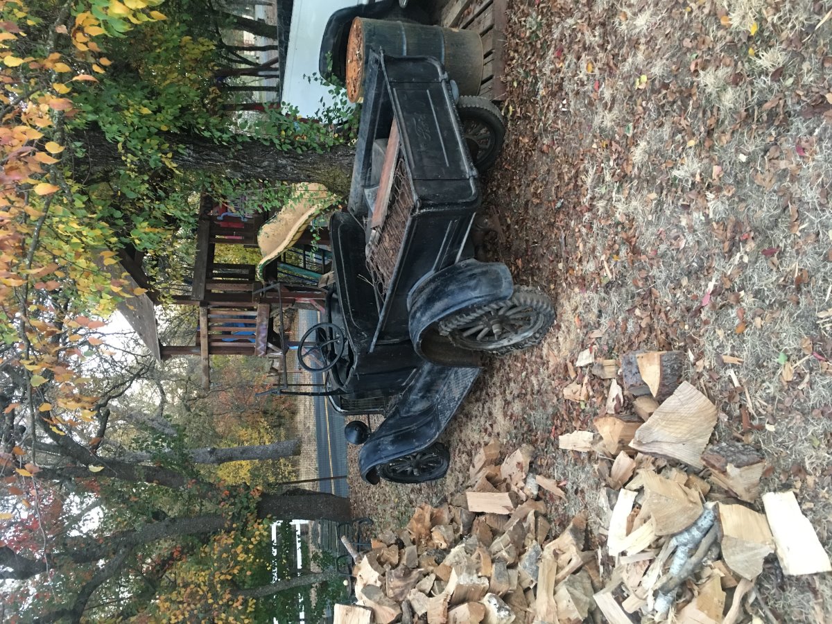

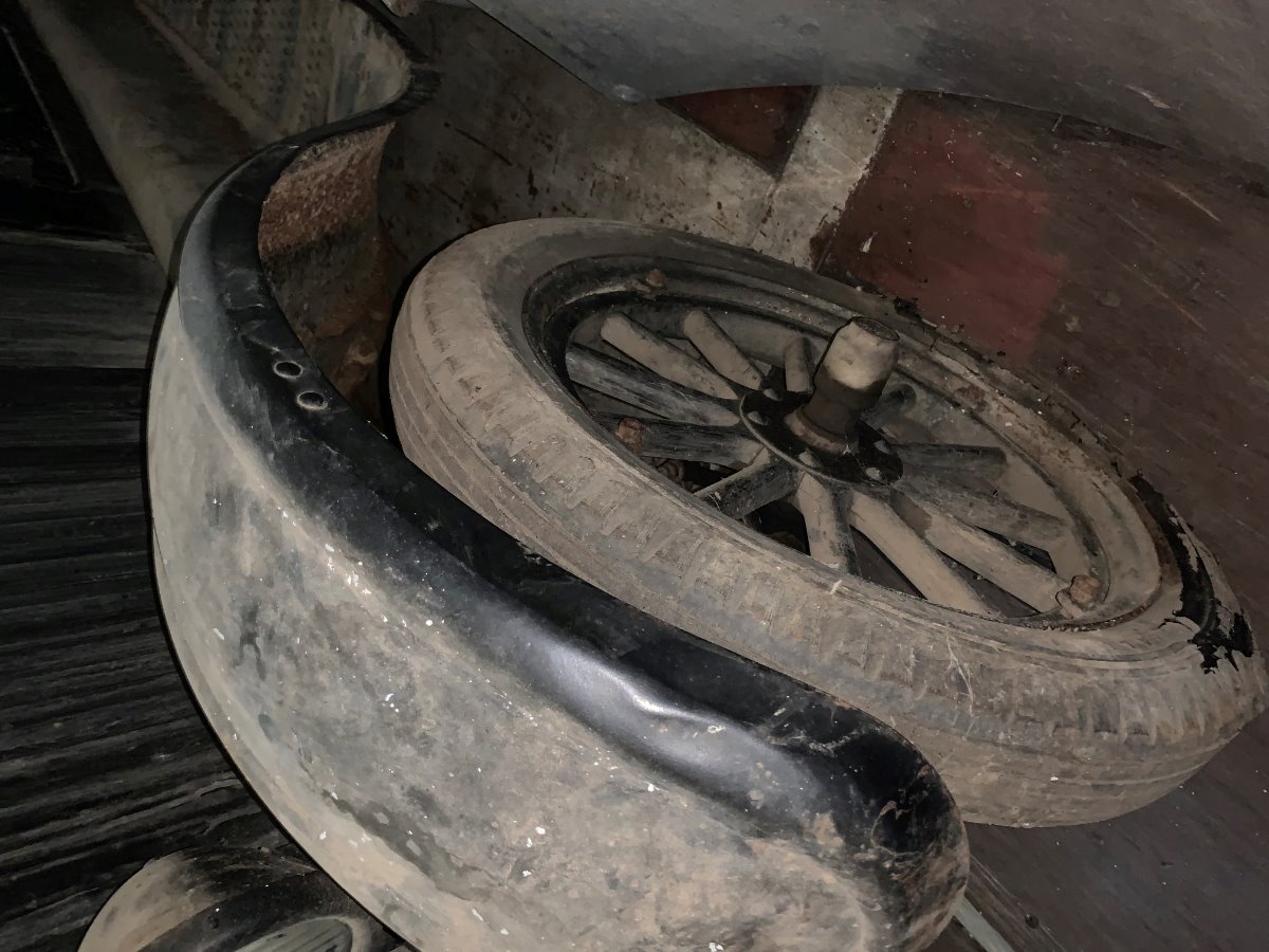

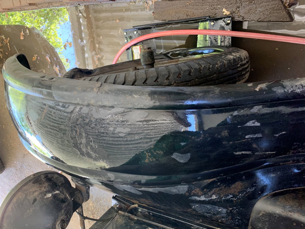

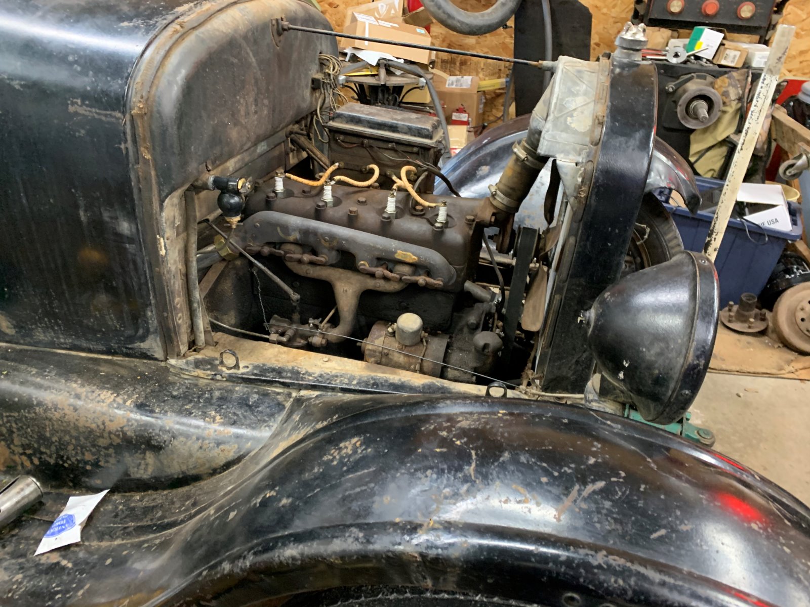

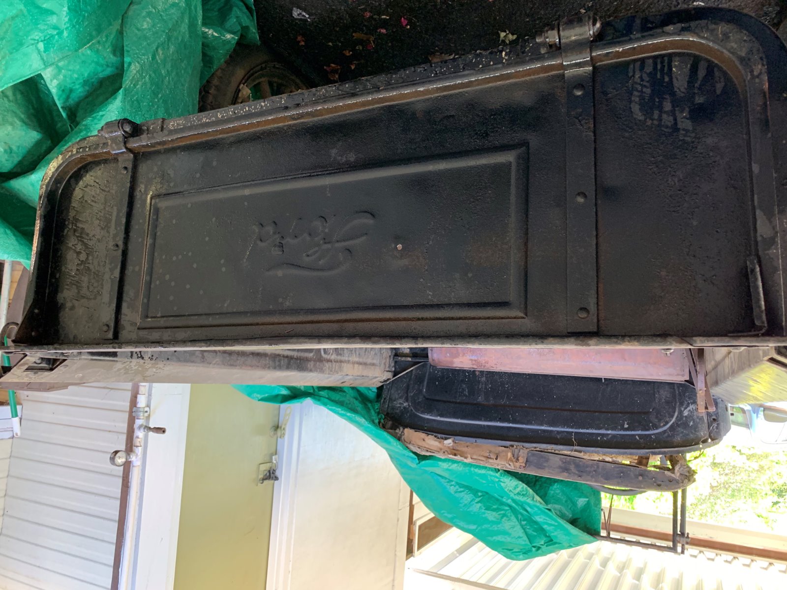

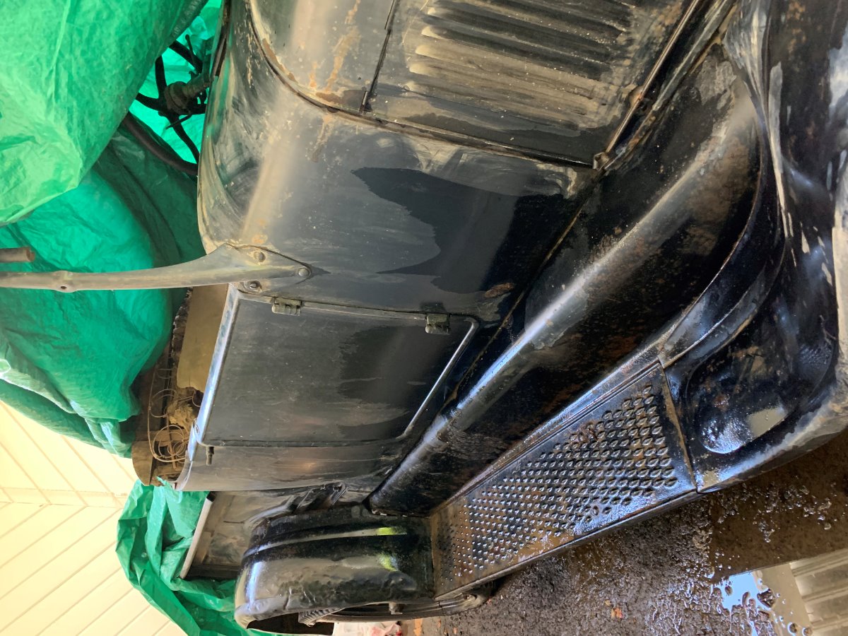

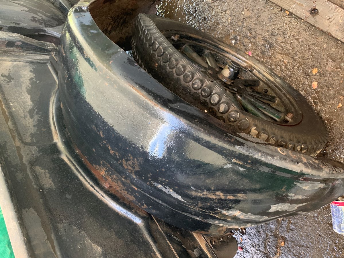

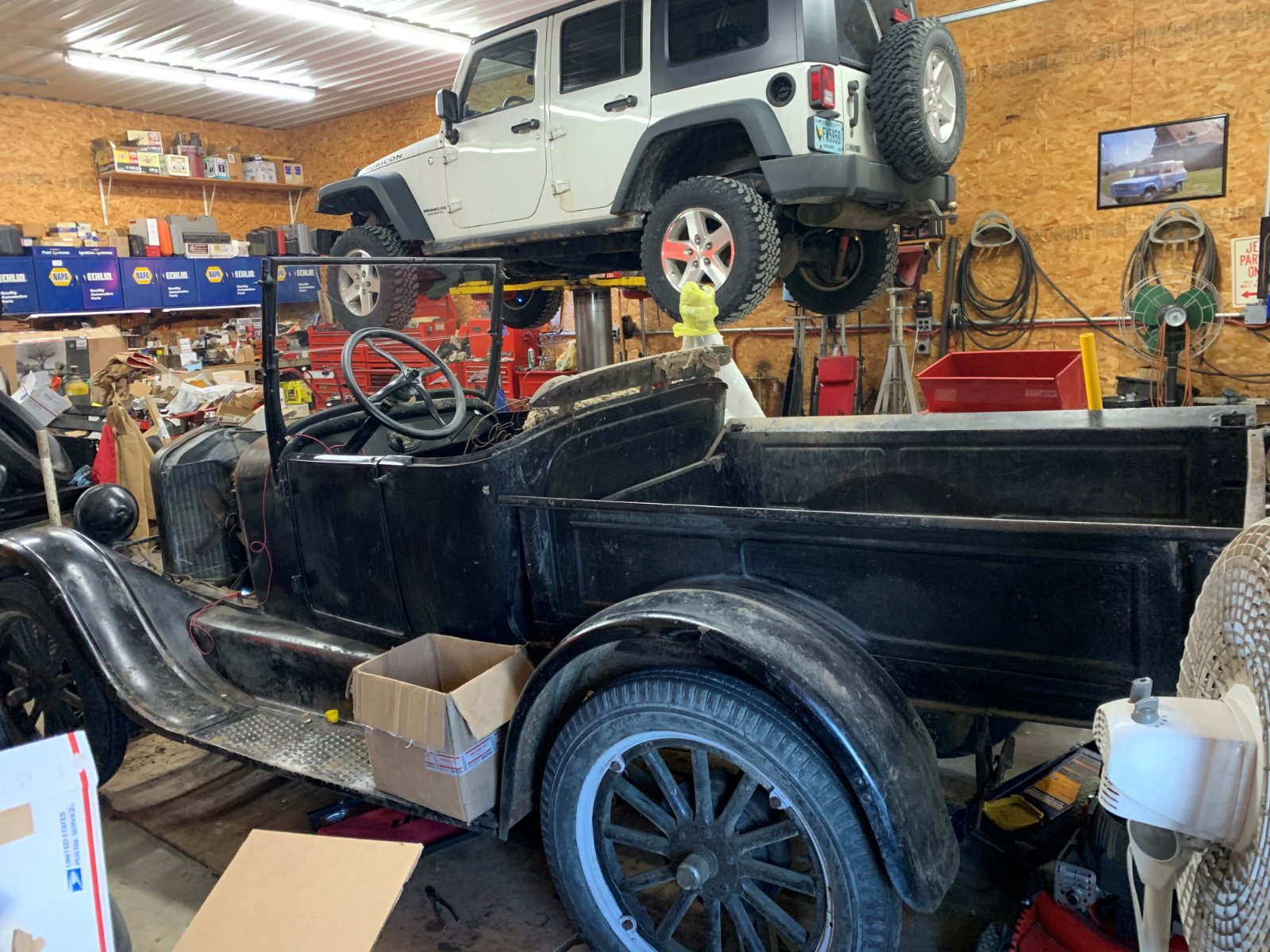

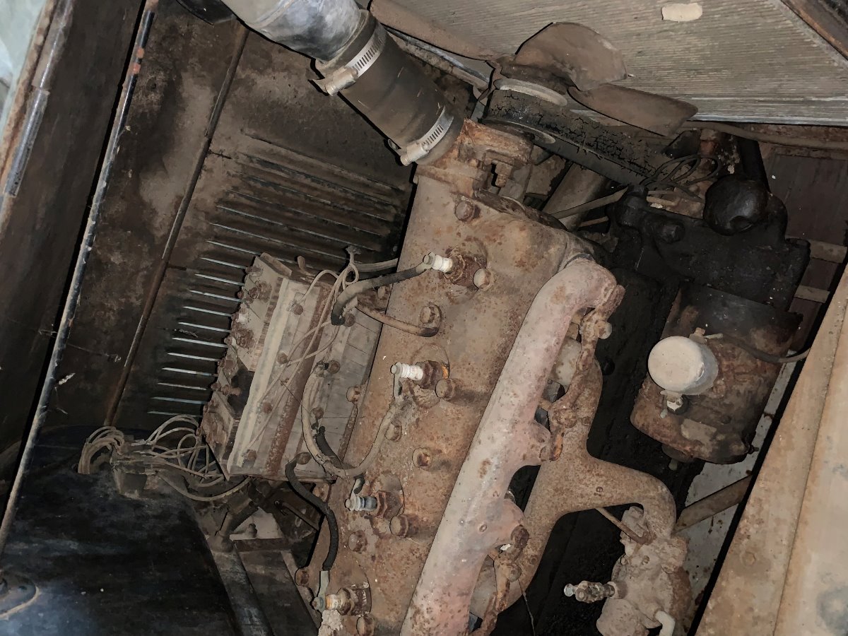

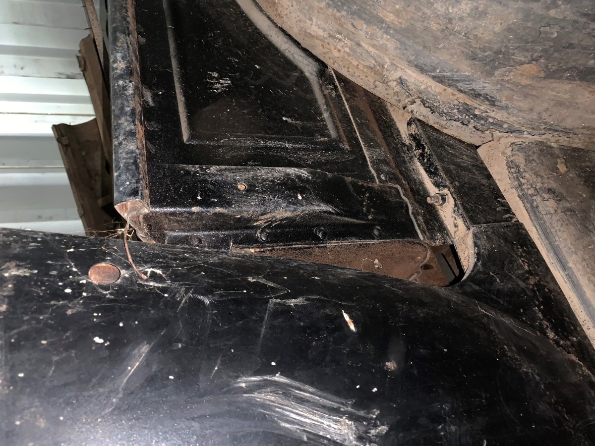

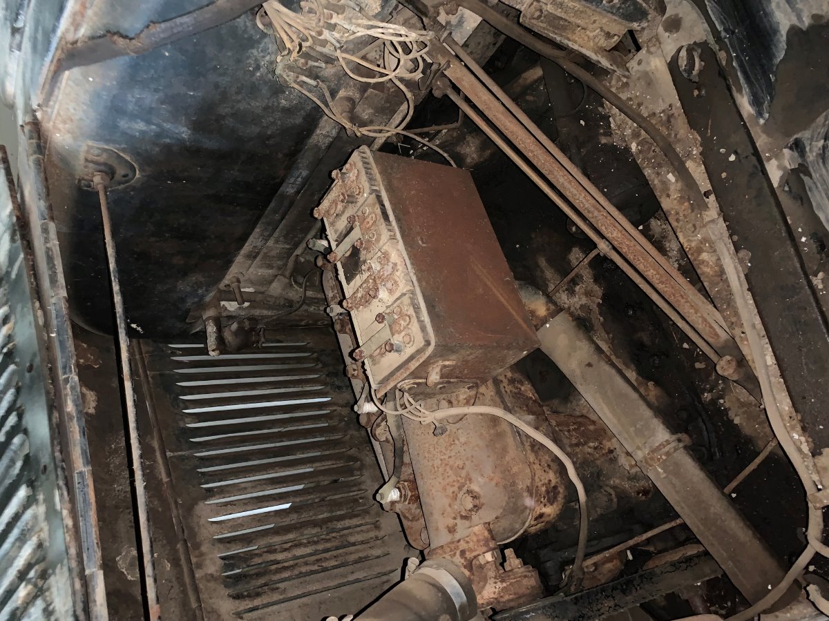

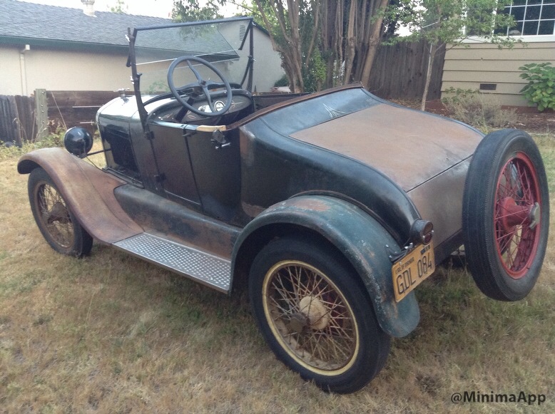

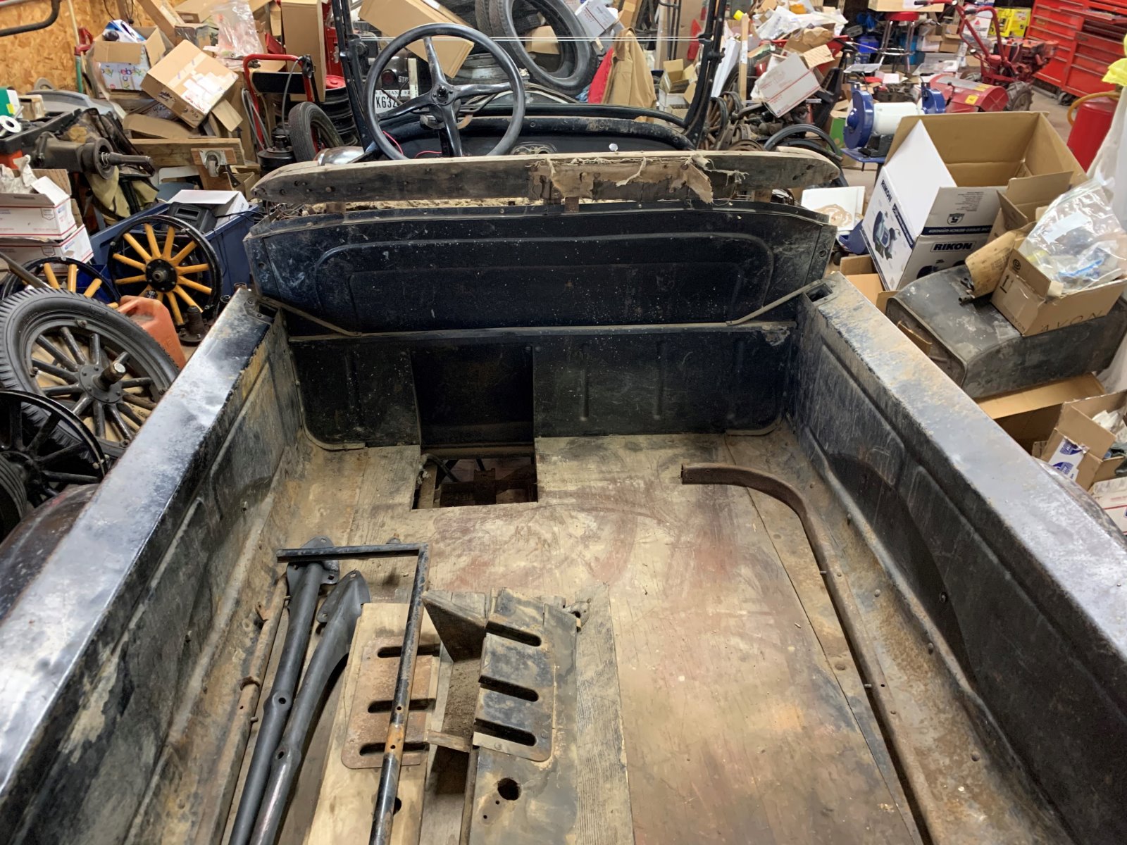

I am trying to figure out if this roadster pickup is a 26 or 27? The engine number is 27. The bed has is earlier with the stake pockets at the front. I don't have very many pictures to go by. But, I might be able to get some taken and sent to me.

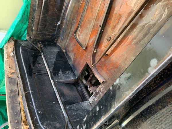

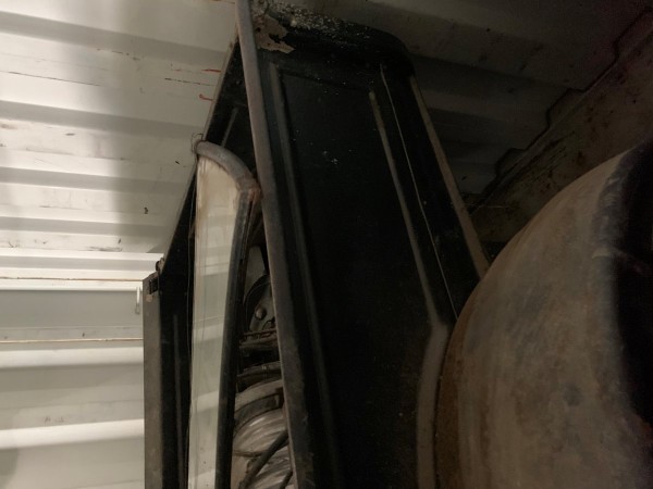

Post by Scott C. » Fri May 17, 2019 2:31 am

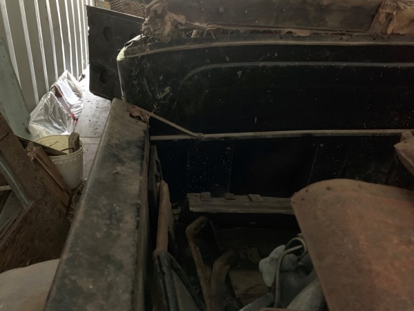

Post by Scott C. » Fri May 17, 2019 2:39 am

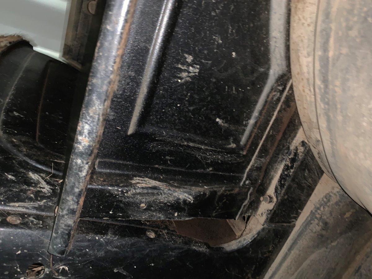

It was setting in shed for a long time then moved to this storage container when the owner passed away. The family kept it and now are selling it because of age and health issues. It does not have a title, but they are working on it.
Posts: 4086
Re: 26-27 Roadster Body Questions
Post by DanTreace » Fri May 17, 2019 10:34 am
Scott

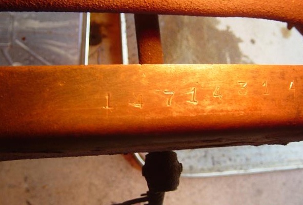

Thanks, good enough photos, expanded some, and saw mostly '27 features. The cowl engine side didn't have rivets for webbing so may have the cardboard gas tank insulator against the dash. The headlamps mounted on bar is '27. The door jam at cowl is '27.
Engine has '27 features, the head bolts have been changed out, but the dome head bolts to hold the manifolds, instead of studs, is '27, those dome head would be nickel plated. The body has mounting holes for turtle deck, so may have been a runabout originally.

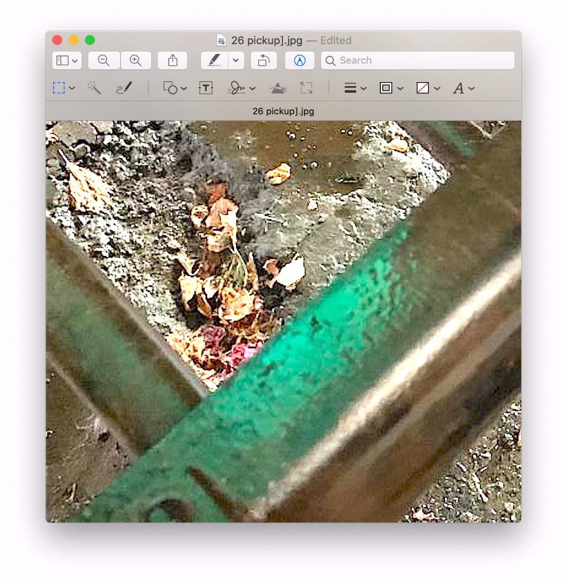

This one is certainly after Dec 1925, so you will find a frame number stamped on the top frame rail near the front running board bracket on the passenger side. That will tell if engine matches frame.
Appears top irons may be in the bed.
It's a nice unmolested T! Good find!.
IMO, the early bed was added, as that mounting bolt with nut on top on the subframe isn't how factory did it, that bolt head would be on top of the bed frame rail, nut below.
Frame rail stamping.
frame number.jpg (93.26 KiB) Viewed 31210 times

I have asked them to look and they can not see any numbers on the passenger side frame rail? I had him to look right above the hand brake rod. He says that there are no top bows. But, I agree that it looks like there might be some in the bed.

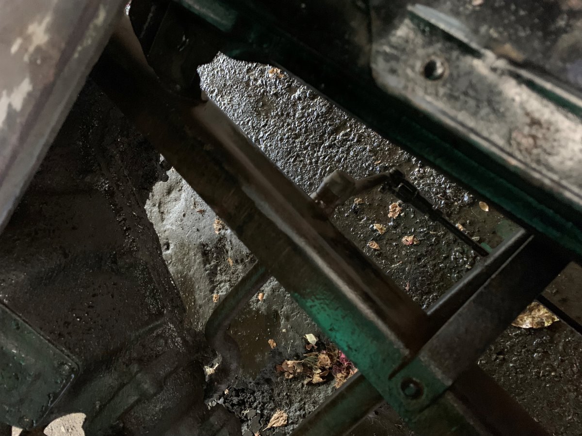

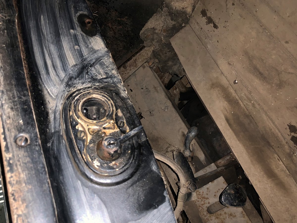

Post by Scott C. » Fri May 17, 2019 11:49 am

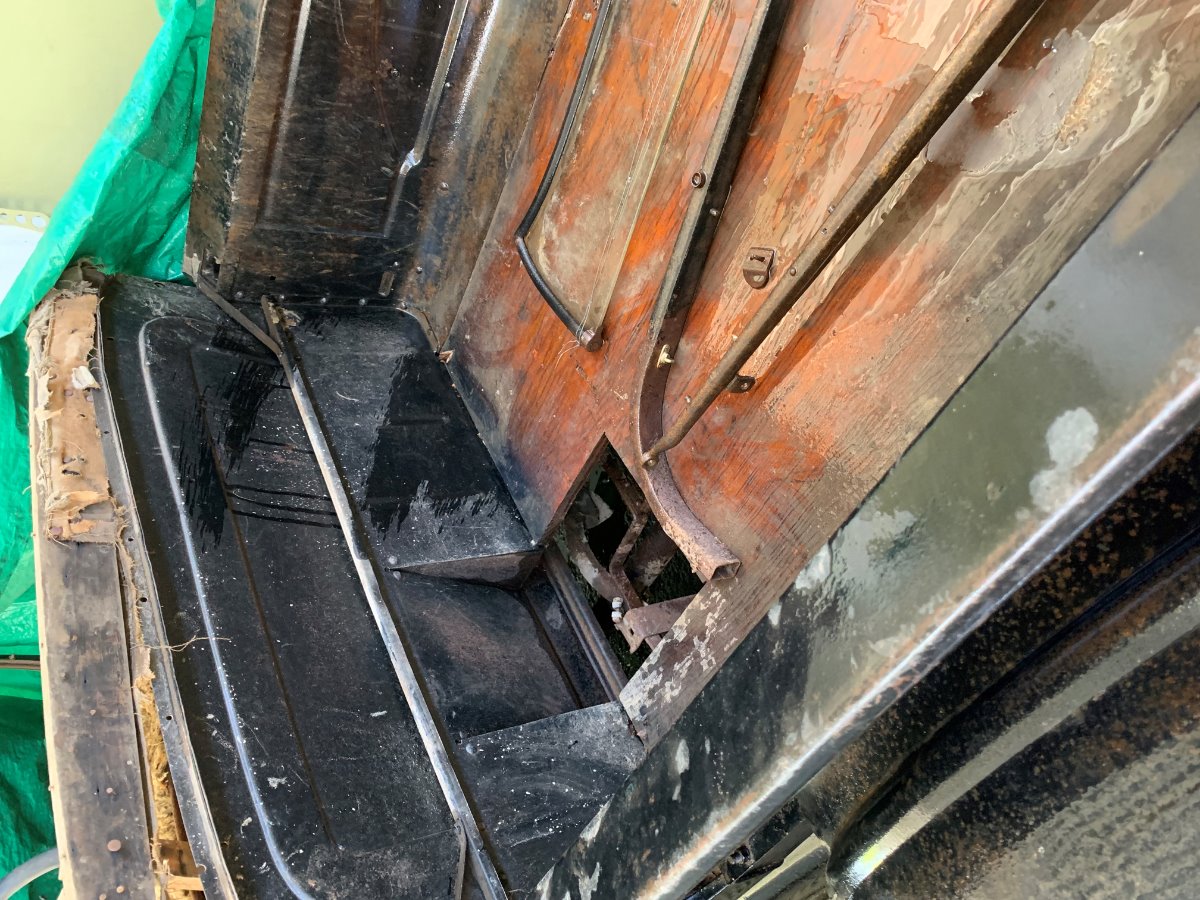

What do you think that is on the floor to right of the brake pedal?
gcomo
Posts: 48
Joined: Mon Jan 07, 2019 8:55 am
First Name: Gary
Last Name: Como
Location: Central Ma
Post by gcomo » Fri May 17, 2019 11:54 am
It looks like a foot throttle.

Dan makes a good point in his post above about checking the for the frame number. I've found it on top of the frame right under where the passengers feet are. It may very likely have a lot of dirt and crud in that area and you might need to use a wire brush vigorously to find the number.
This number is the same as the original engine number for the car and with it you can find the day the engine was made.

This is a '26 windshield stanchion. It has the notched area on the rear side. Later versions look more like the front flange at the rear.

Takes some time to find that frame stamp of the engine number, as it was placed there to be a hidden identification of the car, matches the motor number which is the id. Not usually a casual quick look, lots of crud on frame after a generation as Keith posted.
Rare, but can happen, is the frame number is on the driver's side :( Look there too if all else fails to find one on the passenger side.

That foot feed accelerator on the floorboard is accessory, if you look at the photo of the steering column inside the engine compartment, remains of the device appear on the upper end of the throttle rod.
Typical type of foot feed.

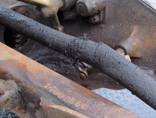

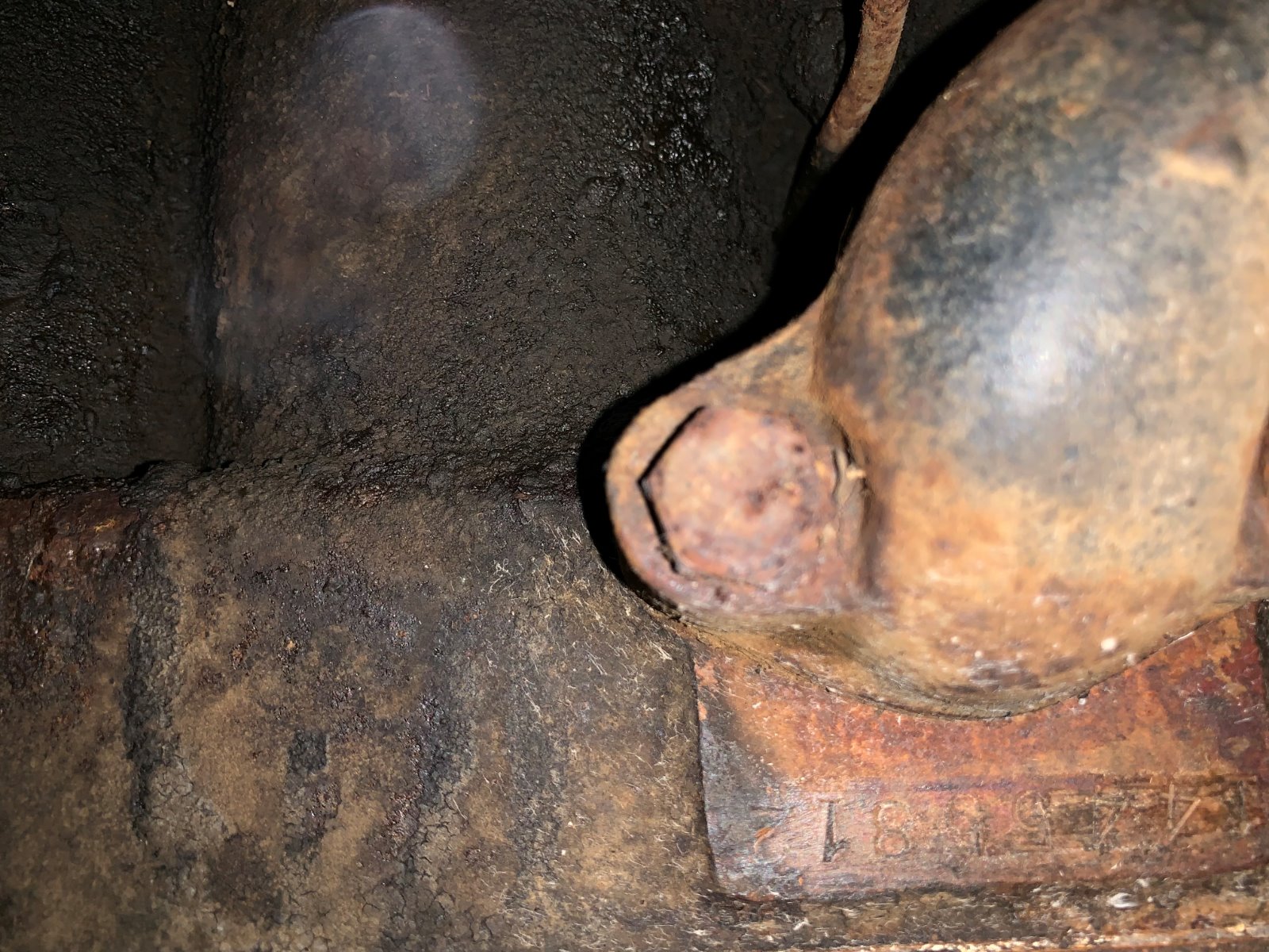

Here is the engine number. When was it built?

Post by Scott C. » Fri May 17, 2019 9:16 pm
For some reason, I can not get the pictures to orient correctly?

Post by KeithG » Fri May 17, 2019 9:46 pm
It looks like the number is 14, 455, 812, but the second #5 is hard to read and is just a guess. Based on that number, the engine was made on Oct. 27, 1926 which was a Wednesday, and there were 5,950 engines made that day.
Since the 1927 model year began on August 1, 1926, this car is definitely a '27.

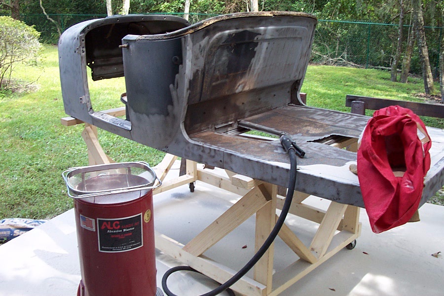

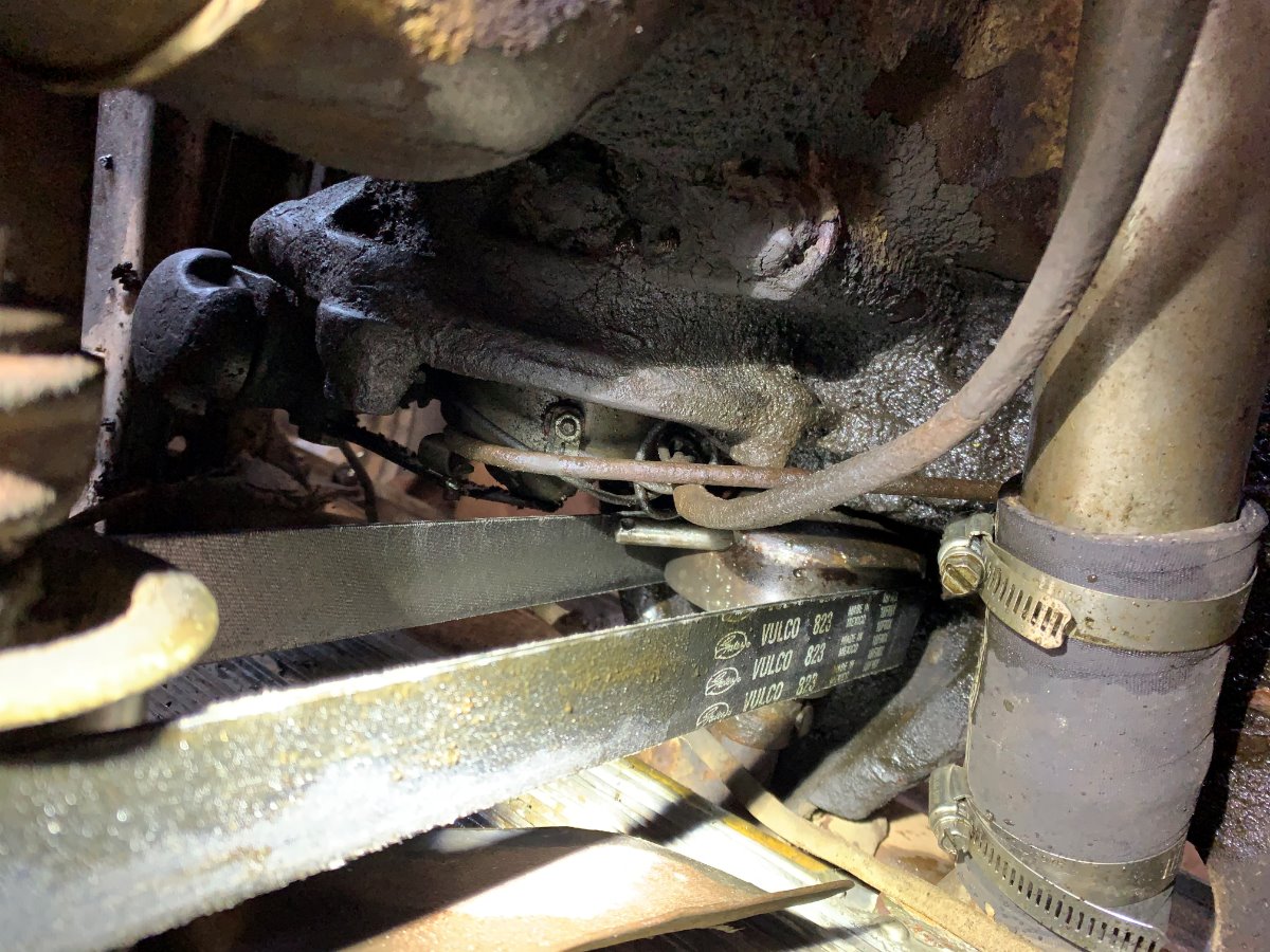

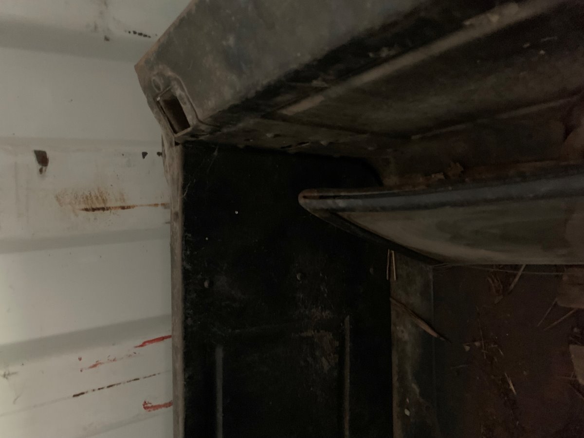

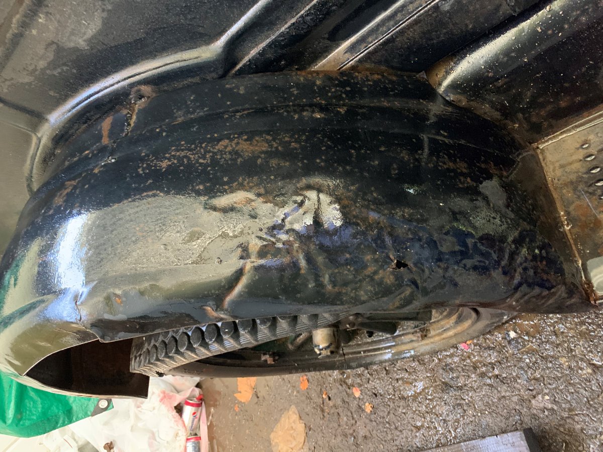

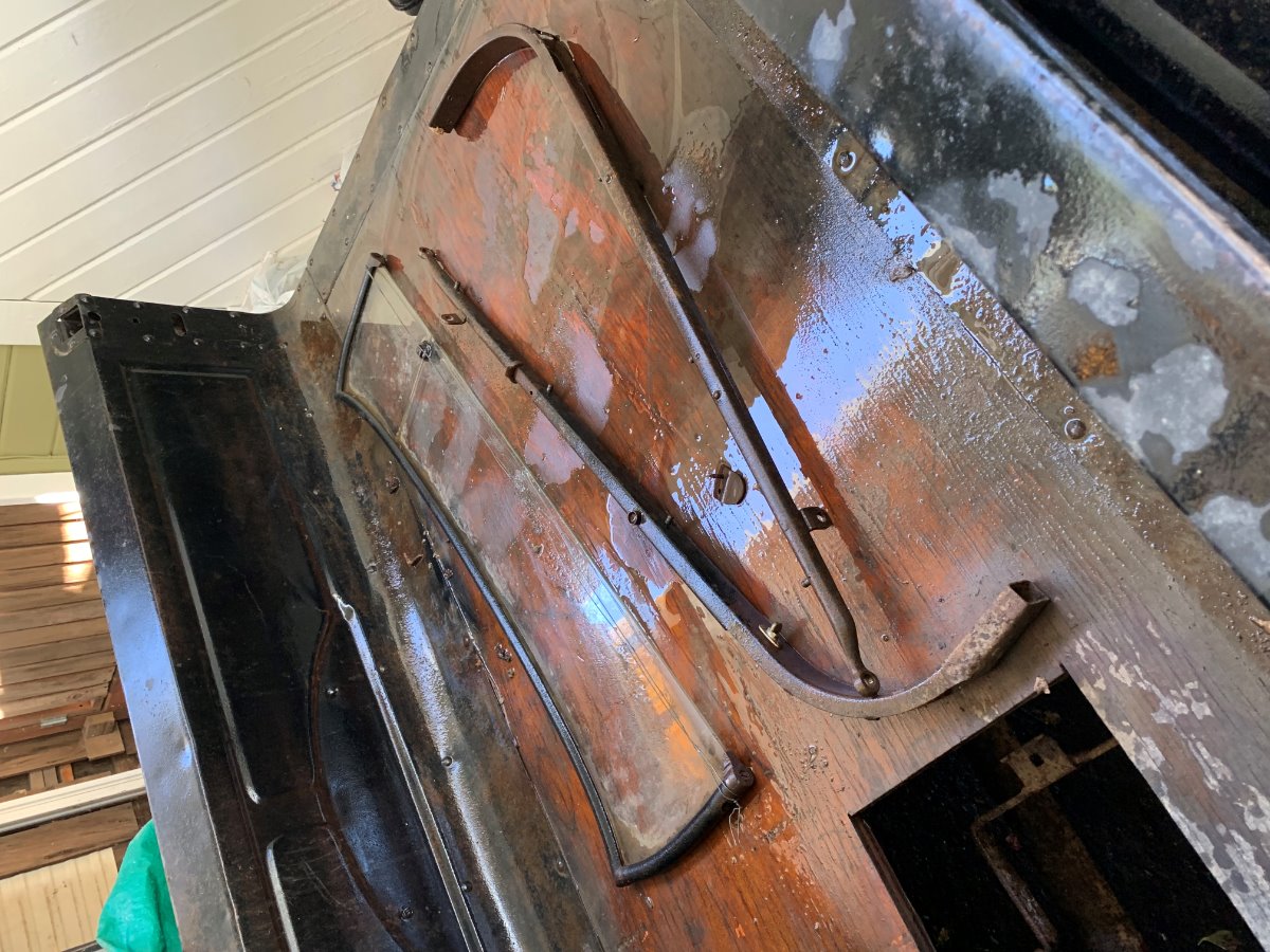

This '26 is a project I've had for several years. I rescued it from a previous owner who was attempting to graft it to a shortened Model A chassis. Paint is temporarily on hold until my wife takes a separate vacation.
One of these days I will research the change notices and try to figure out when the car was built. I believe it to be early production.
Here is the upset on the hinge pillar. The cowl has the four stamped holes on the cowl for the windshield stanchion. One thing I hope to research is if the stanchion change occurred around the same time they added the drain hole to the cowl.
Here is the 1926 steel rocker. A separate zinc panel with the Ford script is fastened over this. In '27 it became one piece. The previous owner had sand blasted this car and when I replaced this panel, I found damp sand packed in here reaching partially into the cowl.
Tom Miller

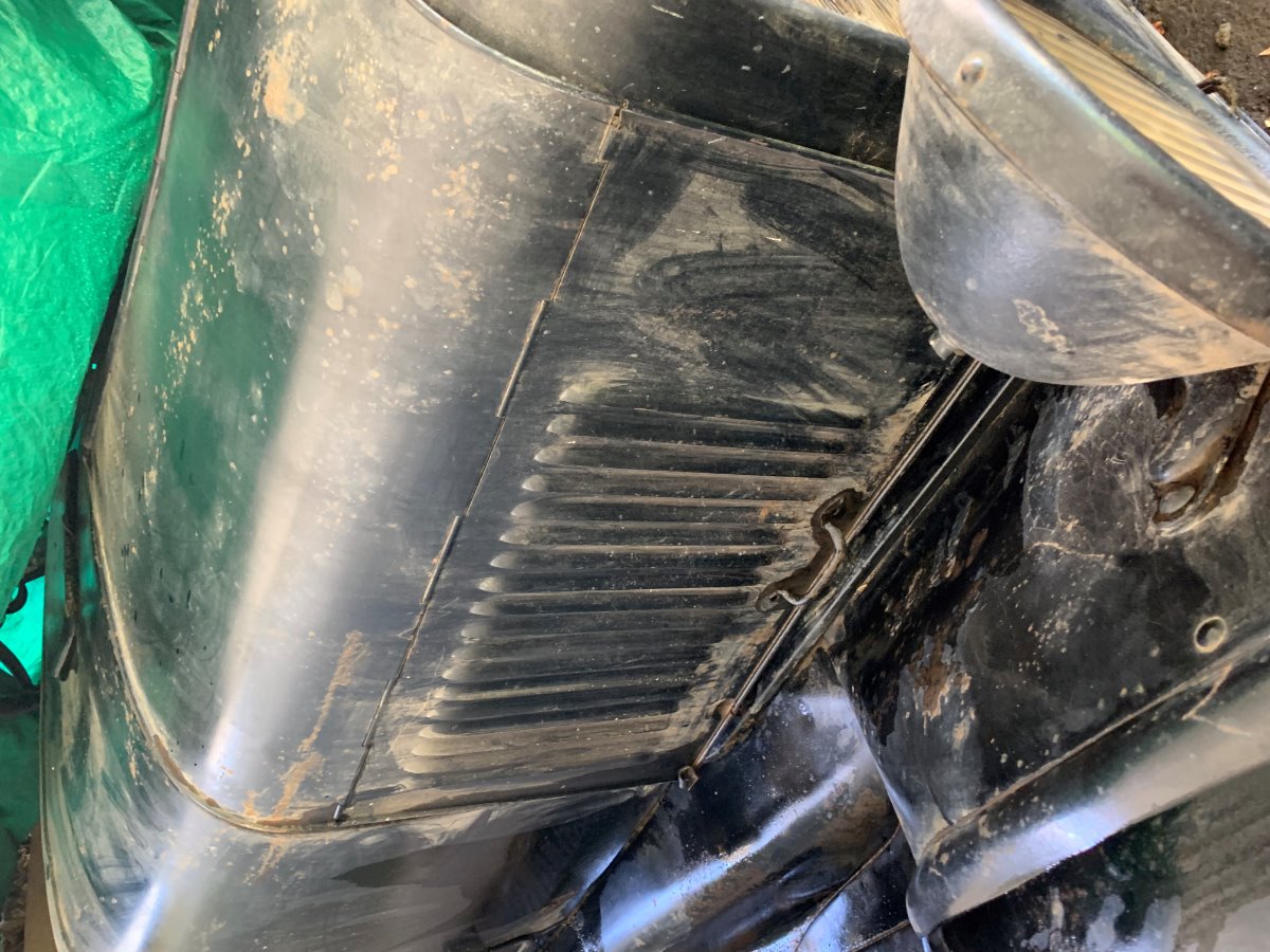

Post by DanTreace » Sun Jun 09, 2019 9:58 am
Real nice project in great shape!
You’ll have fun with that pickup.
The first photo when clicked on to enlarge shows image horizontal and nice original detail on the stanchion mounting fasteners.
Note original factory side curtain clip under that round headed single-slot machine screw.
That screw is correct, many use just carriage bolts at the stanchion.
Missing the lower windshield frame, but it may be in the bed. ;)

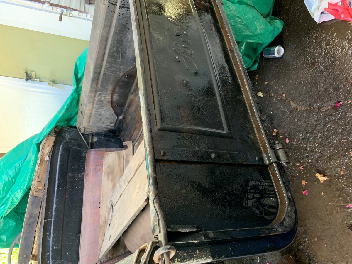

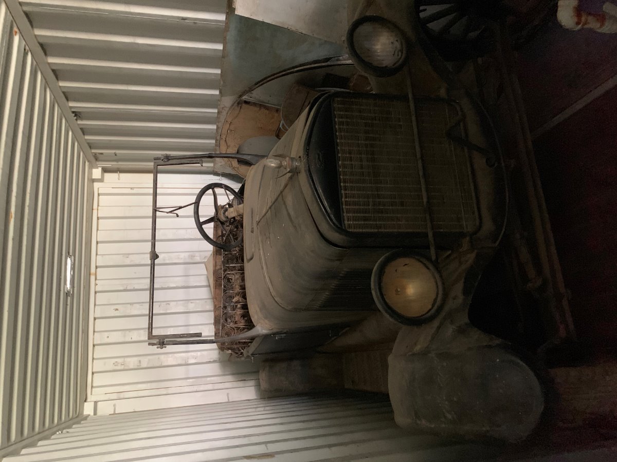

Post by Scott C. » Mon Jun 10, 2019 11:57 am
Here is a picture of the right frame rail. I do not see any serial number.
Scott C.
Posts: 863
Last Name: Clements
Location: Waynetown Indiana
Post by Scott C. » Mon Jun 10, 2019 12:13 pm
Got some more pictures. They rinsed some of the dirt off.
Scott C.
Posts: 863
Last Name: Clements
Post by Scott C. » Mon Jun 10, 2019 12:16 pm
Scott C.
Posts: 863
Last Name: Clements
Post by Scott C. » Mon Jun 10, 2019 12:19 pm
Posts: 4086

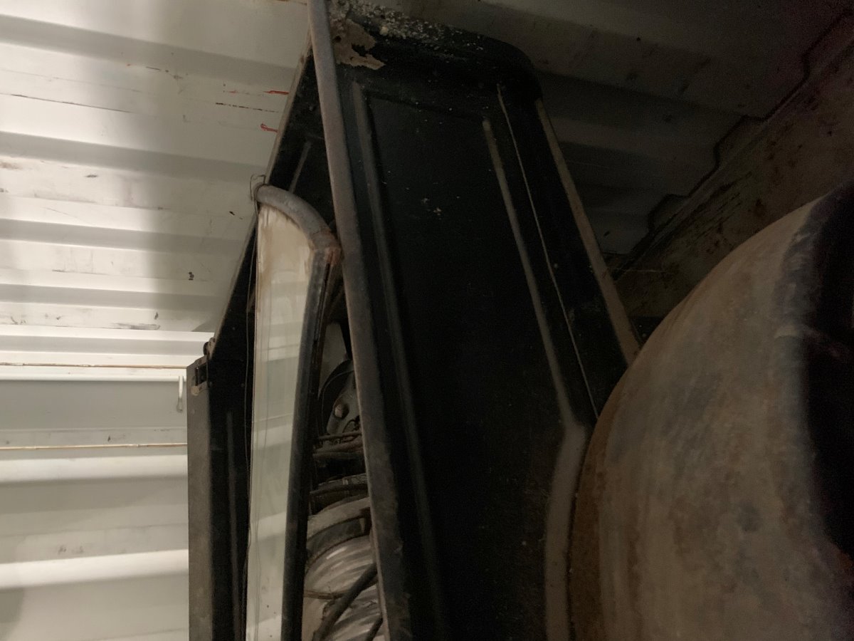

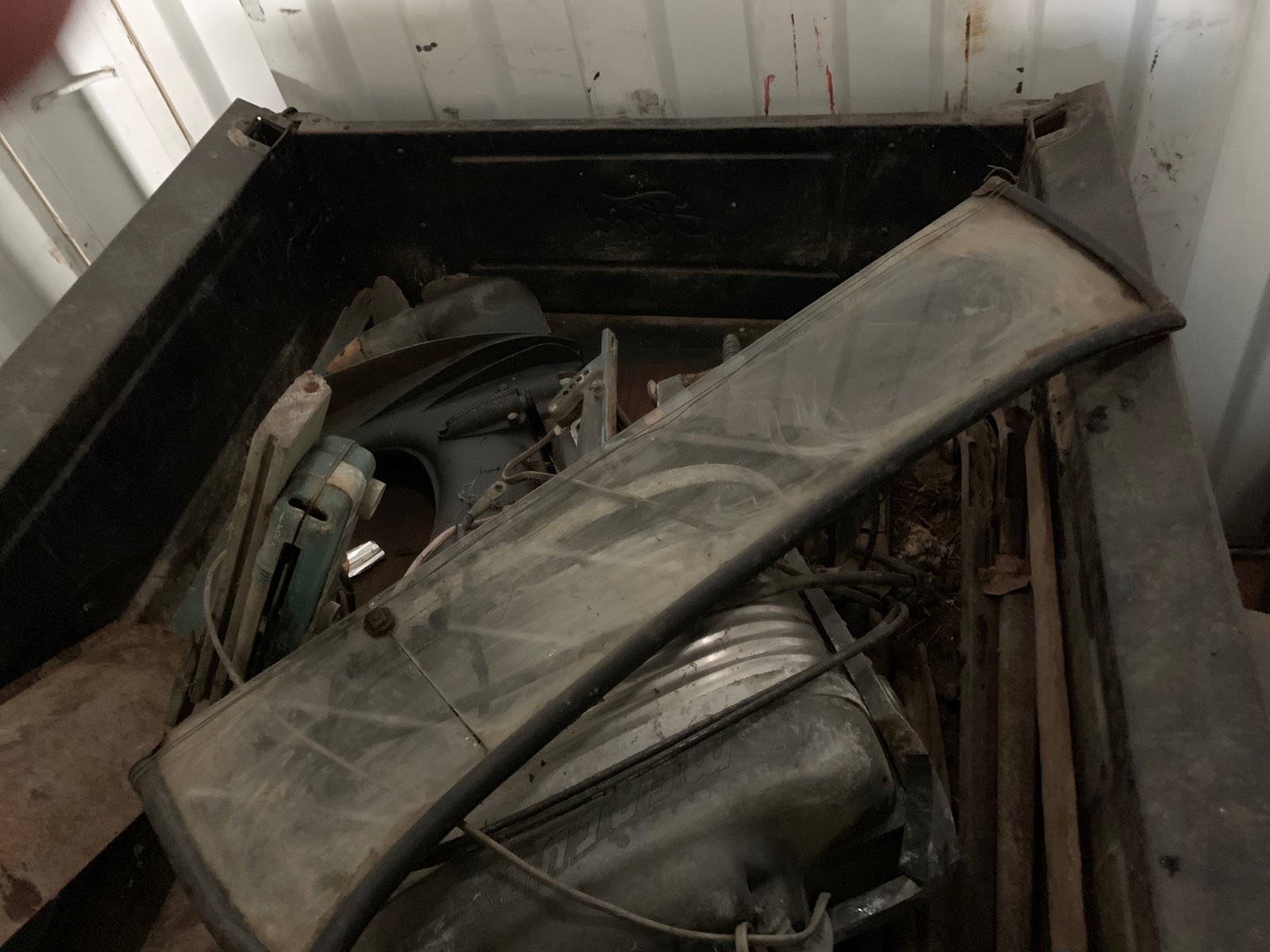

Post by DanTreace » Mon Jun 10, 2019 9:36 pm
Scott
Nice pics, when clicked on to expand, the photos got vertical and could zoom with the Mac to see details.
The bed got changed to plywood, and the rear backrest wood is from an earlier T. The runabout would have vertical wood slats and backrest spring hung from the narrow wood tack strip that should be around the top of the body tub. The rear fenders are well worn1. Those knobby tires a bit flat!
But a great project.
Zoomed in on the frame rail, and believe I can see numerals of the serial number under the green spray paint section. Just not clear to see, you could with a visual inspection.

I that think I can see some numbers there. Not sure if that is green paint, or just some glare? Maybe I can get them to get a better picture?
Posts: 4086
Post by DanTreace » Tue Jun 11, 2019 8:12 am
If you can’t visit to see your self, the owners will need to lightly sandpaper the area to allow the faint stamping to show in a good close up picture. These frame stamps are 93 years old now and the frame rail can have surface rust that hides the numerals. Original stamping are hand done and vary on clarity.
If the new owners are getting title papers you want to be sure they get correct numerals off the block and/ or frame.
Once had the seller’s son write down the block numbers, they went to DMV, got papers for me. When I got home with the T, and was going about getting title in my name.....dang!, the numbers were wrong. Had to go thru a bunch of hoops to correct that miss by the son. Always check yourself is my motto now :)
Scott C.
Posts: 863
Last Name: Clements
Post by Scott C. » Wed Jun 12, 2019 1:24 am
He says that those are just scratch marks or lines and not numbers? It is too far away to look at it myself.

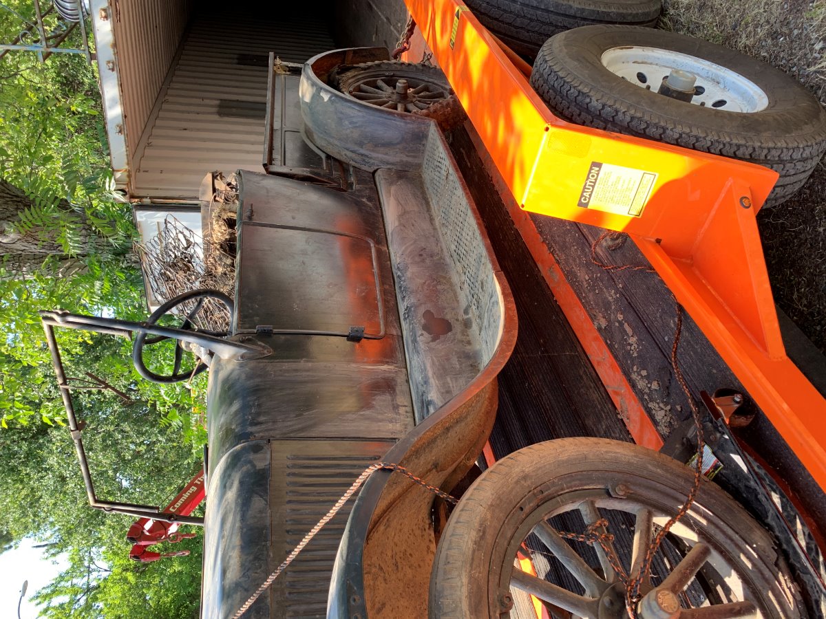

Post by Allan » Wed Jun 12, 2019 11:57 pm
Scott, I was interested to see in the first photo of the car on the trailer that the left front wheel has a Canadian split rim. These have the two holes either side of the split to accommodate a special tool used to collapse the rim when fitting tyres. The usual rim tool will work on them also, so it is of no real consequence.
Scott C.
Posts: 863
Last Name: Clements
Post by Scott C. » Thu Jun 13, 2019 1:22 am
Got some good news tonight. The seller had pulled the spark plugs and put some Marvel Mystery Oil into the cylinders a couple weeks ago. Today he was able to turn the engine over!!
I noticed those holes on the rim too and wondered why they were there? The right rear is the same. I can not see the other two. Now you have me wondering if this might be a Canadian built? What should I look for in order to determine whether it is USA, or Canadian?
Posts: 4086
Post by DanTreace » Thu Jun 13, 2019 9:35 am
The runabout pickup isn’t Canadian, only that rim likely is.
Since both rear rims have north feature and both have ag.knobby tires, those rims and tires were acquired north at sometime to put on this USA T.
The T has no features of Canadian, no Robertson screws holding the dash panel, plus that wheel with north of the border rim has a USA hubcap. Other parts would be marked Made in Canada, like the radiator shell under the script, so you would have to have all those parts marked or in place.
This T is rather nicely preserved time capsule of many remaining original parts, including the engine to frame dust pans that are normally gone after a motor is pulled for first repair, that motor is likely un-touched!

Frame serial # stampings are difficult for inexperienced to find, usually hard enough to locate the block stamps! Hidden by rust and are only light 1/4” high numerals, and on some are found on driver’s side frame rail. For VIN, the engine block stamping numerals are sufficient, that is the car’s I.d. number.

Here are a few pictures of it setting in my shop.

Do all roadster pickups of these 2 years have the metal shelf that extends from the seat back to the rear frame cross member? I assume this shelf is what the turtle deck or the pickup bed sets onto?
Is this needed with a wooden pickup box?

dmdeaton wrote:
Tue Oct 27, 2020 7:02 pm
Somewhere along the line (presumably ‘27 model year), the metal pan was omitted from the top of the sub rails, and attached to the trunk floor of the roadsters. I can only assume that the pickups carried this same change
