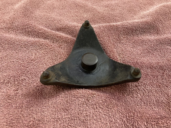

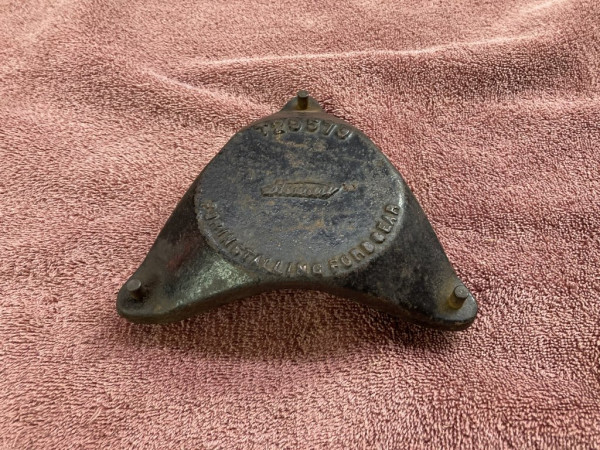

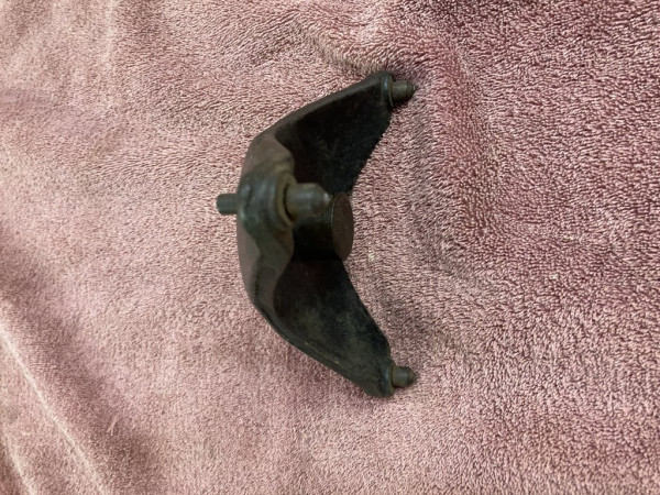

There are two centering tools that were manufactured by Stewart Warner. One tool (painted black) was used for the straight cut gear used on wood wheels and the other tool (painted red) was used for the spiral gear that was introduced in 1926. The early tool was called a "Special Jig" and sold for $.75. I don't know of reproduction tools that were ever made, as they are a very specialized tool and only need to be used once to mount the road gear. I have these tools and when a friend/customer needs to have a road gear mounted, I use the tool to help them. I don't loan out these tools. I hope this helps, Russ Furstnow

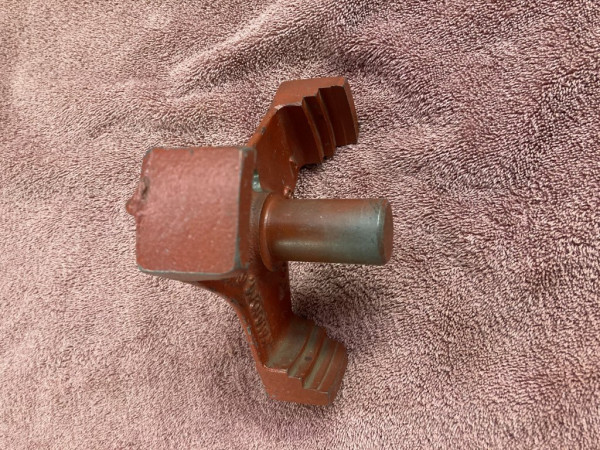

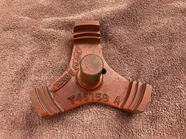

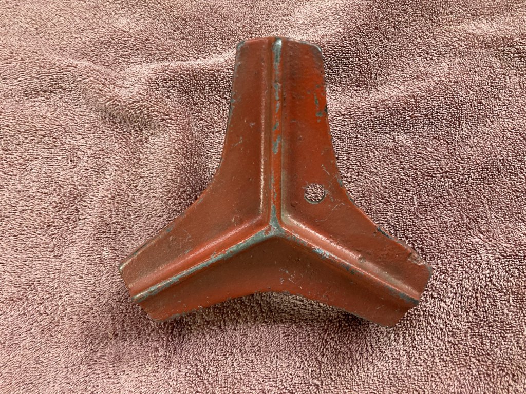

Post by Russ_Furstnow » Mon Jul 03, 2023 10:37 am
Here is the tool for the spiral drive.
