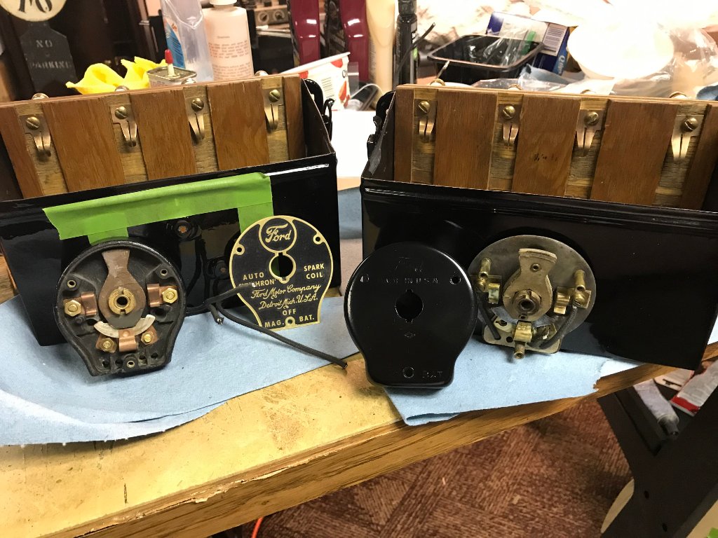

Two issues- It would help to understand what "coil box" you have. Wood or metal and even what style so a picture would help. I assume that the coil box is mounted to a wood firewall. So the Box is insulated from ground. To get a shock some wire , carbon track is making contact to the box which in turn is connected to the switch. Normally these are insulated. Now to get a shock with one hand on the switch another part of your body need so be grounded to the car - like holding onto the spider of your steering wheel. Is your switch one of the ones below. What condition is you box in?

This problem is not caused by shorted coil windings!
I have investigated this problem several times and in each case it was a result of the coilbox having prevuiusly gotten wet, it was started ( a natural inclination of ther owner) and carbon tracks immediately developed in the wood back of the coilbox. Carbonized wood is electgrically conductive. Rebuild your coilbox with a non wood replacement material, you will correct the problem and it wont occur agian.
As I love ot say "trouble shoot and repair a wet Model T coilbox and it an experience you will not soo forget"
