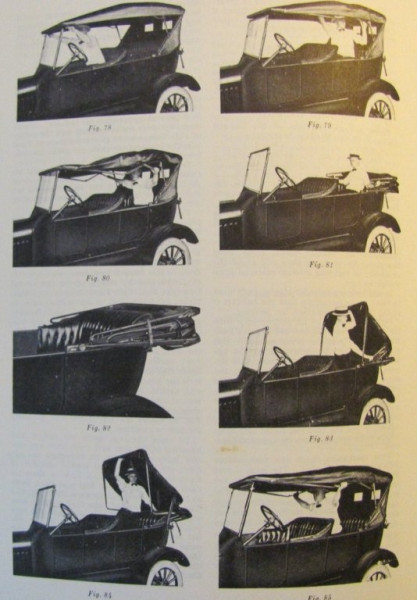

OOPS one man top instructions- the link started out asking for two man top nad then further down was corrected.
ONE MAN TOP INSTRUCTIONS pictures & instructions https://www.mtfca.com/discus/messages/1 ... 1321294130

Frank, aren't those the directions for the later "one man" top? The OP is asking about a "two man" top for a 1922 touring.
For a two man top, see this older thread:
https://www.mtfca.com/discus/messages/2 ... 1349658280
You are correct, thanks for the correction. The link started out asking for a two man top the the instructions were posted. Further down the discrepancy was noted as for a one man top. I corrected my posting above
