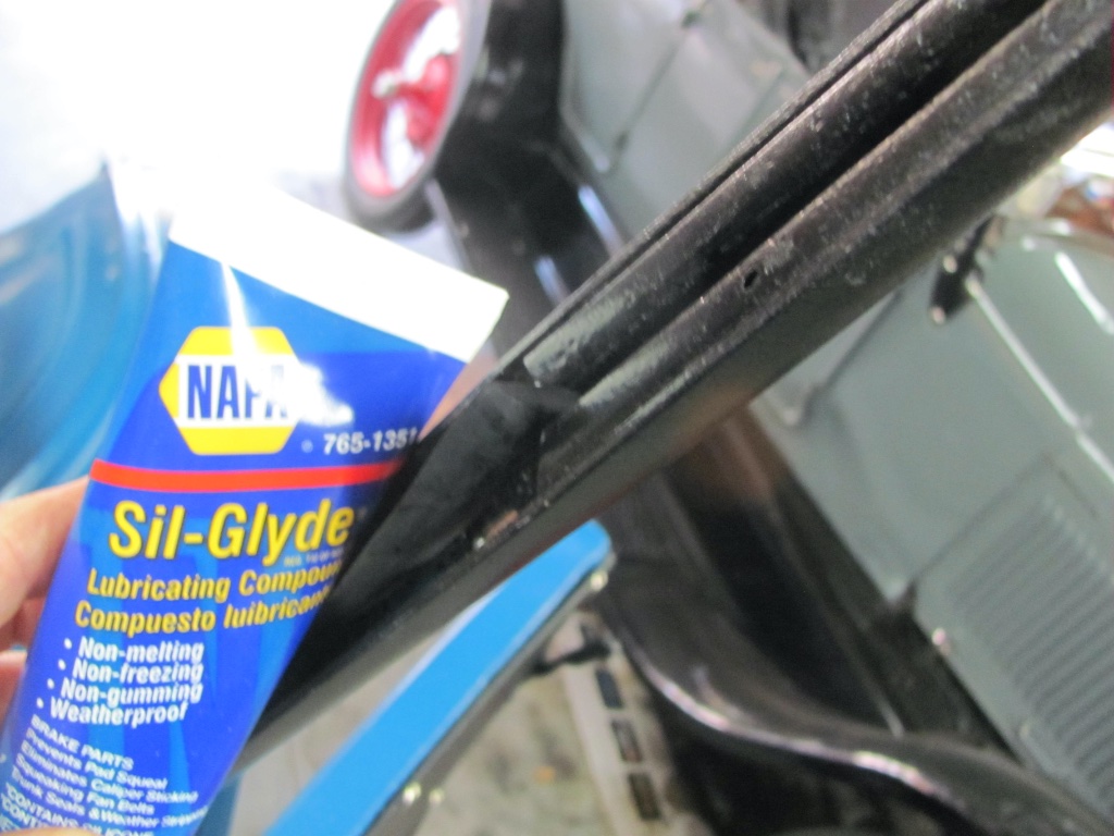

Mopar_man
Topic author - Posts: 1191
- First Name: Robert
- Last Name: Govoni
Re: Instaling Windshield glass
I can't wait to try to get the rubber seal in. I tried just to see how it will go and it looks like I'm going to need my come a long and some grease. Ha!!
- Posts: 4084
Yep, use some lube, and pull away straight into the channel, you'll get it!
Professor Fate
- Posts: 773
- Last Name: S
- Location: Taxachusetts
I used an aerosol spray graphite to lube the rubber seal and channel with great success. It leaves no film or mess.

Mopar_man
- Last Name: Govoni
Will give it a try today!
