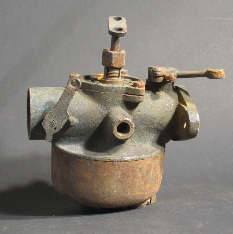

Bruce and the MTFCI Guidelines show the Holley G arriving on 1914 cars. The Guidelines show Patent Pending on the top plate until the end of 1914, then Pat Dec 1914. I don't have a source to cite on this, but I expect the bowl was changed from brass to steel early on, perhaps by the end of 1914. I think the tendency for the brass bowls to crack would have become apparent pretty quickly. Compared to the steel bowls they are scarce, suggesting that they weren't used very long.
The later switch to a cast iron body and the new choke lever of 1919 were not the only changes I consider significant. Some of the bronze bodied G's have a rim around the choke intake, handy for attaching an air filter, and others do not. I don't know whether they were made concurrently, or one came after the other. I chose the rimmed one so I could add a filter. If that's incorrect, TS.
The G has some parts that came in different forms during its six years, but are interchangeable. This means, especially after 100+ years, that your G body doesn't necessarily have its original top plate or bowl.
Choke intake with rim.
Without rim.
