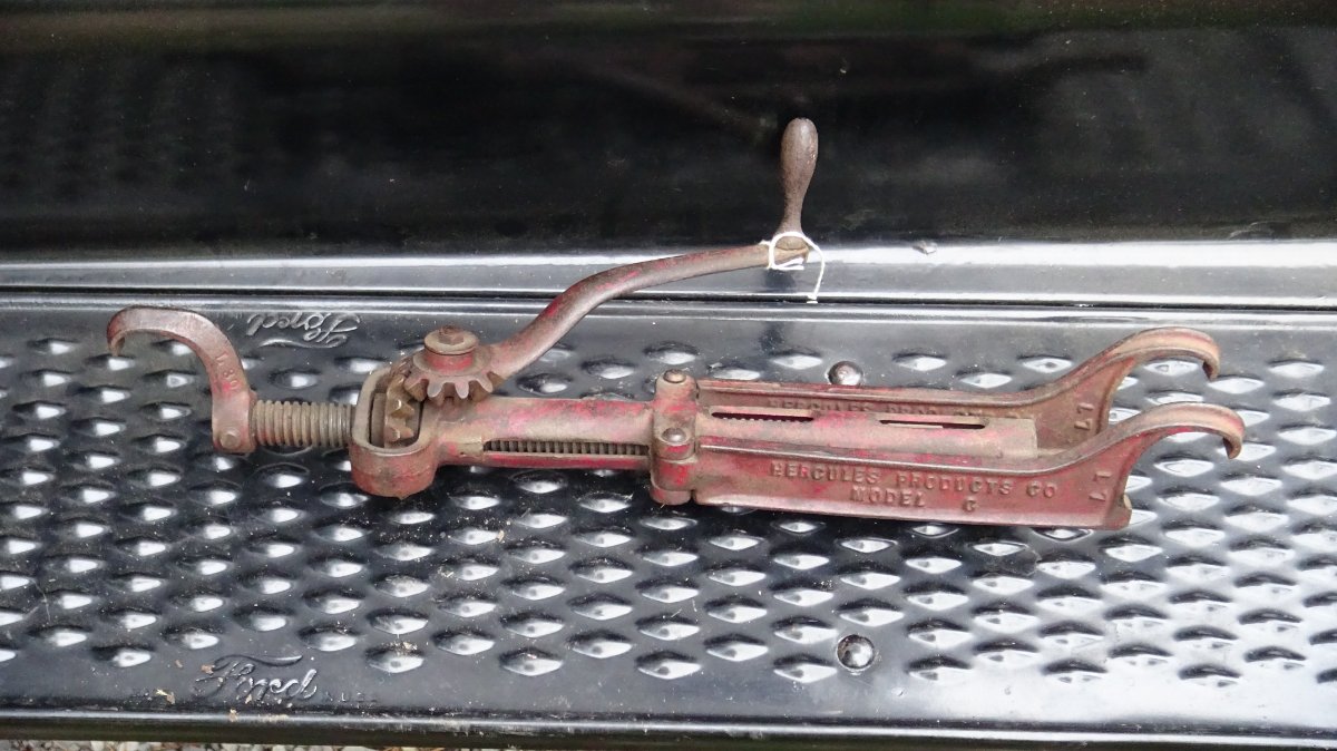

Picked one up at an antique store today, listed as a tire stretcher. I just got done going through past threads, at $22.50 I think I did pretty good.
It appears to be original paint, and what I read tends to agree. A little oil and I think we are good to go!

You got a great deal. That tool makes tire work on split rims a piece of cake.

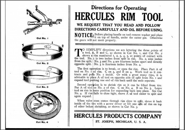

Where do I find proper instructions for its use?
Posts: 6579
Re: Hercules Model C
Post by TRDxB2 » Mon Jul 10, 2023 9:20 am

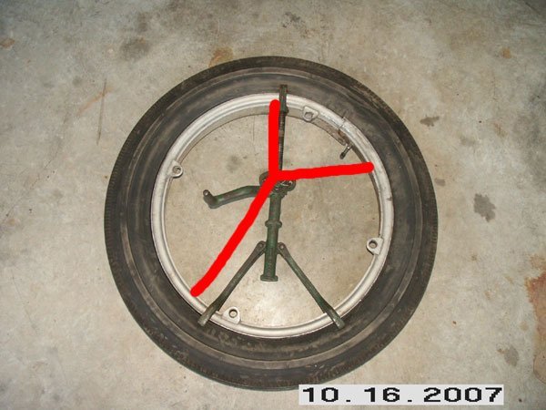

These are general instructions I found
The red Y is to put the rim back in place (from a previous discussion)

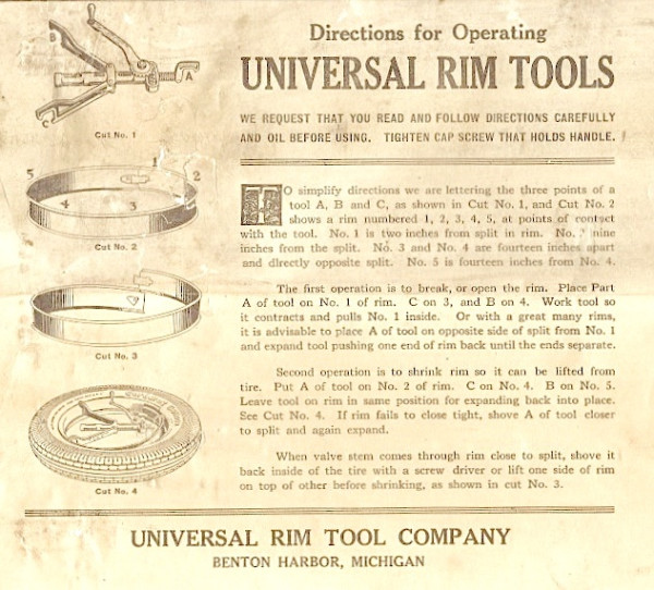

Here is one set of instructions, similar tool.

So basically you push apart with the screw leg just off to the solid side of the tab, then to pull together you flip it so the screw hook is directly across from the split, and the two legs are equal distance from the split?
