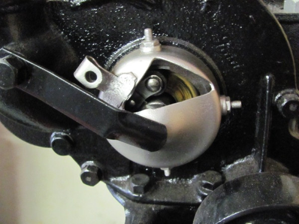

Post by DanTreace » Tue Jul 11, 2023 2:30 pm
Tighten the timer case spring. That's the metal strap held by a hex head bolt on the front plate.

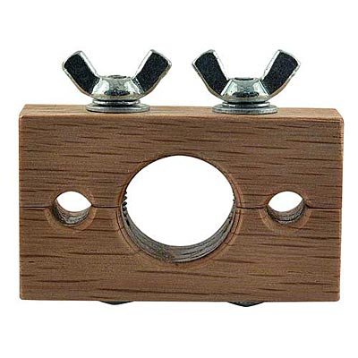

Post by Scott_Conger » Tue Jul 11, 2023 3:31 pm
The "ridges" on the steering column may be worn flat
The springs holding the timing and fuel rods just outside the firewall may be fatigued
The spring holding the timing cover may be weak
find and fix one or more items, but this is made to get past the trouble you're having, regardless of the cause:
timing rod clamp.jpg (28.94 KiB) Viewed 2093 times
all the vendors sell it
install, adjust, enjoy your car

Post by jsaylor » Tue Jul 11, 2023 6:11 pm
The tightening block may not be available. I made my own from some scrap oak and a couple of bolts. I started with a piece of oak 3/4 x 1 1/2 x 3 1/2. (Scrap that I had) The large hole is 7/8", the two smaller ones are 5/16", space exactly 7/8" from the center of the large hole.
Mark it all out first and center punch the centers. Spacing must be exact. ( I used brad point bits)
Next drill two 17/64 holes for the two thru bolts (1/4") with wing nuts. (smaller would work but 1/4 " is what I had on hand.
Then saw it down the middle splitting it into two halves using a thin jig saw blade.
Clamp it on the steering shaft around the throttle and spark rods just below the springs, insert the thru-bolts and clamp it tight.
So far seems to work well. Cost me nothing but time. I did mess up twice by not getting the holes spaced exactly. -- J

Post by TWrenn » Tue Jul 11, 2023 8:37 pm
I tried one of those blocks and it made the rods TOO tight!

I found the block at Texas Ts for $12.95. I ordered it. I figured it was an acceptable gamble . I too saw how easy it would be to make my own. I have the tools and even have a scrap of oak that would work . But for $13 not worth the effort.

Post by Harvey Bergstrom » Fri Jul 14, 2023 11:03 am
I made my own tension block as the vendors were sold out at the time. It works quite well. The trick is to have just the right tension on the rods and if you have it set too tight you will have problems. Relax your tension a bit. Good luck!
