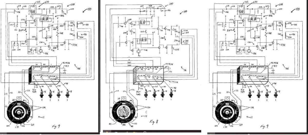

The real problem I have found is that a replacement switching transistor for the timer module has not been found or identified yet.
I have one or two hat were given to me by upset owners.

Jim,
Do you know what the existing transistor is? If not are you able to identify if it's a FET or bipolar (and if the latter, whether NPN or PNP)?
Luke.
- Posts: 6583
Re: True Fire question
Found these for patent application no reference to the numbers assigned to he component
