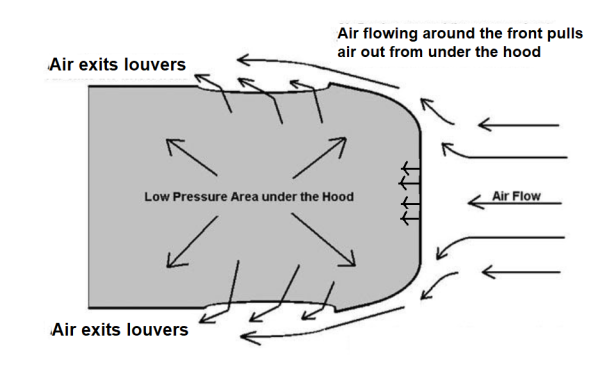

Absolutely not viewtopic.php?f=2&t=34917&p=270763&hili ... ns#p270763kommandant 95 wrote: ↑Thu Jul 13, 2023 9:41 pmI have a newly restored 1913 touring with engine splash pans installed that boils over after a drive regardless of idle time. Does anyone have any experience that points to the pans causing this?
I explained it above as being part of the cooling system. That explanation goes along with why Hot Roders louvered their hoods and why modern cars have pans under their engines now. Without the pans air turbulents result and the the negative pressure zone is defeated. Some people don't use them because they of the effort to put them back on. The "fan" at idle is not very efficient at providing cooling - effiecient cooling occurs while driving at speed. Boil over - radiator issues or coolant issues neither solved with a period correct water pump.
When was the last time ou did a radiator flush?

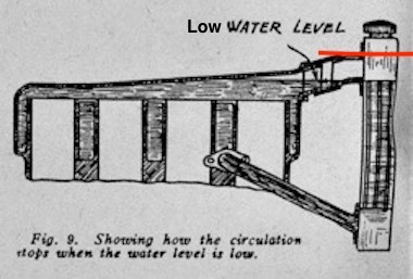

Model Ts that can idle after long run, without overheating must have good cooling system. Boiling over is definitely caused by either very low coolant level, or very poor cooling system, i.e.dirty, clogged or poor radiator or clogged block and hoses.
If boiling over (i.e. steaming), be very sure of adequate coolant level. The T uses the famous 'thermo-syphon' system, but many forget the 'syphon' part. Just like any syphon you do with a hose in a bucket, as soon as the hose is out of the water, no flow. Same in the Ford radiator, if coolant isn't filling the upper outlet, the thermo-syphon will stop. The result is the coolant stays in the block and will continue to heat and reach boiling.
Note red line where coolant level must be maintained

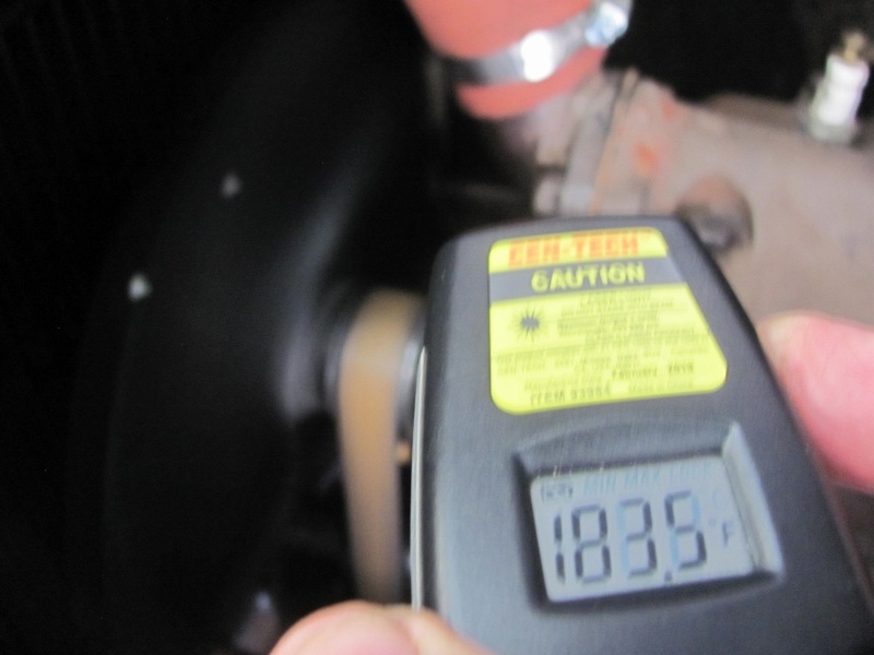

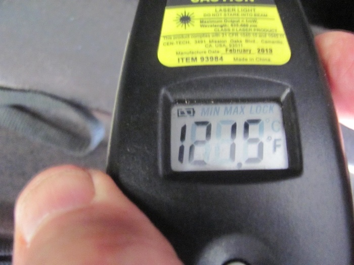

The cooling system of the Ford is easy to check with a simple inexpensive infrared tool, point at the upper tank after engine is warmed up, should read up to 180 or so, too hot to touch. Then point at the lower pipe, should read around 120, low enough that you can touch. The difference of around 70-80 degrees indicates an effective cooling of the system, where the motor is staying around 180, typical for internal combustion motor. And after shut off, the radiator coolant can make gurgle sounds like minor rolling boil, but that is just the system cooling down without air flow, normal and harmless.
