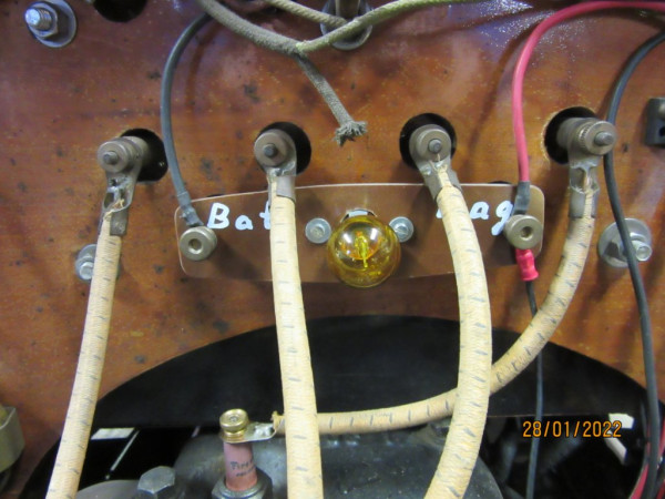

Ron, I made this one thanks to John Regan !!!!

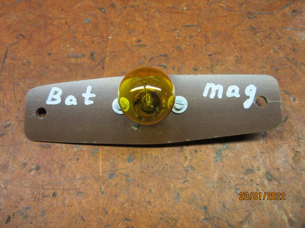

I have a 15 in the shop at the moment, it is fitted with a diode # 70HF60, and no light globe, it's been on the car for years. When I get it up and running I'll check out what it is doing.

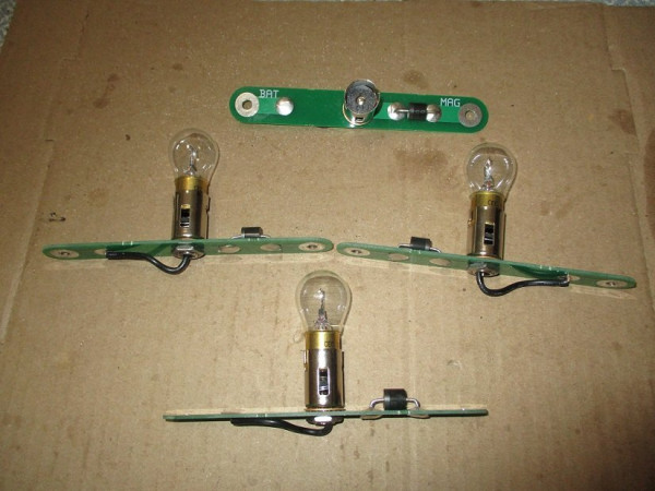

I sought out this particular item becasue of the elegance of the phycical design and its mounting.
Typical John Regan.
I found one. Just what I needed for my new (to me) 1915 Runabout.
