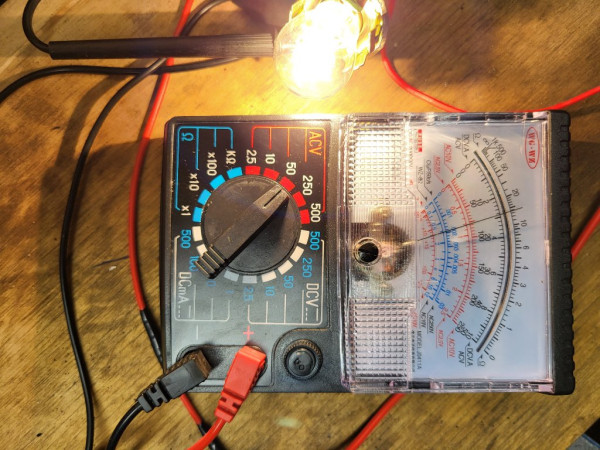

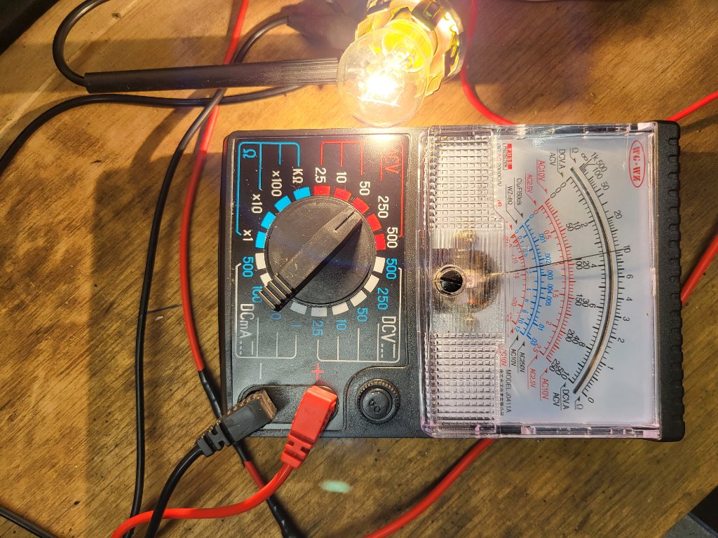

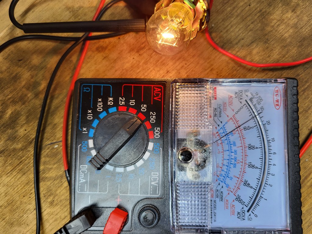

Following all the instructions with the light bulb and analog meter etc. but not comfortable with this meter yet so not sure if I'm reading it correctly.
Please help.
I think I'm seeing 8v @ idle, 16v moderate rpm, 19 fastest rpm.
Sorry about the orientation but it's the only way they would load.
Please help.

pretty much, yep.

Thanks.
So the reason it runs like crap on Mag under load compared to on Bat has nothing to do with the mag...

Peter even though your magneto is working looks like it needs a recharge ...at speed should be between 25 and 30 volts ac. .... When did you last have your coils checked ? ...

Pete, your mag output is not terrible and is more than capable of running your car.
Coils can be made to run on battery and still be terrible on MAG - so, now that you know that, lacking test equipment for them, contact one of several guys who advertises coil rebuilding and send off to be checked. Now that you have messed with point gap, they are no longer adjusted (perfectly) if they were in fact even adjusted in the beginning. Adjusting or rebuilding them correctly will make them sing sweetly on both battery AND mag and you will be amazed at how much better things run. For the price of parts and the level of effort involved, paying a pro is a bargain at what they charge.

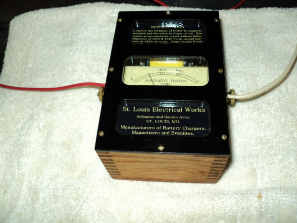

Your 1156 bulb/AC voltmeter Model T magneto test results reflect a puny magneto output.
When I see this type results where the output voltage does not meet or exceed 30 volts at higher RPM I know you need a more comprehensive check
The "Gold Standard" for comprehensive magneto testing that requires no interpretation to determine the "Health" of your magneto is the St Louis Magneto Tesster. It evaluates the magneto results in a different manner and is a go/no go magneto health test.
I suggest find someone who has a St Louis tester, take the readings again and report back as shown in the attyached photo. That wasy we will lnow for sure the health of your Model T magneto.
Ron Patterson
