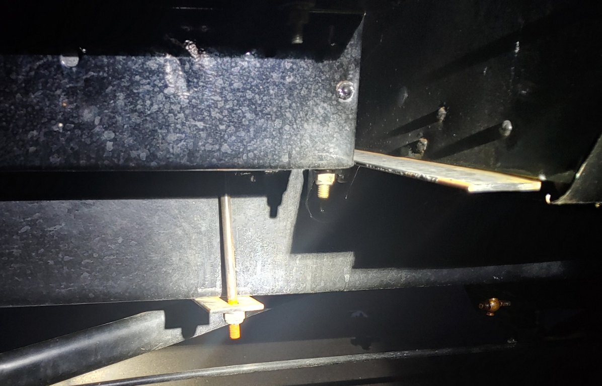

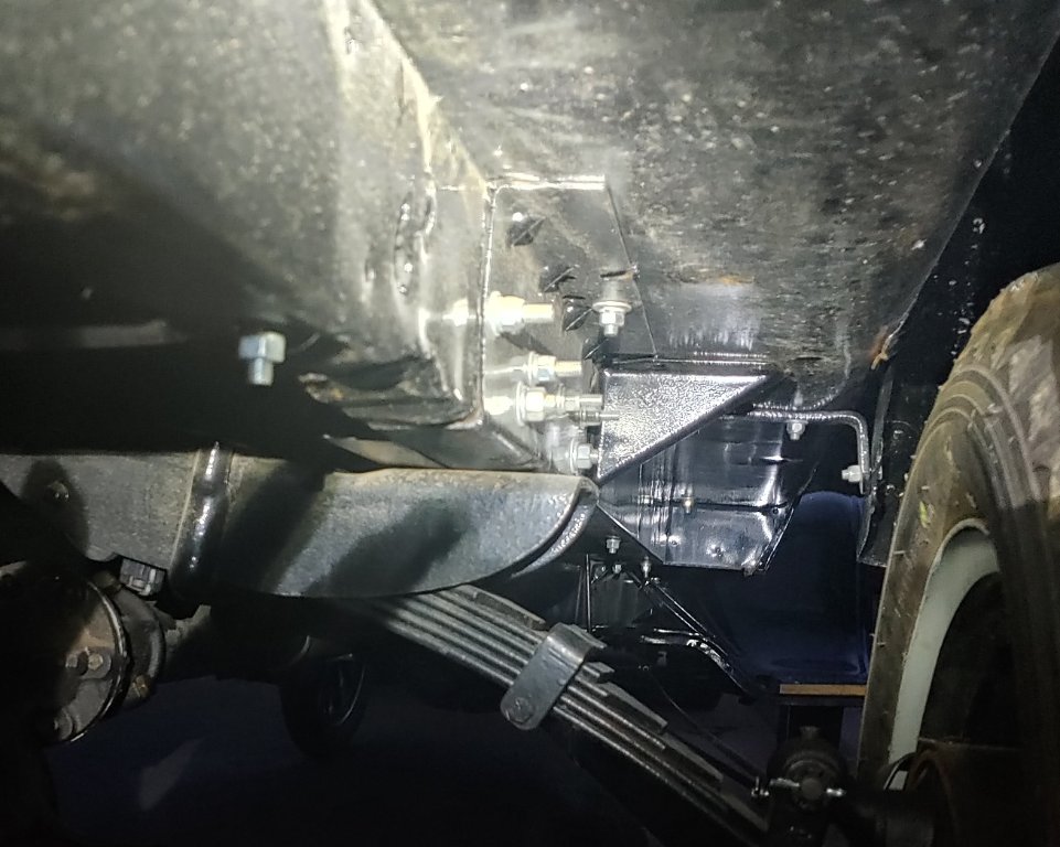

How does the TT express bed attach to the TT frame? Pictures please.

Let's see if this works. This is a shot of the front mount.
The rear is an L bracket on the bed bolted through the frame with one bolt vertical through the frame vertical behind the spring.
Hope this helps you out. Good Luck
This is a shot of the rear mount looking forward
The front is 2 bolts and a cross plate under the frame, one set on each side.The rear is an L bracket on the bed bolted through the frame with one bolt vertical through the frame vertical behind the spring.
