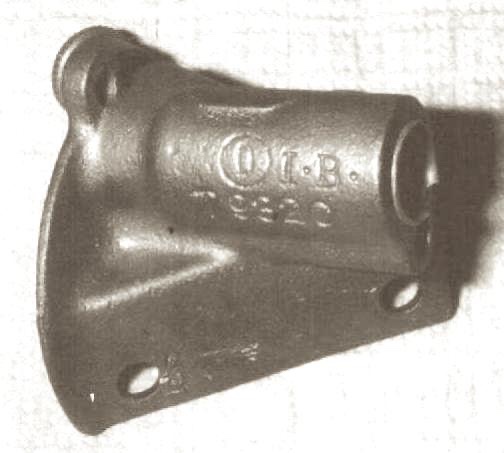

Also be sure the frame steering bracket is correct for your '27 runabout. The cast in number on the bracket should be T-932C.

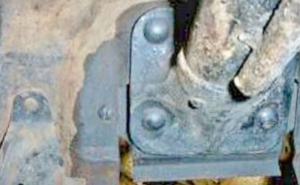

And the firewall bracket is placed correctly for your runabout, that bracket is two piece and has angle to allow column to fit correctly, with the flange for holding the upper floorboard.
