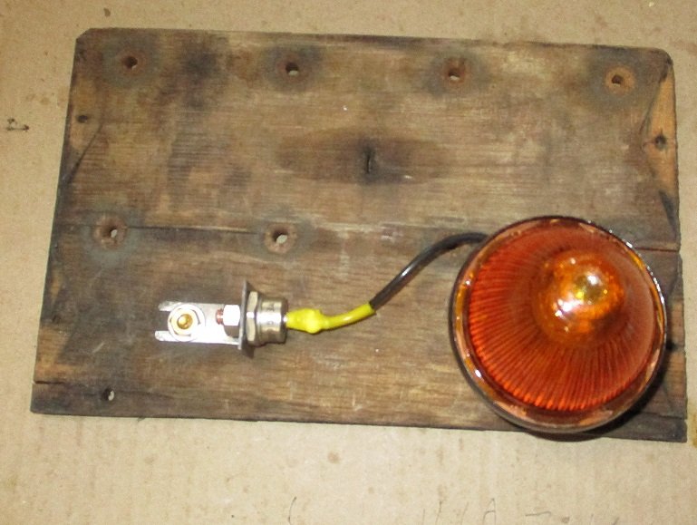

Will the 6 buck generator cutout diode sold by model t parts suppliers work in the battery charger application.
Art Mirtes
J1MGOLDEN
Posts: 1318
Last Name: Golden
Location: Bowie, MD
Re: Magneto Battery Charger
Post by J1MGOLDEN » Fri Aug 04, 2023 6:02 pm
I am about to find out and do not see any reason why it should not work.

There is a 1156 bulb in the light.

I see some lettering on that diode - any chance you could let us know what it is?
FYI the ideal 'cutout' diode would be a mid to high-current schottky type, which is not the right thing for your half-wave magneto rectifier.

The Diode is a 1N1183A and the one that Snyders was selling as a kit with directions and may still sell.
The earlier editions of the MTFCA Electrical book also had that one, if I recall correctly.
Later editions deleted it!
With this one the current flows in the direction of the arrow.
Some of the older other diodes had the current flow opposite of the arrow direction.
I made several Model A Diode Cutouts before I recognized my problem.
I didn't, but John Regan told me, I had to read the diode spec sheet for each diode type.

An original ammeter with two short test leads can be used for a quick test to identify the diode polarity issue.
You clip one lead to the yellow battery wire.
You clip the other lead to the Bat terminal on the Cutout or the connection from the Mag.
If there is any current flow showing on the ammeter, your diode is in backwards and has to be reversed or your battery is in backwards with a positive ground and has to be reversed.

J1MGOLDEN wrote:
Sat Aug 05, 2023 10:29 am
Thanks Jim,
That diode has vastly more capacity current-wise than is needed, however it's potentially close to spec from a (reverse) voltage perspective. While it'd probably work ok it isn't what one would normally specify for the task you're wanting it to employ it in - those that Dave showed would be more like it.
Interestingly it's not necessarily ideal for a 'cutout' diode either. To be clear, it's not that it won't do the job and I'm certainly not advocating you throw it away, however it will have more loss and could generate more heat than you'd get from a schottky type. On the other hand given the relatively low currents involved it's hardly likely to matter much, and I expect they're cheap and plentiful (and robust) so there are compensatory factors :)
Luke.

I am planning to try a diode from a GM alternator. They seem to be robust and reliable. I haven't seen one fail since the 1960s. Does anyone we forsee any problems.
Art Mirtes

Art,
Without a part number it's not possible to say definitively but it's likely to be capable of handling the current draw, whether it'd cope with the reverse voltage over time is perhaps less certain.
Like JIm's component most of these diodes are designed for high-current but low-voltage use, whereas in the case of a magneto charger you have low-current, with a higher applied voltage. It's not a particularly high voltage in the grand scheme, but let's say you get to 30V or 40V input, and/or there are a few spikes on the line as a result of the T's generally harsh electrical environment, and you apply this to a diode that's only rated for say 50V, you're getting uncomfortably close to its maximum...
In circuit design it's normal to over-specify such components in order to allow a healthy margin and ability to cope with minor events where things exceed expected parameters for a brief period. If you've a component that's only just rated for the regularly applied voltage it could well deteriorate over time and fail prematurely.
In your case the diode may be fine, but you need to bear in mind that in its normal environment it wouldn't be anticipated to have more than say 18V applied to it, certainly not twice that. To be sure, if you were able to let us know the part number it may be possible to check the rating to see if it'd be ok for your proposed use.
Luke.
