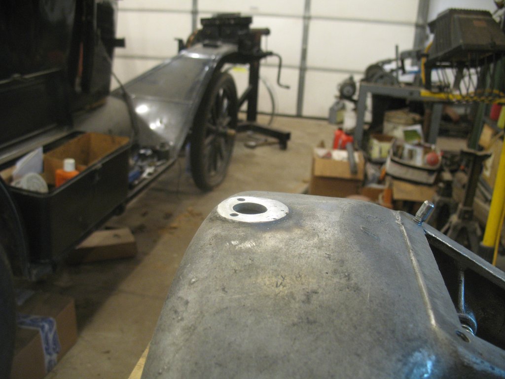

The last time I had the hogshead off my 1915 transmission I found one of the mag post screw holes stripped out. The simple solution was to fill the hole with new aluminum, redrill, and tap. The screws were 10-32, so that's the tap I used. Recently, despite my great care to be gentle, both the other holes stripped out. The one I had redrilled was OK. I intend to fill and redrill the two stripped out holes. But I'm wondering if all three screws stripped out so easily because the ones I used were slightly too small. Is 10-32 correct, or is this another case of Ford using weird fastener sizes? The Colorado list of chassis fastener sizes shows only a question mark here. Anybody know the correct size for sure?

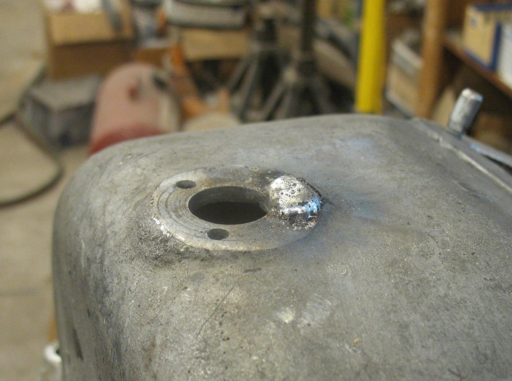

Is using JB Weld a no - no to use on an aluminum transmission cover? I agree that originally Ford should have used a coarser thread instead on a fine thread. Would a self tapping screw work? But of course that wouldn’t be right for a T. Using a 10/24 would be the best way to go.

Self tapping screws dont cut as clean a thread as a good tap. The holes still need to be built up for a new thread. 10-24 would be OK, but if welding the holes up, might as well stay with the original 10-32. Tapping for a 12-24 screw would require modifying the mag post & probably the screw head diameter. Jb weld would possibly work. My second preference to welding the holes would be to use heli-coils.John kuehn wrote: ↑Sun Aug 06, 2023 1:24 pmIs using JB Weld a no - no to use on an aluminum transmission cover? I agree that originally Ford should have used a coarser thread instead on a fine thread. Would a self tapping screw work? But of course that wouldn’t be right for a T. Using a 10/24 would be the best way to go.

I was thinking along the same lines as John - weld the oles closed, redrill them, tap for a helicoil, and use helicoil inserts to give that old aluminum a bit more bite. Not sure if or why that might pose a problem, but considering that aluminum has 100+ years of corrosion, vibration, and fatigue, that poor hogshead needs all the help it can get!

The original 10-32 hole was good enough for several decades, and the one I already fixed with new aluminum is fine, so I expect I will do the same on these other two. I can't rotate the post. It has an oil line.
