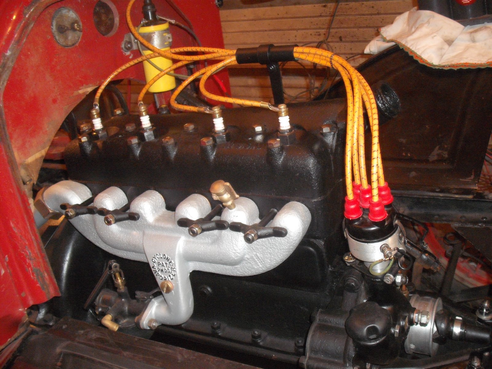

Here is the possessed engine

I keep looking at that brass "gizmo" that's screwed into portion of the intake manifold that feeds number #1 and #2 cylinders. Doesn't seem like this could be related to your starting problem, but I'm wondering if you might have a vacuum leak due to that "gizmo" that somehow interferes with proper "flow" within the intake manifold.
As an "aside" here, before anybody make an "issue" of the unconventional accessory one-piece combination intake/exhaust manifold, I use a WILMO combination manifold on one of my T's, and I remember that Royce Peterson uses an ANCO combination manifold on one of his T's. In my case, my WILMO combination manifold works very well and Royce said the same thing about his ANCO combination manifold. FWIW,.....harold

Donnie, That brass thing at #1- #2 intake is odd, it could have been installed by someone due to past hard start problems. It could be something like a crack in the manifold in the common cast wall between intake and exhaust towards the front of the manifold, the heat riser wall. When the engine is cold this crack is disrupting the proper intake flow at slow hand cranking speed. Try replacing the manifold with a known good stock intake and exhaust manifold. If that doesn't fix the problem you can still leave the stock manifolds on the engine.

The two "brass gizmoes" on the "Cyclone" are a priming cup and a plug installed where some other item had been installed in the past. More than likely the "plug" is where another "primer" of some type was installed. ?? Both items do not leak. I have tested both of them for leaks. By placing some gas in the priming cup when it is in the closed position and the engine is running, there should be bubbles or gas should be sucked into the engine if there is a leak. There is no sign of a leak. I have also checked the plug (gizmo) for leaks by spraying WD-40 around the plug. If there is any leak, the engine will speed up or the WD-40 will be sucked into the engine. I also checked the rings and glands that seal the manifold to the block. No sign of a leak at any place.

Tomorrow is another new day, Ill approach the issue from some different angle to see what happens ... Thanks again for the support ..

Since you changed the manifold and ignition it is no longer the "known good running engine" . Different perspective - since you can get it started with plug #1 out and see it sparking I would eliminate electrical and fuel system issues. The reason I say that is if the #1 plug fires while out and the engine starts - the electrical system isn't smart enough to know the difference. So I'd focus on what effect the open plug hole might have on a cold engine. Would it affect the air / fuel mixture? Would it eliminate a vacuum leak? How would it effect chocking? What carburation does the "Cyclone" intake manifold require (couldn't tell if you ran this before)? Is the NH providing enough air / fuel at startup?
You could also eliminate concerns about the brass priming cup by removing it and plugging up the hole. Hope this helps

The number 1 spark plug being out is ionizing the air which helps with the combustion. :lol:

Coming in at the tail end here........yes, a condenser (capacitor) can go bad, most certainly so and cause all kinds of havoc. There's a crude but simple way to test this. What color is your spark when the plug is outside the engine? Is it "fat" and blue, or sort of white and spindly looking? If the latter, replace the condenser and test again.

One thing to try - with the engine setup to do a successful cold start (#1 plug out and connected to show spark) with another plug in #1 to plug up the hole (don't connect it to ignition system). 2:1 it will not start unless you take the dummy plug out

Had a little time to work in the shop again.
Yesterday I tried a cold start and no luck. Crank, crank, crank, .... nothing. So I reset the points to .018 and tried again, No luck with the new setting. I have had the points set at .015 and it seems to be OK when warm. So I reset them to .015.
Then I tried to start it with #1 plug out on the head and the hole plugged with a dummy plug. It fired right up.... TRD, you would have lost the bet at 2 to 1 odds :) :). So it seems like the hole being open is not the issue ....
Later that day after it cooled off I tried the test of removing #3 plug after another no start when cold. I laid it on the head with the hole open and two cranks it fired right up ??????? So the weird start issue just moved to #3 plug and seems like it does not just apply to #1
Then today when my son came by, we went out to double team it. :) :) We did the crank, crank, crank, thing and no luck. Tried choke, no choke, spark adjustments, throttle adjustments, ect. We pulled the plug to look at it. It still seemed dry to us. So just for the heck of it I opened the high speed needle up one more full turn. It has been running best at 1-1/4 turns open. That is a little more open than most engines use. I usually find that 3/4 to 1 turn open is normal on the carbs I have rebuilt. So with the needle open 2-1/4 turns I got the first cold start :) :). I had to turn it back to 1-1/4 turns open to get it to settle down after warming up a bit.
This evening after it had cooled off again, I tried it at just 2 turns open and no luck, I opened it up to the 2-1/4 turns and it cold started. So I may be finally finding the "sweet spot" I have never worked on a car or carb that needed 2-1/4 turns open to start. Im wondering if the "Cyclone" manifold needs the carb jet to be "very rich" to start and then "leaner" to run. ??? I have never ran a combination manifold before, but they were designed to run the poor quality gas of the time ... So maybe they have different needs as to settings ... ????
I think I see the light at the end of the tunnel .... thanks for all the input and support.

Just wanted to do one more post before I let this rest.
I tried another cold start today at the "normal, for this engine, carb jet settings" (1-1/4 turn open) and no luck. So I opened the main jet one more full turn. (2-1/4 turns open) It started the second pull. After about 10 - 15 seconds the engine started laboring a little. So I turned the needle back to 1-1/4 turns open and it settled right down to a perfect sounding engine. (as perfect as a T can be :)) I guess I finally have found its sweet spot to start and then run.
In all my years of working on Ts, I have never had or seen a T engine that needs the carb needle 2-1/4 turns open to start. It must have something to do with the way the "Cyclone" intake breaths. ???? Who knows ?? So for now we (me and the T) have found our "happy place" Thanks again ....

Donnie, I'm still struggling to understand what difference having one plug removed could make. Do you suppose you were simply able to spin the engine a little faster and that additional suction through the carb enabled better choking action ?
You didn't mention it (or maybe I missed it), but is this the same "known" carb that you had used previously ? Did you overhaul it or otherwise work on it before installing on the current engine ? I'm wondering if the choke plate isn't quite closing off to give you a strong suction ?

The 1 1/4” carb setting for Model T’s are meant to be for a stock engine setup I would think.
When changing the carb, intake system and etc things might change to my mind as far as settings go.

Dick, I am at a loss for "why" the plug being removed made any difference. It may be one of those things we never know ?? I do not "spin" a T engine to hand crank it. I do a 1/4 turn pull up and that is it. It is possible to pull the 1/4 turn quickly but not to spin it the way I hand crank. I have seen folks grab the handle and try to spin the engine a couple revolutions, but I only pull it up "one spark at a time". If my engines do not start with a 1/4 turn pull, I want to find out why ....
A starter motor may have started the engine by being able to spin it and suck in more gas at the 1-1/4 turn needle setting. ?????? But I do not have a starter installed on the engine, so I can not say if it would have helped or not.
The carb is the same carb I always use for testing other folks cars and it is my "spare" carb I carry on tours. It has never failed me before ... and I did open it up and inspect the inside, just to make sure it was still OK. The choke plate is in perfect order.
I plan on rebuilding an Air Friction carb to use as the permanent carb for this 14 speedster. I have never rebuilt an Air Friction before, or even ran one of them. Very few folks have a car with an Air Friction carb. even though thousands of them appear to have been sold and ran. So I wanted to make sure everything is right with this engine and that the distributor as well as the Cyclone manifold is running OK before I wade off into some unknown carb adventure :).
It appears to me that the "Cyclone" manifold may need a very rich setting of the jet when cold. ?? and then more of a "normal" setting when hot. But that is just speculation on my part ...
I did another cold start this evening. I opened the jet 2-1/4 turns and it started on the third pull, without choking it any. The temps were about 85 degrees today, so no choke is really needed. after a few seconds I set it back to 1-1/4 turns and it runs very well. After being warmed up, I can start it with one finger pulling the crank its 1/4 turn. I have the idle screw set to a low idle, with the throttle fully closed and the timing retarded fully, you can almost count the cylinders firing. I do not usually run the engine at that low of a rpm, as its not really good on the crankshaft, but if it will "count them off", that is about as good as I can get a T to run. So for now we are at a "happy place" in the hills of Arkansas.

Next time this happens, leave the plug in and wait about the same amount of time it would take to remove the plug and lay it on the head. Then try starting it again. If it starts, the problem is not in the ignition.
You didn't say, whether or not you turned off the gas when it was parked, and then turned it on again before you started it, but This is what I think might have happened if you did turn off and on the gas. When it was off, the gas in the carburetor drained out. Just a very small leak around the nut at the bottom which holds on the bowl could overnight drain the float bowl. Then when you turned on the gas, it took a while to fill the bowl up again. Result, you had no gas when you first tried to start it, but after a few minutes the float chamber filled up.
That might not be what's causing the problem, but worth checking.

My theory for why the engine starts with a plug out is, By removing the plug, that cylinder drops out of the system. By removing this cylinder and it's draw on the carb and intake allows the remaining cylinder on that intake runner to get a double shot and enrichen the mix and start. This is why it doesn't matter which plug is removed. JMHO.
