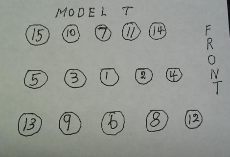

Retorque...look at it this way...bring it in way tight to begin with and you may have no room to draw it up tighter later while at the same time you might run the risk of stripping a block tap (my standard advice for the 50 #--ft and over crowd.) I don't use a torque wrench, but believe that I pull them in somewhere between 35-40 and usually no leaks or weeps or real need to draw much tighter after a heat/cool/ cycle and one retorque seems to nail the occasional errant.
Bolt sequence...now that could go on for days as there are in fact many ways recommended, even by Ford! Don't forget the premise...walk out any flutter in a way that does NOT pinch the thin areas between. Here is the late Herm K's way...
Screen Shot 2023-08-25 at 9.36.45 AM.png (114.34 KiB) Viewed 2184 times
