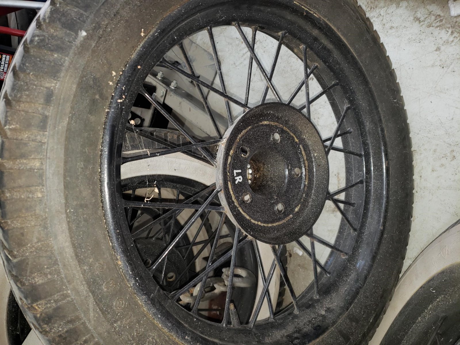

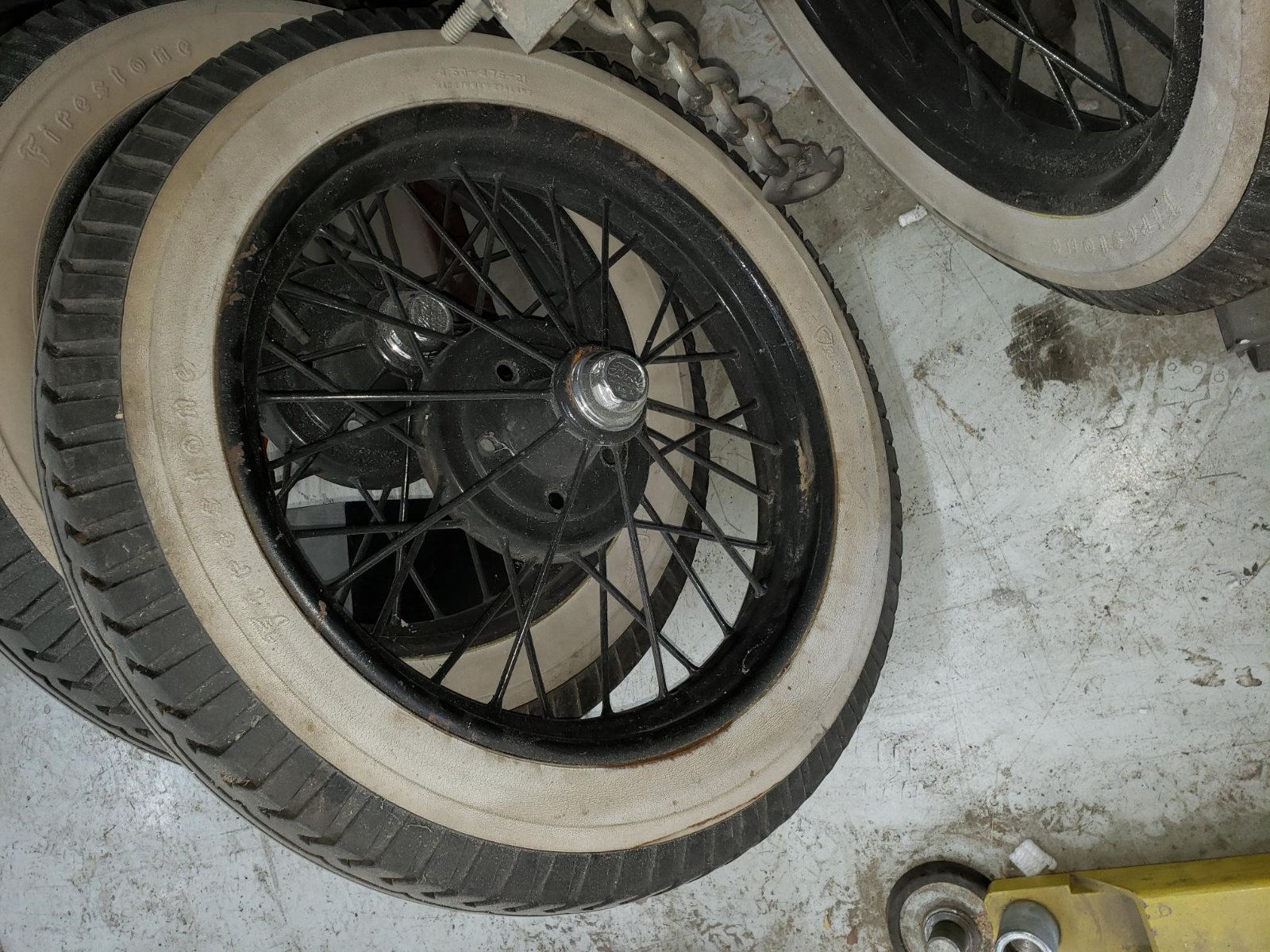

Instead of using the spoons, I'm wondering if anything in the modern tire world would remove these tires from these rims without damaging either one.
Let me know of anything I should look for, or ask at a tire shop.

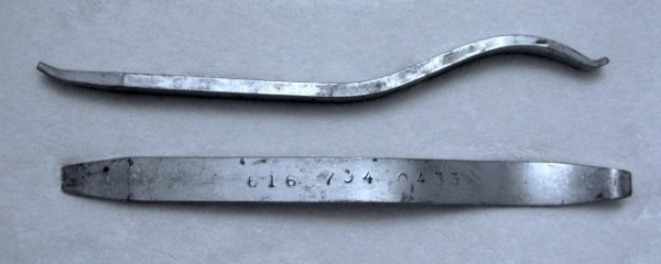

For those changing clinchers, I recommend relegating the original Model T irons to display status. For actual work I find the HF 24" long irons much better. The little short Ford irons make an easy job hard.

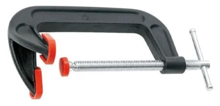

First, you need the right tools. _These include corn starch (because breathing talcum powder is unhealthy), two or three giant C-clamps, a pair of short tire irons, a big, heavy, dead-blow, rubber mallet, an electric tire pump and the Sun.
I've heard horror stories of old, hardened clinchers (particularly Ward's Riversides) that were so stubborn to remove, they had to be sawn off. _I've had to peel off old Riversides and yes, they were hard as oak, but Archimedes knew a thing or two about leverage and screws, and the principle works beautifully in the form of two or three big ol' C-clamps.
They're geared down low enough that you'll only get a 16th of an inch of movement per half-twist, but brother, their mechanical advantage is irresistible. _The bead will break.
There once was a kind, elderly couple who manufactured and marketed their own design of tire irons especially for the Ford Model T.
Unfortunately, the phone number they had stamped into their irons no longer goes through, so I suppose the best that can be done now is to try to find a set of irons that approximates their shape and size. _They measure out at 9 7/8".
If the tire irons you purchase have any square corners or are anything but dead smooth, take a file and then some emery cloth to them.
