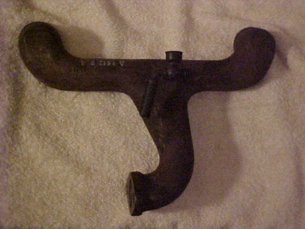

This is my 1914 iron intake manifold cast using the mold for the Aluminum intake manifolds.
Yes, a previous owner added the priming cup.

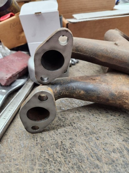

While this post is not directly related to the topic, can anyone tell me how you determine the difference between High Volume Intake Manifolds from the standard intake manifolds?

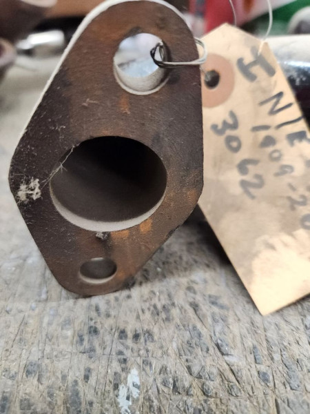

Dom, check out the hole at the carb flange end. The difference is easily noticeable. With the more restricted later cast iron manifolds, that hole is always chamfered from the carb flange face into the smaller cast hole in the runner. The high volume aluminium and early cast iron manifolds do not have this chamfer, as the hole is large at the flange face and this continues into the runner, so the machining operation to create the chamfer is not needed.
If you can get them side by side, the high flow manifold is bulkier looking. If you put your index finger up the two holes you can certainly feel the difference. Watch out for venemous critters on the second check!
