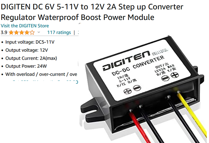

Can we start from the beginning of what your goal is rather than jumping to possible solutions?
You said you want to add a wireless O2 sensor, temperature gauge and tachometer & running headlights, tail, brake & running lights.
Best to understand the total load on the electrical system from each component since there are options to go mechanical, 6v or 12v.
Keep in mind that many gauge's voltage specs are related to illuminating the gauge's bulb and not necessarily its sensor. In that case a 12v can use a 6v bulb or none to eliminate the load on the system
The following is just for estimates and others to chime in choices & calculations
The temperature gauge can have a mechanical sensor vs an electronic one.
Not sure what O2 wireless sensor you are referring to. The one noted below uses a 12v bulb but the sensor wasn't noted likely much less
A narrowband O2 (Oxygen) sensor only reads either rich or lean of Stoichiometric. Stoich is the ratio to completely combust the fuel. So a narrowband will only read rich or lean. It does not tell you how far away you are from Stoich.
Don't know what tach you have in mind but likely not much to drive it, just the illumination issue.
Lights can be the major draw : 2 headlights, 2 rear taillights, daytime running lights (use headlights on dim)
System load estimates
4 filament bulbs 8 amps
4 led bulbs 4 amps
6v to12v boost converter with 2 amp output to drive sensors 4 amps
so either 8 or 12 amp load depending on bulbs
Charging a battery needs volts charge it (voltage regulator) available amps determines the length of time to charge (trickle charge vs Engine starter/charger.
So do the math or just settle for an 12v alternator
