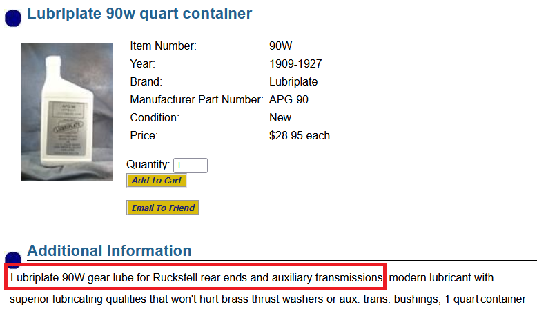

It has 600W lub.

Oil filled to the plug? or the mistake of 1-1/2" down like what is recommended for early diffs?

Re: Has Anyone Experienced This?
According to the rux build book 90 wt is preferred. 140 for a stock rear end. Not confident the thicker lube will get into the rux inners. I have always used 90 wt. Not had an issue lubricating. MHO. When I fill the rux for the first time, I try to squirt oil into the carrier bell thru the outer slots.
- Posts: 4692
You're correct. 90 it is. I should have consulted the manual. I have Ruckstells in all of my T's.
- Posts: 6475
From Lang's
