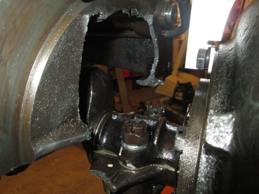

I have seen a block on which the web over the third main had been cracked or broken and had been welded up. The engine was still running and we thought when the big bang came that the crank had broken. Unfortunately, the driver lost his brakes when coming up to a signal and he hit the reverse pedal to stop the car. Then the reverse drum shattered. We replaced the transmission and saved the engine which still ran fine!

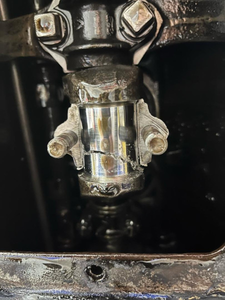

Just more fuel for the fire. We had two crankshafts on two different cars break in #3 Rod journal in the same place on the same 3 day tour a few weeks ago............the angle suggests a torsional failure but........... both engines would still run due to the break being held together by the connecting rod. Just a little rattle........
run
run

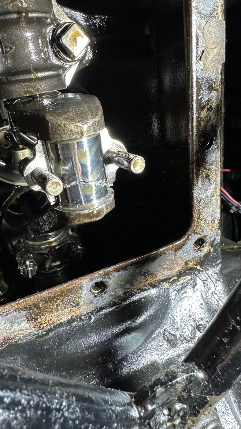

Re: WHY DO T CRANKS BREAK BEHIND #1 ROD?
That crank looks familiar…
A new Skat crank and 1 rod later… it’s back on the road!

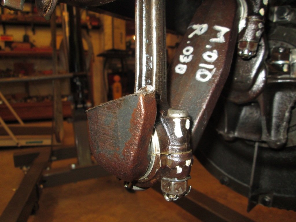

Then there was this one - 5 y.o. rebuild - low mileage speedster.

- Posts: 7296
The post about the repaired block and the last one with the broken rear web are indicative of a particular problem, especially on early blocks. The land on which the third main bearing bolt heads sit is machined flat to take the bolt heads, but this machining creates a perfect sharp stress riser between the bolt head surface and the vertical edge of the block. It is not uncommon for the back web in the block to break out. On occasions this break is attributed to a broken crankshaft doing the damage. This is not necessarily the case. That web letting go takes the crankshaft with it.
I have seen a 19 12 block which was removed from service before it let go. The crack emanated from the bolt land down either side of the web, but for some reason it was discovered before it broke out. I had that block welded and it was also returned to service.
A 1912 mother-in-law roadster in our club was not so fortunate.
A 1923 engine came to me with a broken out rear web and crankshaft. On inspection, the crack starting at the bolt land had clearly been "working", as the break surface was polished. Only the last little bit of the final breakout was a clean break.
I never begin work on a block now unless it has been crack tested, with particular attention to the rear main web.
If you bust out the rear web, check to see if yours might also be the precursor to a broken crankshaft.
