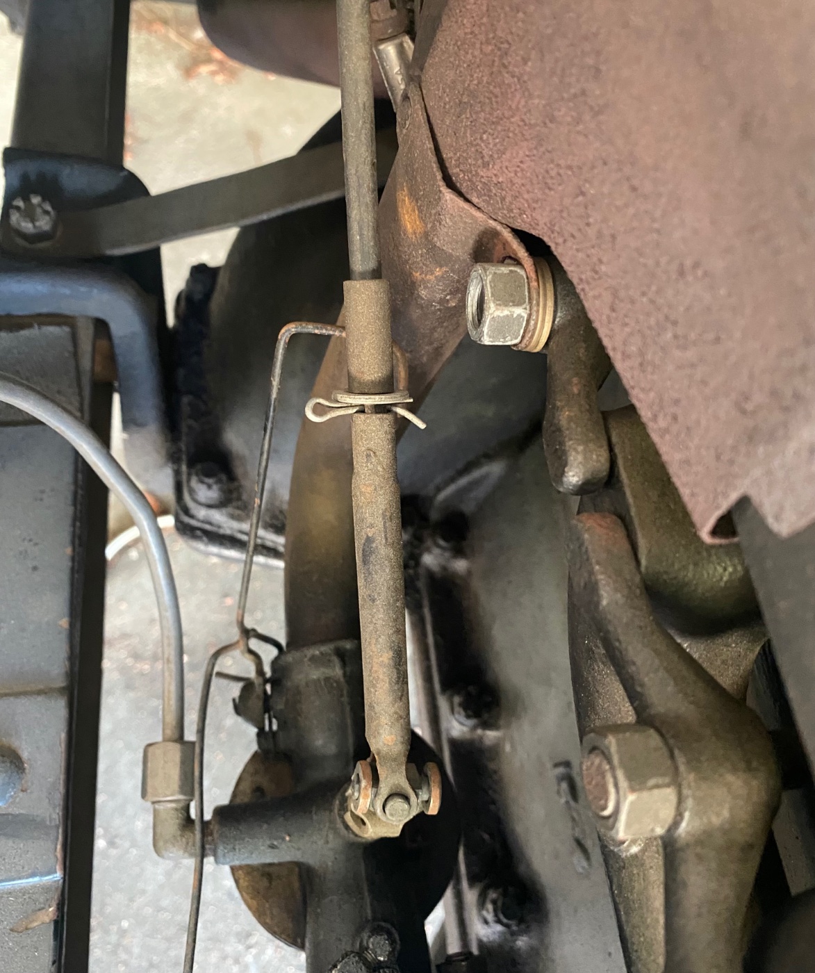

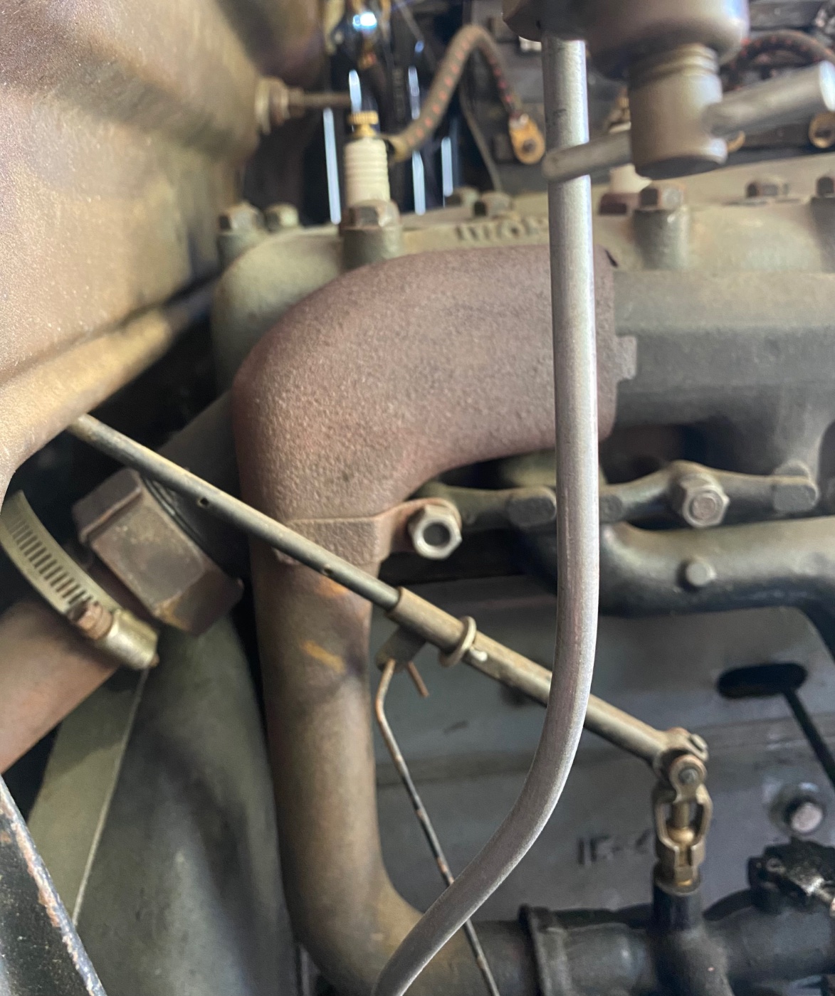

Bill - here are pictures of my ‘26.

Absolutely AWESOME!! You answered all my questions with 2 pics!
Thanks very much! Just another demonstration of why this site is so valuable to Model T people!!
