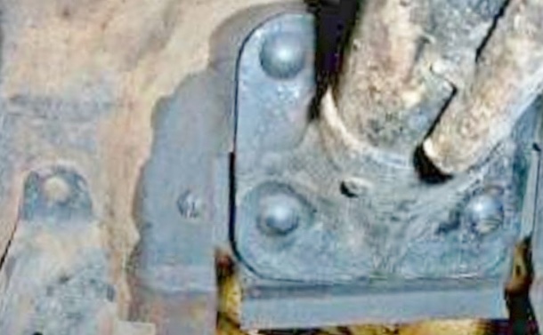

With new rods, were new springs installed too under the cupped washers?, could be they aren't compressed enough to allow full length extension, check if the new rods are standing above the quadrant under the wheel.
Also be sure the frame steering bracket is correct for your '27 runabout. The cast in number on the bracket should be T-932C.
c part 26-27.jpg (43.78 KiB) Viewed 2282 times
And the firewall bracket is placed correctly for your runabout, that bracket is two piece and has angle to allow column to fit correctly, with the flange for holding the upper floorboard.
