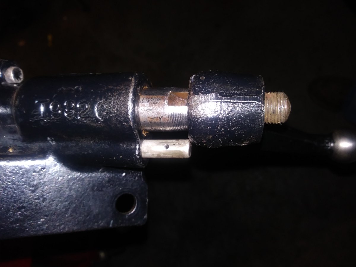

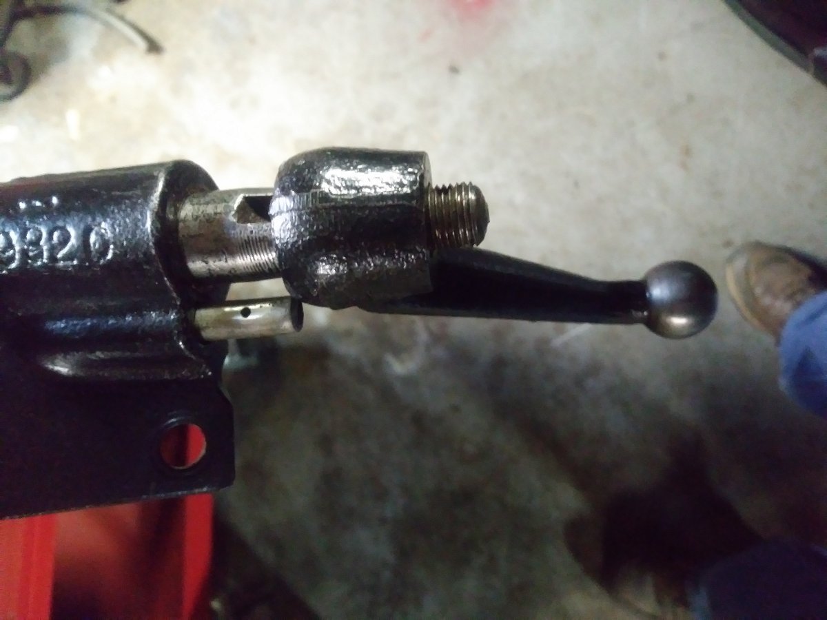

I'm rebuilding the steering column for my 27 Roadster..new paint..bushings and spark & throttle rods. As you can see I can't get the Pitman on because the spark rod is to long ! It looks like I need to at least cut the rod up to the pin hole ?

Your bracket is pushed too far up the shaft !

But, I can see where there might be some interference which there shouldn't be ?

This is a discussion of the same problem I believe which may have the answer. I not I hope someone who knows will chime in.

Make sure as was suggested in the link that the pin is in the slot in the housing and also the long pin is in the correct hole if they have been replaced.
