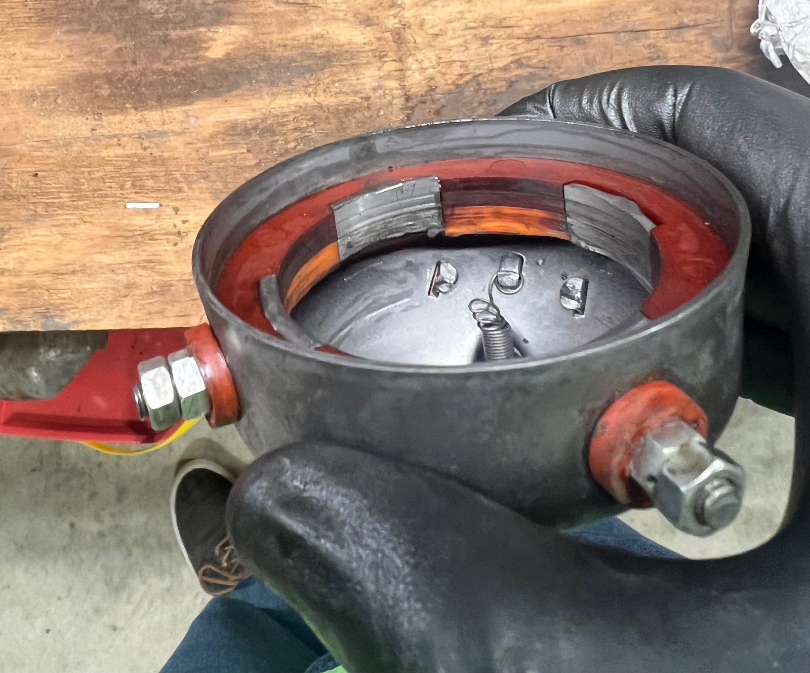

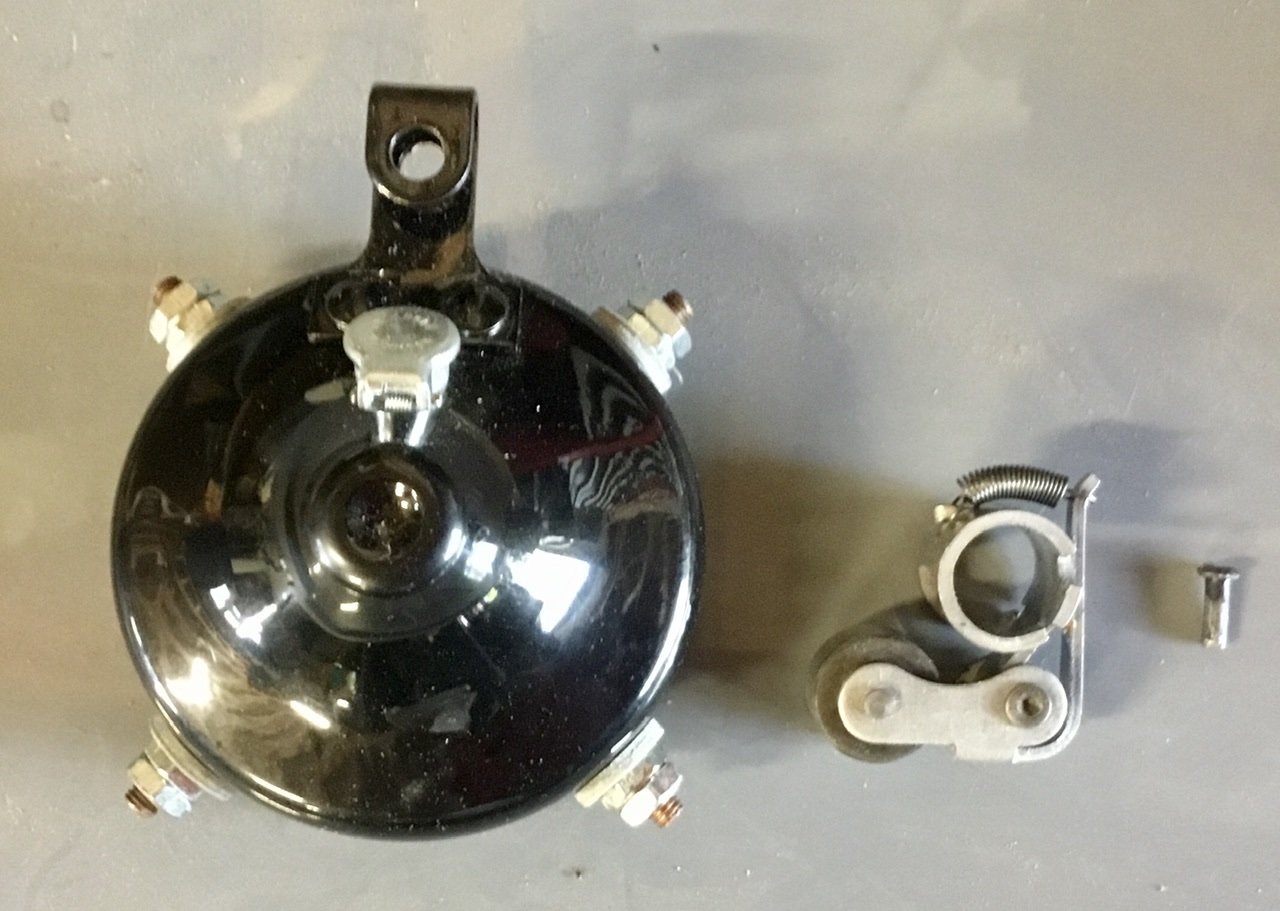

Just got back into the house from the shop. Here are some photos of the timer after I took the housing off and cleaned it up. I noticed a lack of any type of lubricant and TONS of metal shavings. I cleaned it out a bit and took some photos. I do not know what kind it is, you'll have to forgive me as I am new to this. This is my first model T.
With the little research I've done, and just common sense, this looks pretty...not okay.

I recommend purchasing a new timer. If you can afford it the best timer is a electronic solid state one. Next best is a brush type and lastly is the standard roller timer.

Make sure there is no metal shavings behind the insulator ring. Oil the roller & put it back on. See if the mis is gone.
If it runs OK do so..... (while you wait for a new timer.)

I'd say the timer could be the source of your problem. Tip Top Timers of Spokane Valley make quality New Day and Anderson reproductions. Give Mark Hutchinson a call and talk it over...‭(509) two-two-zero-0892‬

Your roller timer needs to be replaced. A good cleaning and using a light grease may get it to run OK and you can try it and see. Believe it or not “wayback when” owners would use a rat tail file and file the inside contacts smooth then go around the entire timer to level and smooth it out. Some would call it a farm fix but it would work for a while! Good luck.

Those deep scratches inside your timer could cause the roller to bounce and are almost certainly the source of your misfire. I purchased my roller type timer from Snyder’s. It looks just like the original, is well made, is made in the USA and my T, which I have had for 53 years and has used a half dozen different types of timers over the years, has never run better. I highly recommend it. Part #T-3165, $69.95. I lubricate mine with a mixture of Vaseline thinned with 3 in 1 oil wiped around the contacts ring with my finger. Be careful of the oil or grease you use and be sure it does not contain conductive (electrical) elements such as graphite or molybdenum or it will ground out. It needs to be totally non-conductive on Model T electrical components. Jim Patrick
