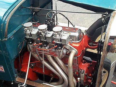

Post by Erik Barrett » Wed Oct 11, 2023 11:04 pm
This one has pretty good V.E.

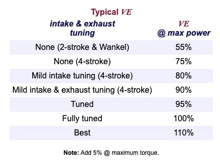

Post by henryford2 » Fri Oct 13, 2023 8:50 am
Sorry, I may not have been clear in what I was asking. The attached is a comparison chart of relatively new engines (assuming overhead valve). The information I'm looking for specifically is a comparison of engine construction types, L head, F head, Overhead valve, etc. specifically the Model T engine. I've found a VE of approx. 57% for the "flathead" Ford, and for a lack of any better information I'm going to use that number. Thanks
Posts: 8705
Re: Volumetric Efficiency of Model T engine (L head) ?
Post by TXGOAT2 » Fri Oct 13, 2023 9:43 am
A T engine would be lower on the VE scale than a Ford flathead V8. Performance modifications will improve VE. As a type, the L-head or flathead engine is at the lower end of the VE scale. VE is affected by a wide range of design factors as well as operating conditions.
Some idea of an engine's VE can be deduced by comparing horsepower and torque curves to an engine's displacement and operating speed range.
For instance, a 177 cubic inch Model T engine is rated at 20 HP at about 1800 RPM. The very similar 200 cubic inch Model A engine is rated at 40 HP at about 2300 RPM. The Model A design obviously has substantially higher VE, mostly due to improved manifolding and cam profile.
A 1938 flat head Ford V8 of 221 cubic inches is rated at 85 HP at about 3400 RPM. Improved VE plays a large part in the improvement.
Many modern day naturally aspirated engines develop well over 1 HP per cubic inch of displacement. These are typically 4 valve, high compression engines that operate at comparatively high RPM.
Most any engine's VE can be dramatically improved by selective modification or by forced induction.

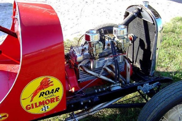

Yeah, as you are eluding to, now you are entering a zone where theories do not cross over. Most Stromberg carburetor numbers you read about are numbers that the factory gave for sizing air flow in CFMs, ...however not fuel & air flow. In other words, they could flow air & fuel in an economy environment, but could not keep up in the higher RPMs. To elaborate on this point, a Stromberg 97 has a theoretical air flow of around 150 CFMs and were sized by Stromberg for the new Model 40 & 48 Ford V8s with 221 cubic inches. So theoretically the 201ci Model-A/B engine which was about 10% less displacement but had a more lift & duration than the 33-36 V8s, should have been a happy camper with one Stromberg 97. The reason so many dual carb intakes were offered in the day was that one carb could not provide enough fuel & air in 3,000 - 3,500 RPM range.
FWIW, back when I was vintage car racing, I had several speedsters and a big car that two 'built' 94s could not keep up, -and my track roadster with an OHV needed three 97s to keep up. Therefore, depending on what you are building and how you plan to drive it will likely see yourself needing a larger carburetor. One other thought to ponder, a stock T is around 176 cubic inches. A small block Chevrolet 350 engine is about twice the cubic displacement, ...and the factory shipped most of those engines with a Rochester Quadrajet, which in its' smallest CFM model is about 750. Granted the VE is much greater on these engines, however due to spread-bore design, the engine could utilize it. So even if you divided the 350 displacement by ½, -and divided the VE of the V8 numbers in ½ to more closely resemble real-world with your T engine, ...you still have a CFM number exceeding what the 97 or 94s were capable of flowing. IMO, the 94 would be a better choice for beginning with since the venturi size of them is a tad smaller than the 97 (-think throttle response), they have a tuneable accelerator pump circuit, they have a power valve circuit, and Speedway sells adjustable jets for them so you can tune fuel flow. Anyway, this probably WAY more than you wanted to know, so I'll leave a you a few pix of some of my old racing junk, and wish you good luck on your venture.

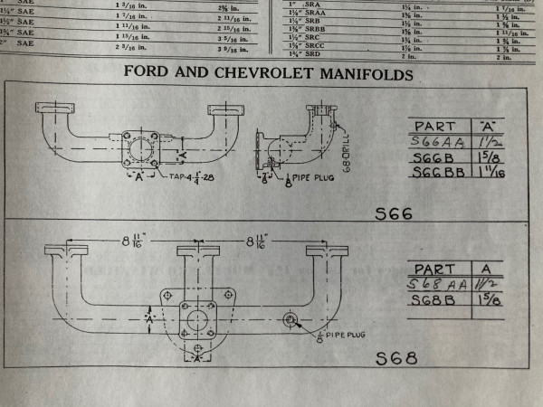

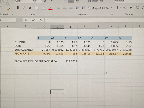

Kevin Pharis
Posts: 1659
First Name: Kevin
Last Name: Pharis
Location: Sacramento CA
Post by Kevin Pharis » Sat Oct 14, 2023 12:41 am
henryford2 wrote:
Fri Oct 13, 2023 7:30 pm
one last question any opinion on a Winfield S-BB on this engine. Have one on the shelf, but Winfield manifolds are hard to come by, although I do have an stromberg to winfield adapter. Thanks again
For reference, I calculate a BB at about 185 cfm using the “standard” 3” h2o depression. This was the largest of 3 sizes offered in the Winfield catalog for Model A engines. I currently run a S-B on a warmed up flathead in my touring car and used to run a SR-C on an arguably hot flathead in my speedster
