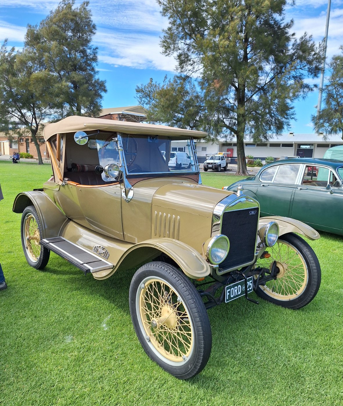

Ryan, my wide body Duncan and Fraser roadster sits at standard height, but has the steering column lowered and moved outboard as part of the body building process. This enables the body line to be lowered and the seat is also wide enough to take 3 slim adults.
There is a steel wedge between the frame and the lower steering bracket to accommodate the steering column height, and a thick wooden donut between the column base and the firewall to fill the gap created. This is a standard dealer/coachbuilder fitment.
The hole in the steel firewall is shifted approx 3/4" outwards and 1 1/2" down.
Hope this helps.
Hope this helps.
