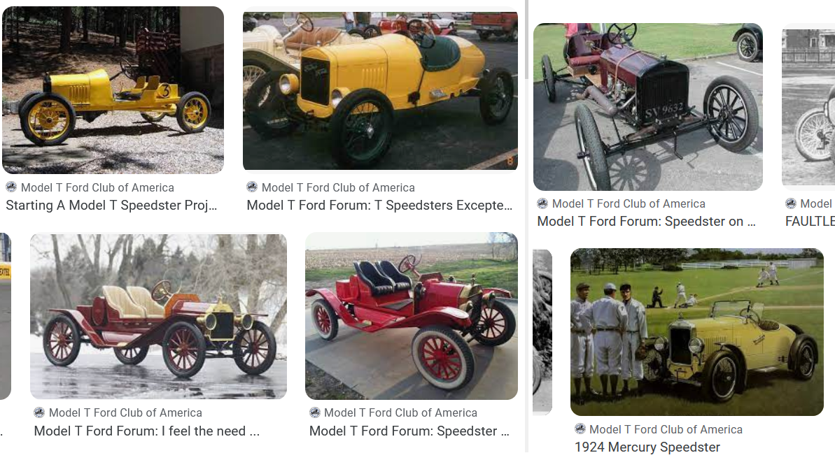

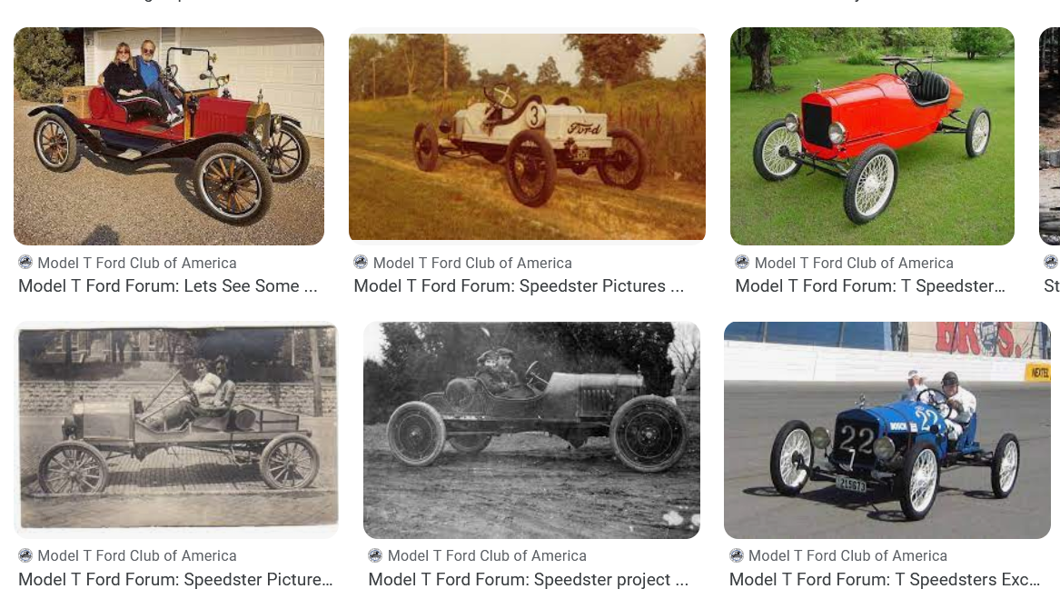

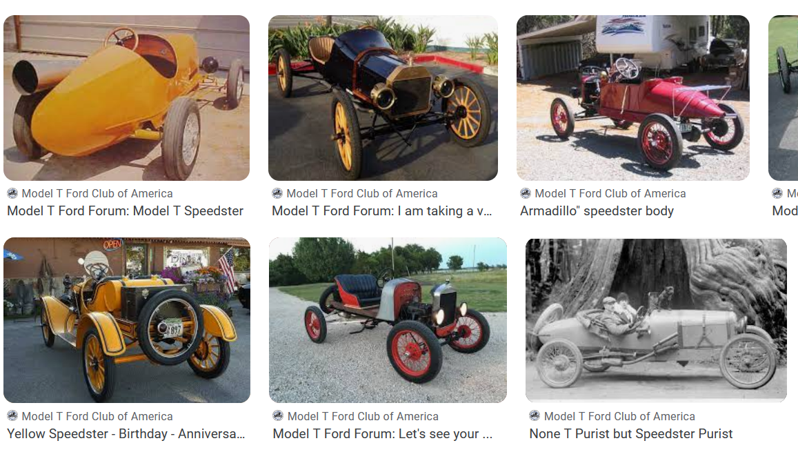

It may depend on your speedster style.
2 bucket seats, no body, fenders & brass - look mostly wood. No fenders, streamlined look - wire wheels
https://www.google.com/search?q=speedst ... AXoECAEQAw

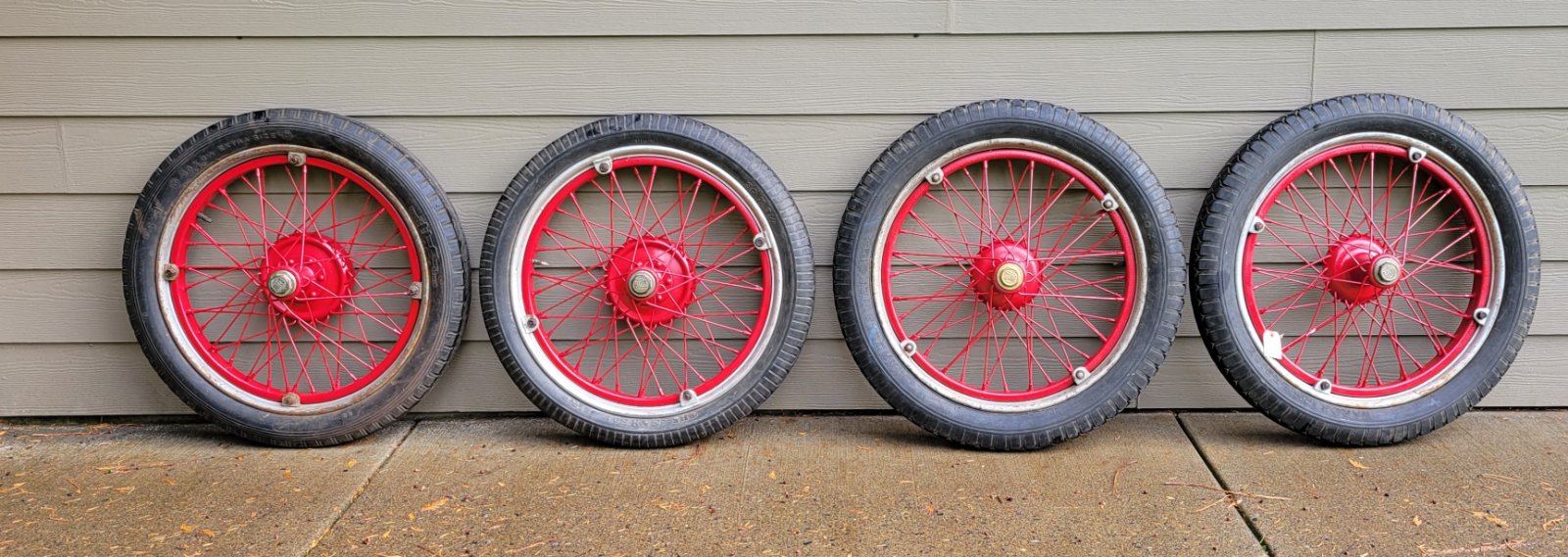

Post by KWTownsend » Fri Oct 13, 2023 3:17 pm
Dino,
I agree with Jerry.
I like the wire wheels, but a 21x4.4/5 wire wheel has too much tire for a brass era speedster.
There are lots of options out there. Pasco, Hayes, Buffalo, Bud...
These 30x3-1/2 Hayes demountables are surplus to my needs.
Let me know if you are interested...

Post by dinosbunny » Fri Oct 13, 2023 5:54 pm
Dino,
I agree with Jerry.
Let me know if you are interested... boy those are really nice

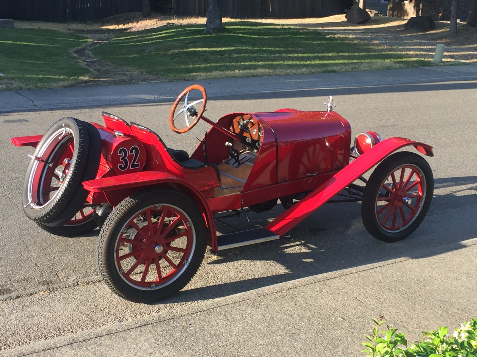

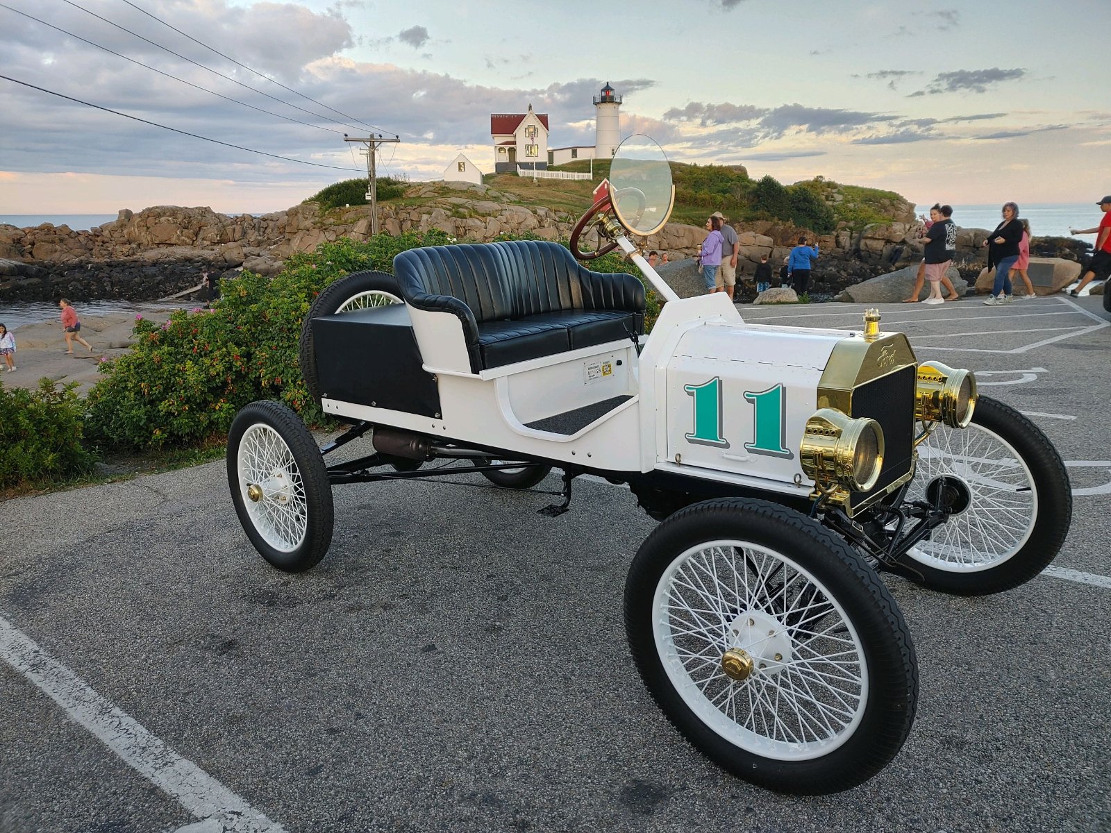

Post by jawa » Fri Oct 13, 2023 6:52 pm
McLarens are awesome!

Post by Norman Kling » Fri Oct 13, 2023 7:56 pm
They look fine and are perhaps stronger than the wood wheels, however, I hate to see someone use those on any car other than a 26-27, The original wire wheels were only used for two years and someone restoring a 26-27 can have a hard time finding a good set. Since it is a speedster, any wheels available during the T era is acceptable.

Post by havnfun » Fri Oct 13, 2023 8:37 pm
Adam, nice speedster, I like Cape Neddick Lighthouse in the background York Maine.

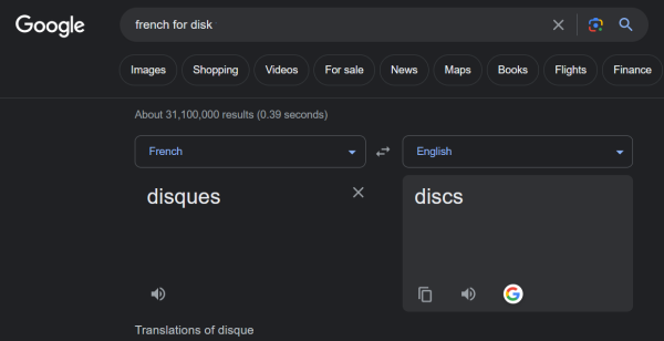

"Disqueals"
Posts: 6579
Re: which wheels?
Post by TRDxB2 » Sat Oct 14, 2023 1:54 am
TXGOAT2 wrote:
Fri Oct 13, 2023 9:16 pm
"Disqueals"
Didn't know you knew French :o
Need to update the spelling checker :lol:

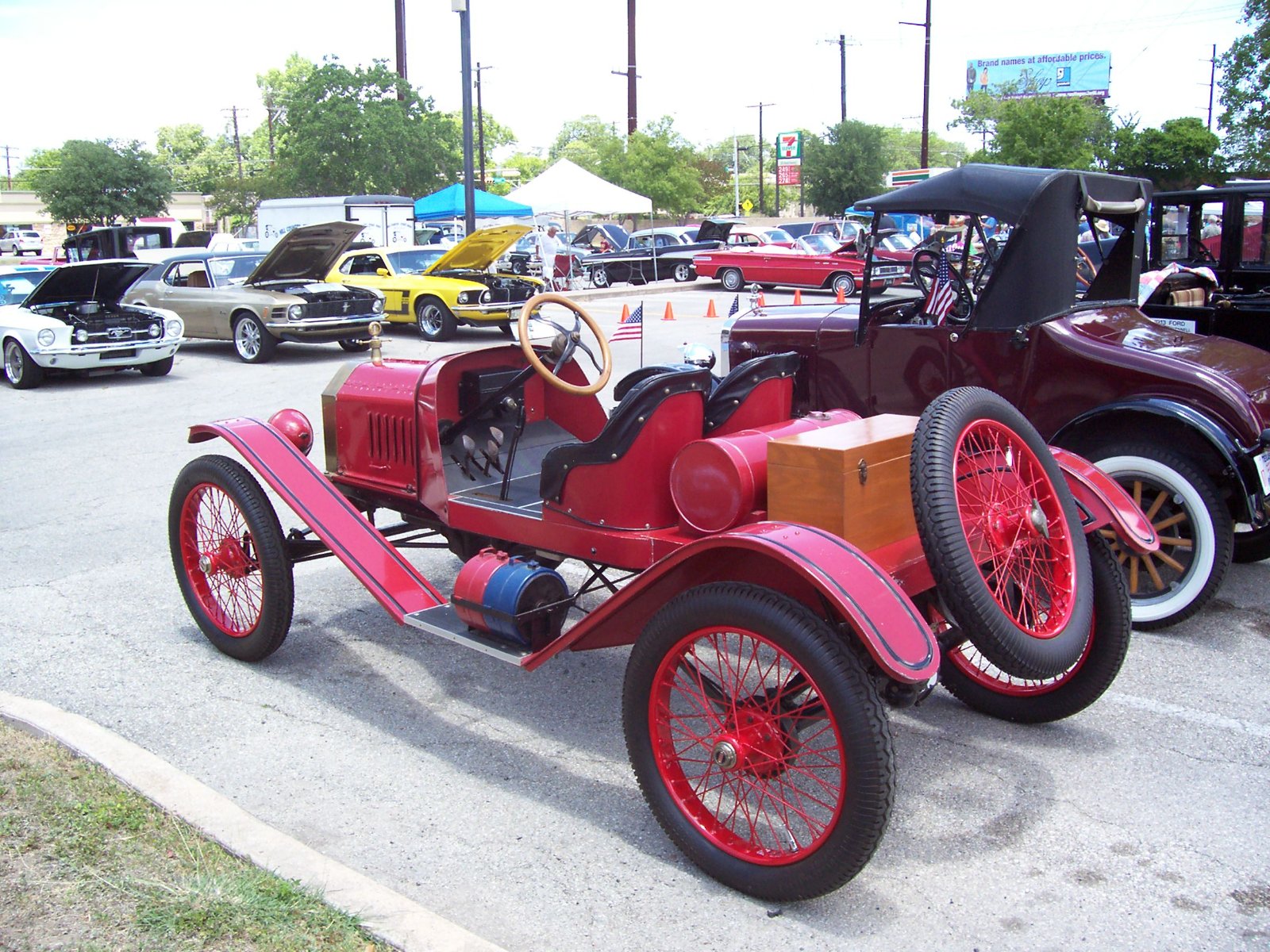

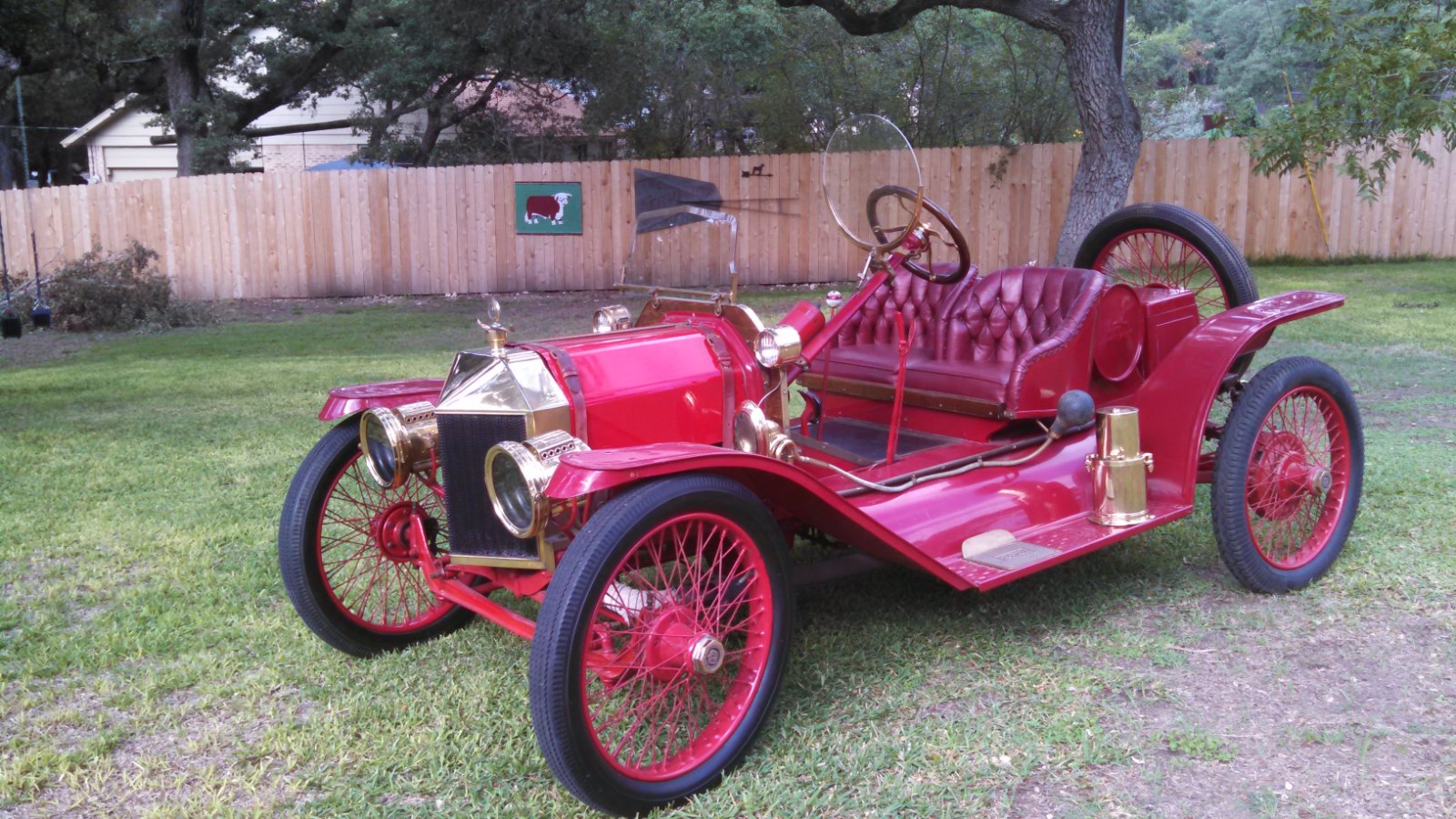

Post by ModelTSpeedster » Sat Oct 14, 2023 5:24 am
My preference is the period correct after market wire wheels or disc wheels. Unless the wood spoked wheels have been rebuilt, the original ones become brittle and the wood will shrink with age, making them unsafe.

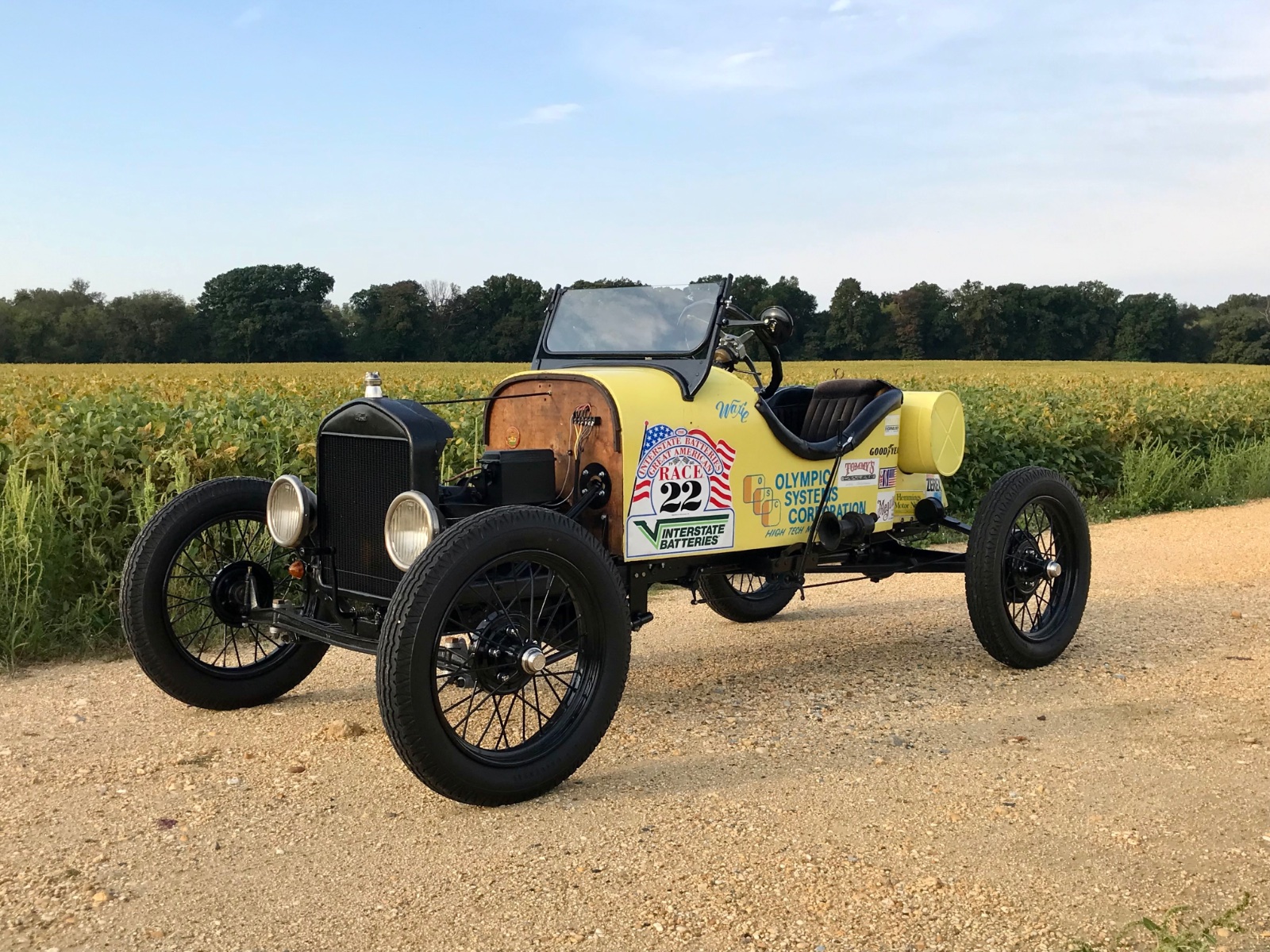

I like my speedsters fairly close to era correct! My 1913 speedster has the two sizes non-demountable round felloe wheels on it, wheels painted dark blue like an early 1913.
I did have one speedster a few years back that had 21 inch model A wire wheels on it. That was only because I bought a pile of model T parts that had a set of hubs made up for the model A wheels. One of the fronts needed repair, but otherwise they looked good. I had a speedster I was trying to put together quickly, and used them. I turned around and sold the car a bit later.
It was funny when I first read this thread, I got down to the group of photos of various speedsters, and my model A wire wheel car is in that group!

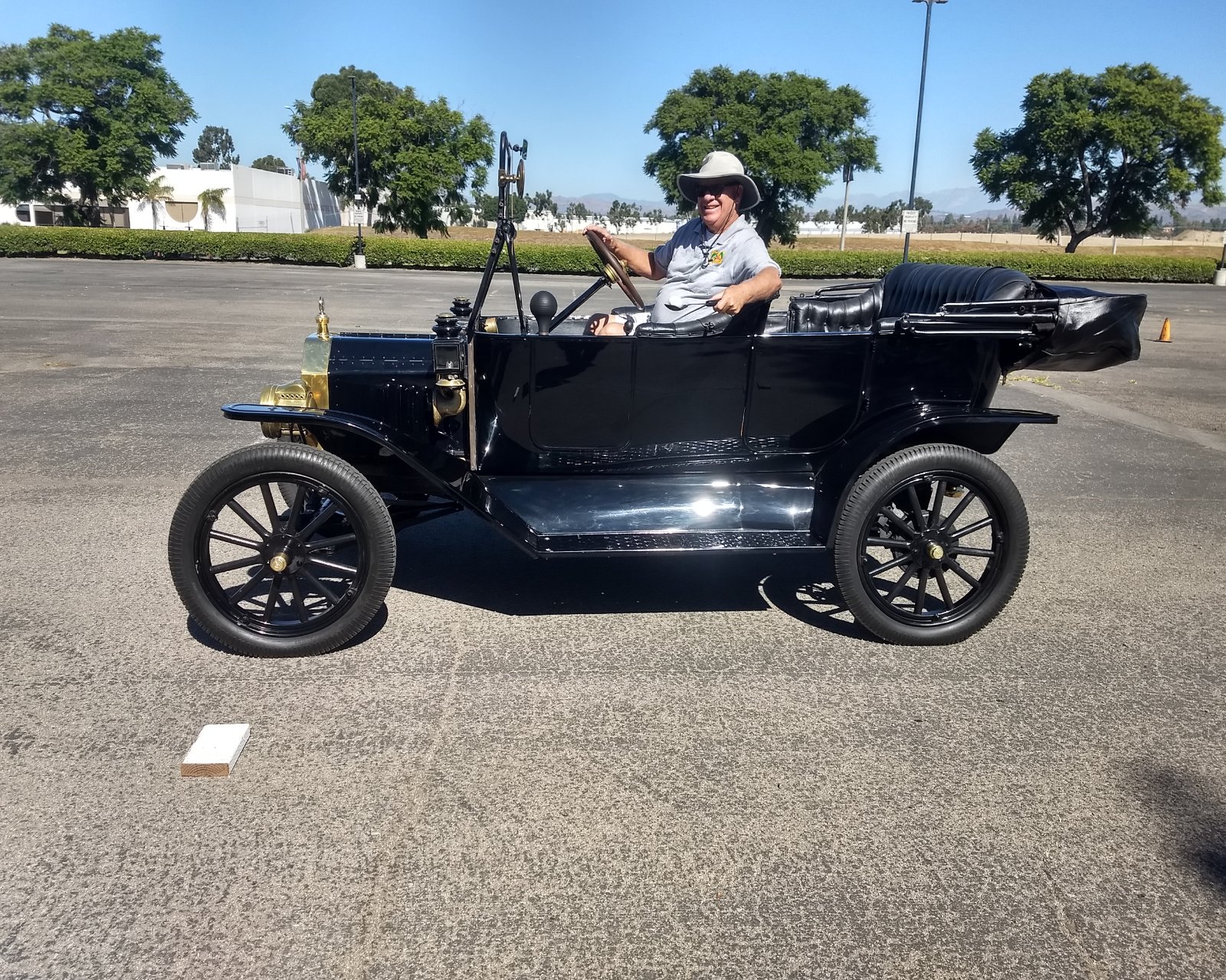

Post by speedytinc » Mon Oct 16, 2023 8:32 am
Given the binary choice you have, I suggested painting the demount-able rims black.
Here is a great example. @ 20 feet you barely notice the wheels are later incorrect to the car.
