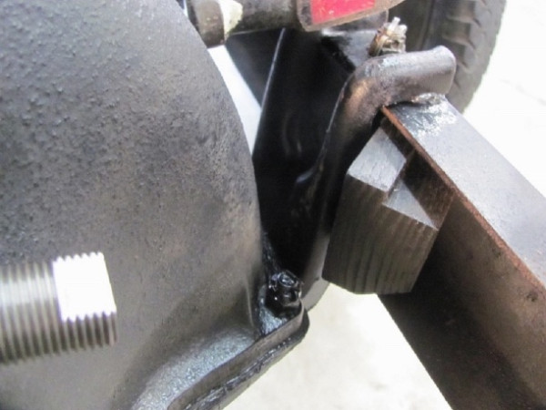

The attached picture is of the engine pan ear mounting on my 1924 unrestored TT C-cab truck, you can see the spring mounting. If you look closely you will also see a hook for a pan ear truss installed to "fix" a broken pan ear. It does not appear that the spring mounting corrected the problem causing pan ears to fail.
The 2 bolt and wood block mounting is still the preferred way. The horizontal bolt is not tight so yes essentially the work is being done by the top bolt, but does not mean the block and second bolt are not essential.
The engine mounting method with only one bolt and a spring per ear and without a wood block is in fact how the later TT chassis were done at the factory. And although the Ford factory came around to that improved mounting for truck chassis at least as late as 1924 and for subsequent production, it never changed the engine mounting for the car chassis. The original 1925 edition and the 1926 edition of the Ford Service Manual did not show a change to the car engine mounting, and the Ford Service Bulletins never recommend it as an upgrade or as an alternative to a car chassis for engine mounting. Tinkerin Tips is not a Ford publication, some ideas are good, some, well, are someone's best guess. I think Ford correctly addressed the pan ear problem in 1926 by adding the two transmission bolt bosses on the back of the block and adding steel struts directly to the pan ear, it not only strengthens the pan ear but stabilizes the transmission cover and the 4th main.

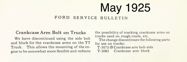

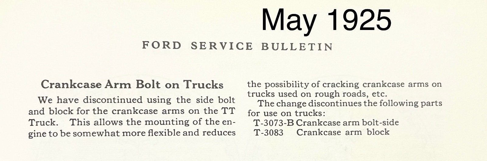

There is an engineering change in the Ford Service Bulletins about this subject. That is why all the Bulletins are important to have. There are many things in there found out guys that were trying to keep these things running back in the day.
- Posts: 4012
Re: Pan ear hardware?
That Engineering Change was to delete the wood block used on the TT, and the side bolt and nut. So only the longer, 1 1/16", TT (3074C) top bolt was used. There wasn't a spring part # noted with this engineering change. Can't believed that helped much, but do think 3 months later, the Improved block with the bolts to the block and the braces to the that top bolt on the pan ear rather helped!

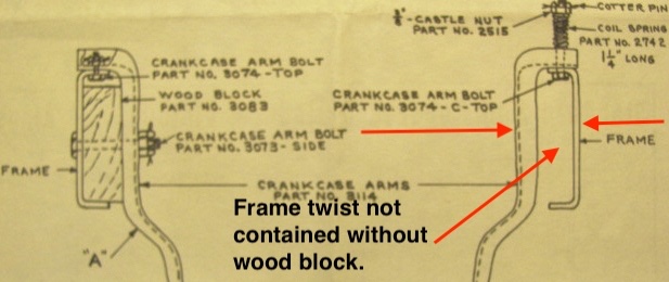

IMO, placing a spring under the top bolt, which is to be tight, and leaving out the wood block at the frame and pan ears risks fracture of the pan ear, and would contribute to more frame vibrations and movement of the powerplant, especially on braking and on frame twists over ditches and culverts.
Ford designed the 3 point suspension on the T, both front and rear axles and the motor, without the wood block, the motor 3 point suspension is compromised.

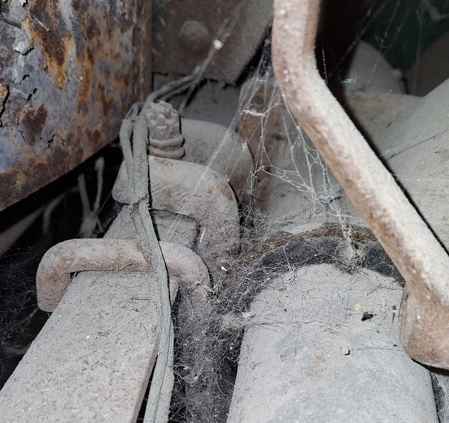

I have a '27 TT in the shop that has no side frame holes for that bolt !
